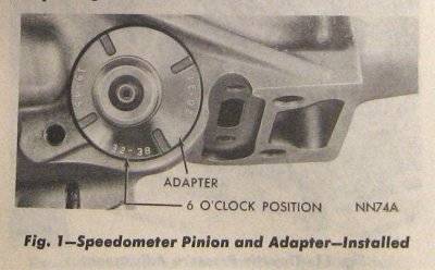

I'm one of those guys that has a bouncing speedo in my Challenger. I ordered and installed a new OER cable from classic industries. Before I put the cable in I lubed it like crazy with graphite. I also changed out the speedo gear in the transmission because the one that was in there was too small for 3.73 gears and I made sure to clock the pinion housing to the correct location for a 38 tooth gear. If I hook a drill up to the cable under the bottom of the car and run it counter clockwise the speedo sweeps nicely and holds steady, so I don't think it's a speedometer issue. It also feels like the speedo gear is engaged, because I can't spin it in the transmission either. Everything seems to be the way it's supposed to be, but when I actually drive the car the speedo bounces a bit and also doesn't go above 30mph.

When you changed the gear did you set the housing in the right range?
