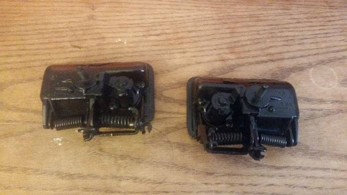

Dec 12, 2018 #4 M moparlee Well-Known Member Joined Jul 25, 2011 Messages 3,050 Reaction score 1,310 Location Mid Michigan I didn't have any pics of mine, but found one of these originals. Looks like the pawl is pointing to the mounting stud, if that's the one you are asking about.
Dec 12, 2018 #5 mmissile Well-Known Member Joined Dec 26, 2013 Messages 1,137 Reaction score 354 Location Macomb County Michigan That's what I'm looking for. Thank you.....at least I have something to go by. Merry Christmas....Mike.

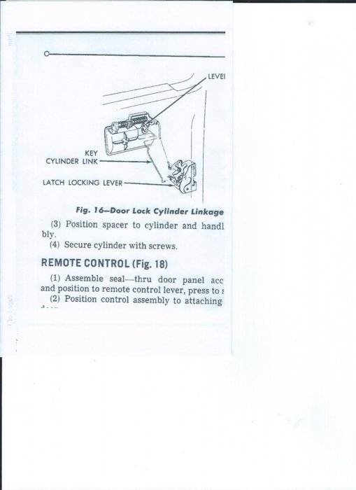

Dec 13, 2018 #7 rbbruno3 Well-Known Member Joined Jan 1, 2011 Messages 1,677 Reaction score 384 Location upstate , NY You probably have this figured out already but here’s a couple pictures.Points toward the front of the car
Dec 14, 2018 #8 mmissile Well-Known Member Joined Dec 26, 2013 Messages 1,137 Reaction score 354 Location Macomb County Michigan Thank you. Those shop manuals are decent, at best, when it comes to illustrations. I have all of them from 64-74.
