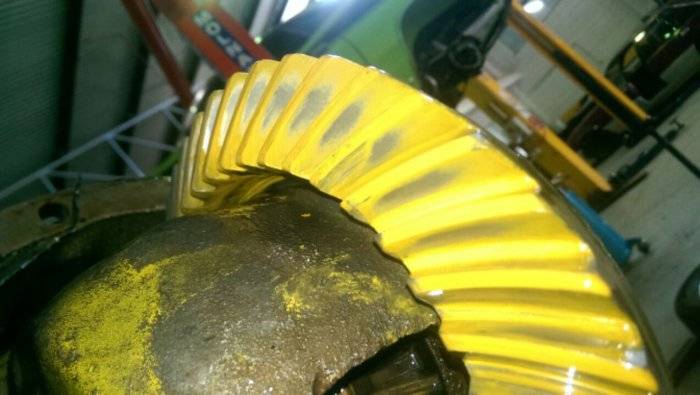

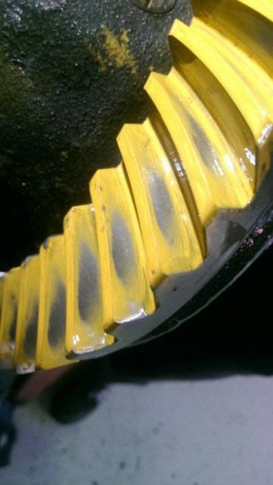

I believe the setup was correct, check the photos of the markings.

drive pattern looks good ,, but a little high (towards heel of tooth) try adding .003 to the pinion shim and take another pattern check --
--- what was the pinion bearing pre-load set at .
--- what was the backlash set to.

Could be the photo but the pattern looks a little odd. Not very uniform.

The pattern with a little load applied should be consistent.
