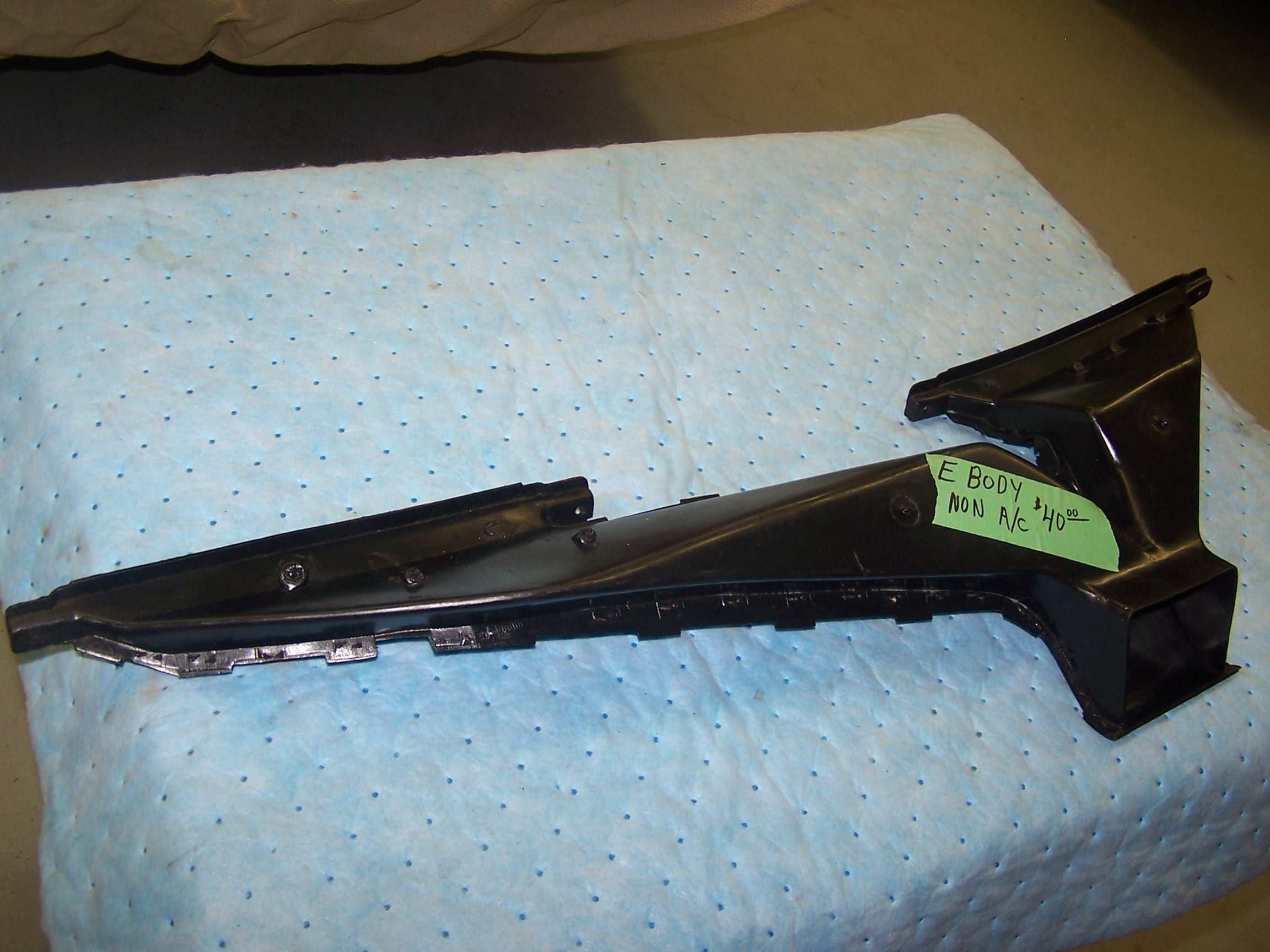

Can someone share a pic of a front window defogger duct and maybe a part number? I am not sure if its the same for A/C and non- A/C cars.

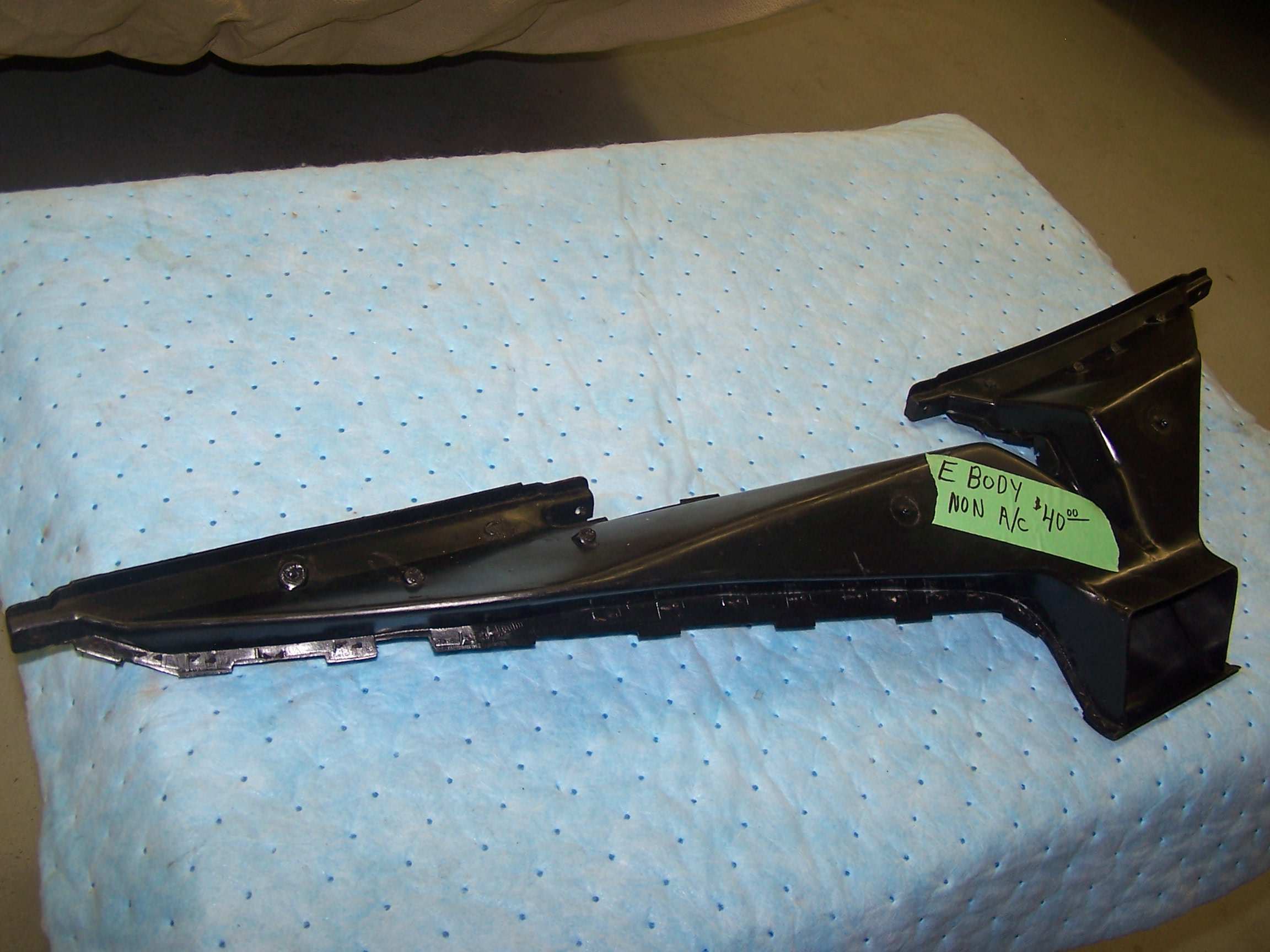

They are different. Here is a pic of a non AC duct I sold a while back but is the one you are searching for. PN: 2936641
70-74 E body all used the same part.
