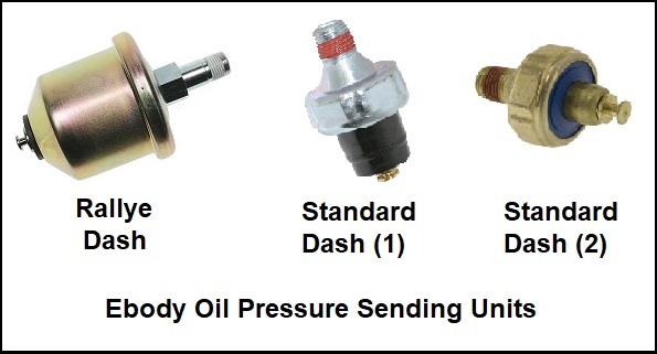

I did a Standard OEM dash to Rallye OEM dash conversion on a 1970 Barracuda and had to change the oil pressure gauge too. I don't know if that's required with A Dakota Digital cluster.
