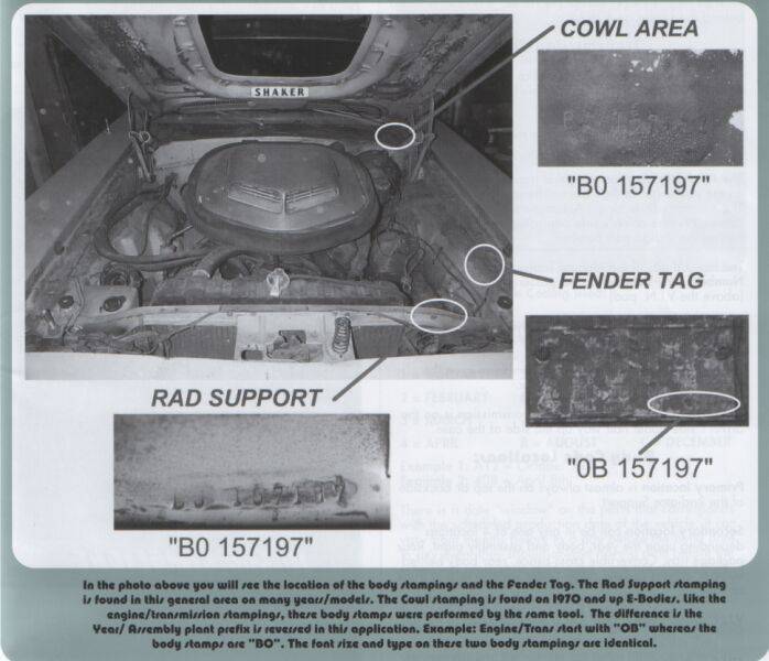

To make the car concours that is always the case. I think he just wants a nice looking car. Which may mean new paint, carpet, upholstry kit, etc. You can do a lot of this yourself. A numbers matching car is more desirable and more valuable because it still has the original factory marked parts. Unless you plan on hammering the original motor I would leave the car the way it is and bring the car up to the condition you want it to be. Here is a pic of where you will find the body numbers. The engine has part of the VIN on the block in the front just below the head on the drivers side. The transmission will have the numbers on a pad on the right side. Post some pics of the car.

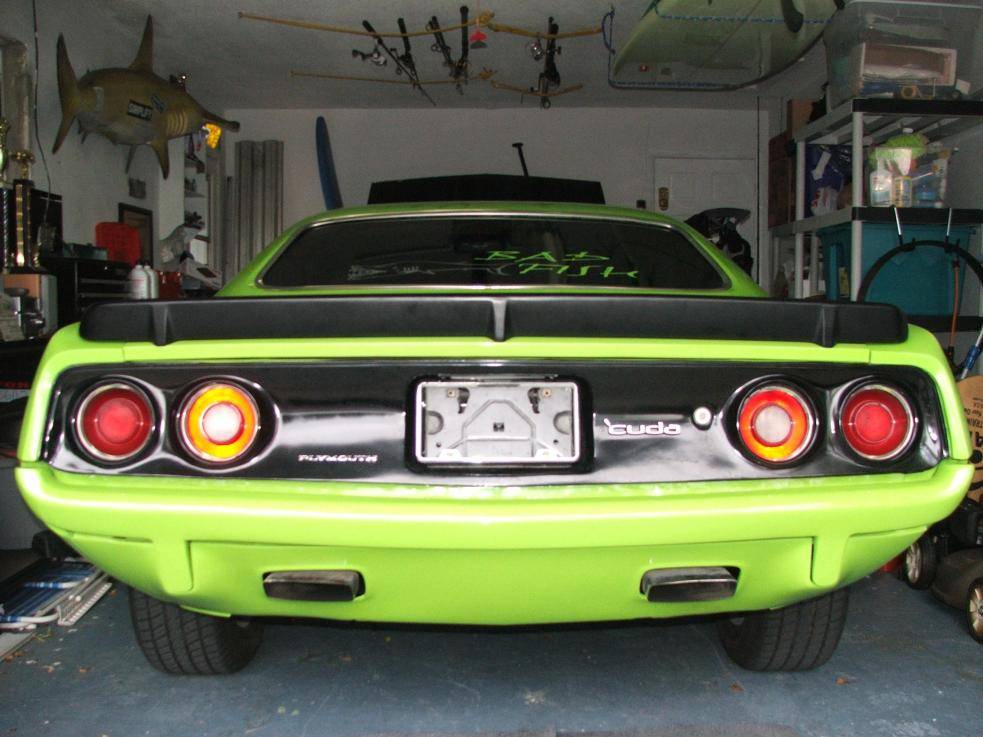

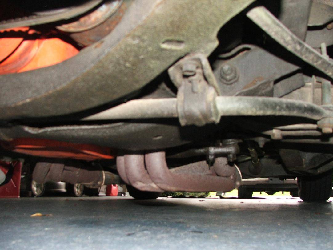

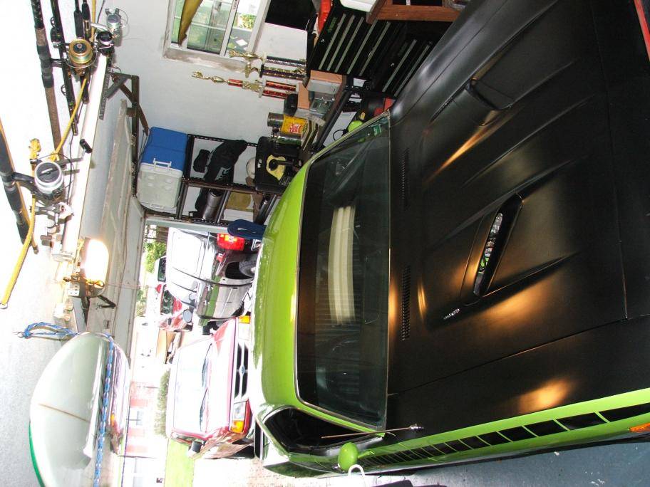

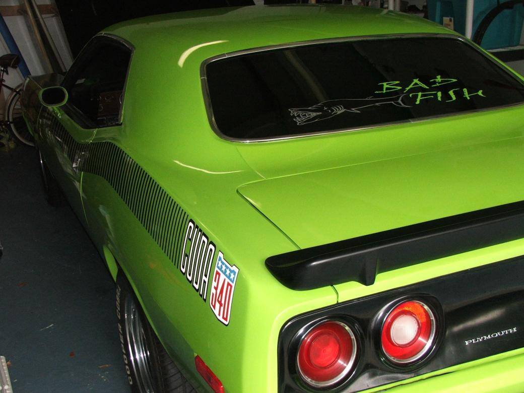

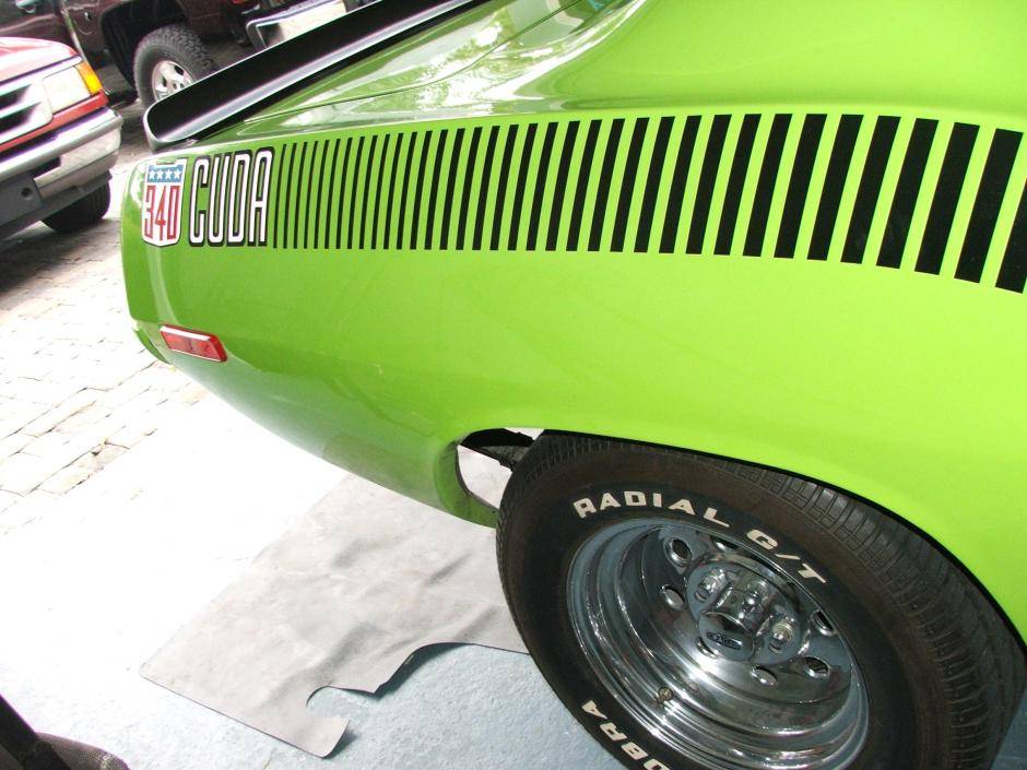

Thanks guys, yeah I'm not looking to have a show car. I just want to keep it looking good and running great. Here are some pics. The vin says it should be white with blue interrior...dont think I have the coin to change it back. I like the AAR tribute look anyways
challenger6pak
Feb 27, 2011
4,070
917
Looks real good. Do you know where the water came into the trunk?
MIKESonMOPAR
Oct 22, 2011
15
yeah, looks as though the trunk seal is not working. I noticed that a tiny bit of water was leaking at the bottom of the rear window and from the trunk seal when I gave it a wash after the drive home. What could make the seal not stop the water?
