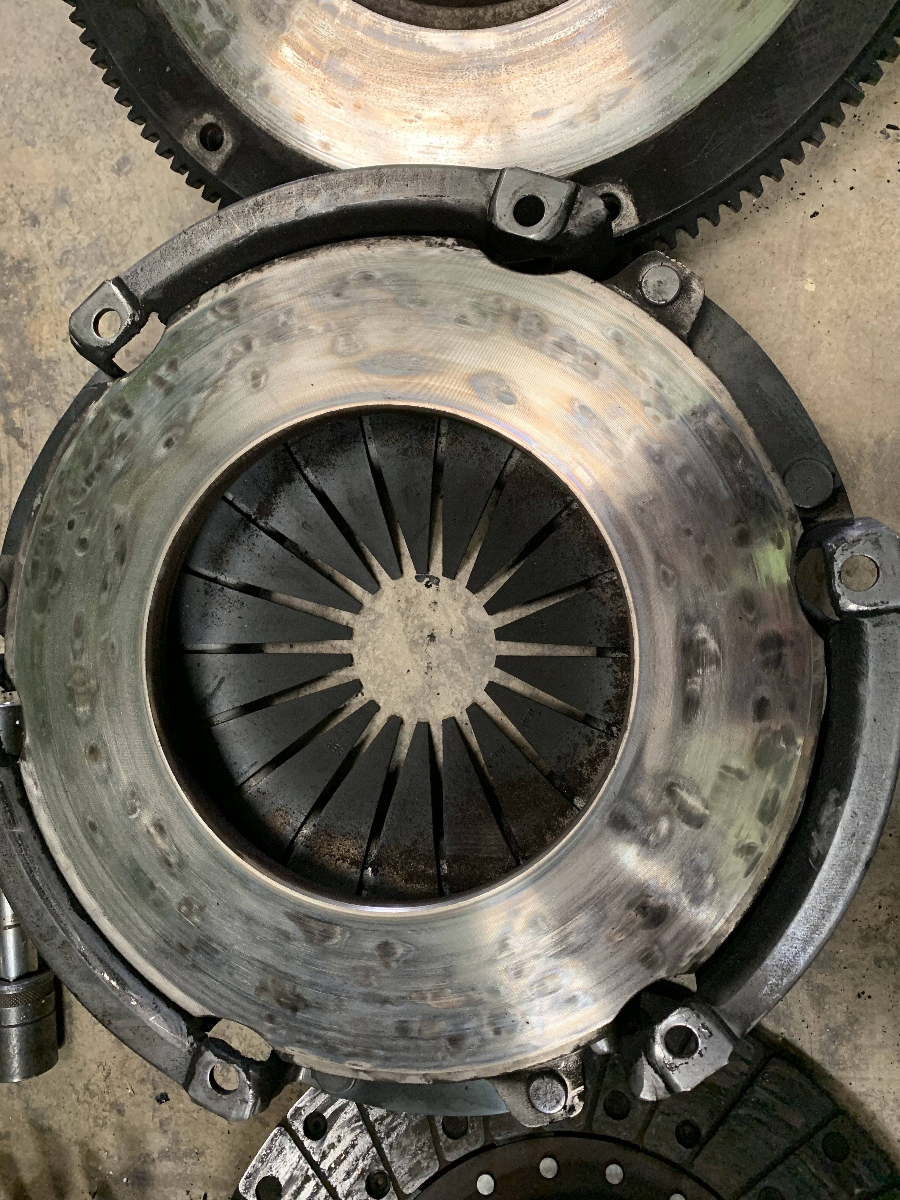

photo of oil on trans & pressureplate

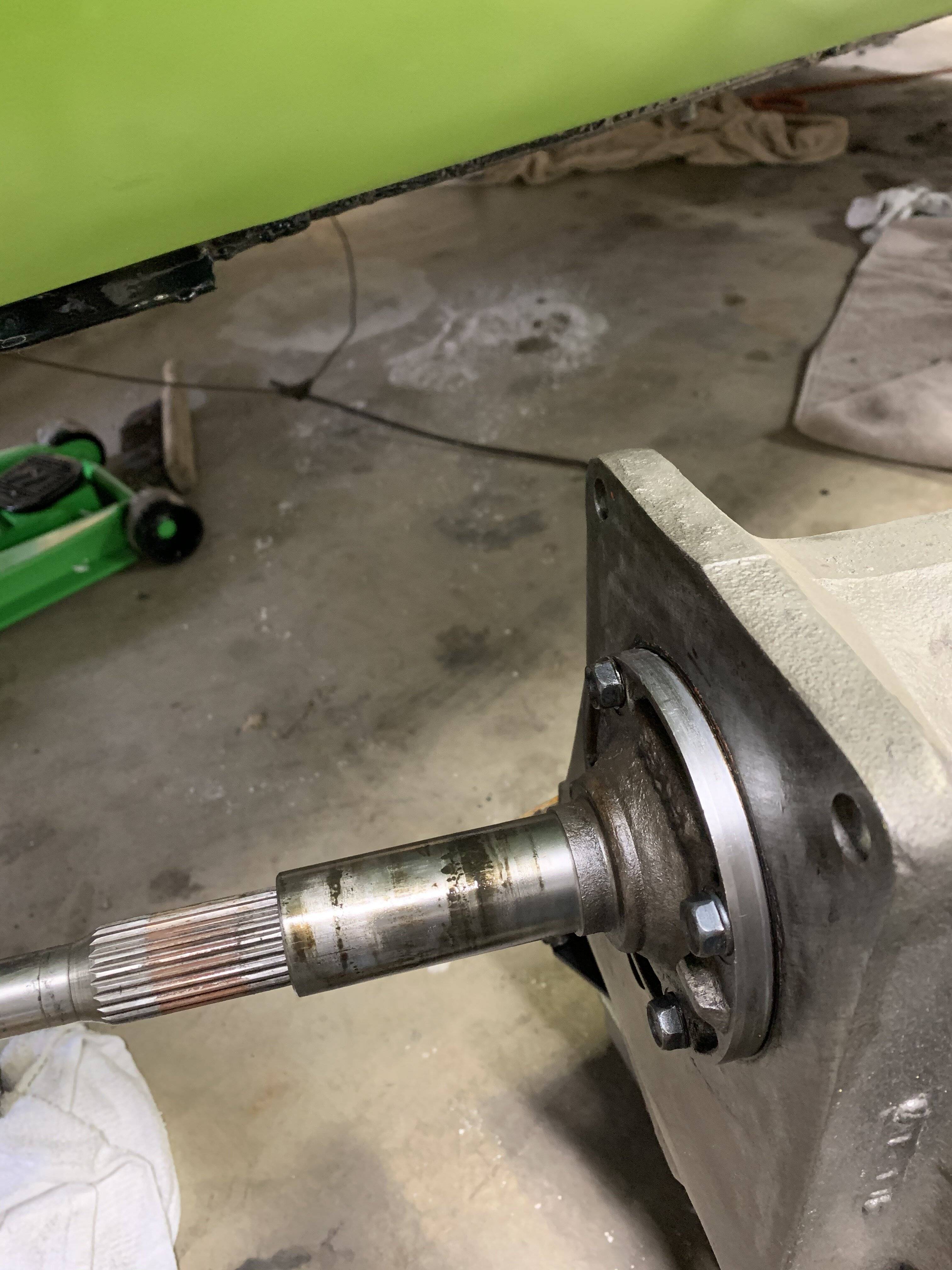

very light oil at where the main meets the oil pan. most or the oil splatter on the bell housing is on the clutch side of the flywheel . is it possible for oil to leak out the nose of the tranny behind the splines?

It is. There should be a seal behind the retainer sleeve. I would replace just because you’re already there.

As you know, time for a pressure plate, disc, t/o bearing etc, I would have the flywheel machined as it appears to have hot spots. If you see any hairline cracks, then replace the flywheel. The rear main is easily accessible while everything is apart. Just good insurance

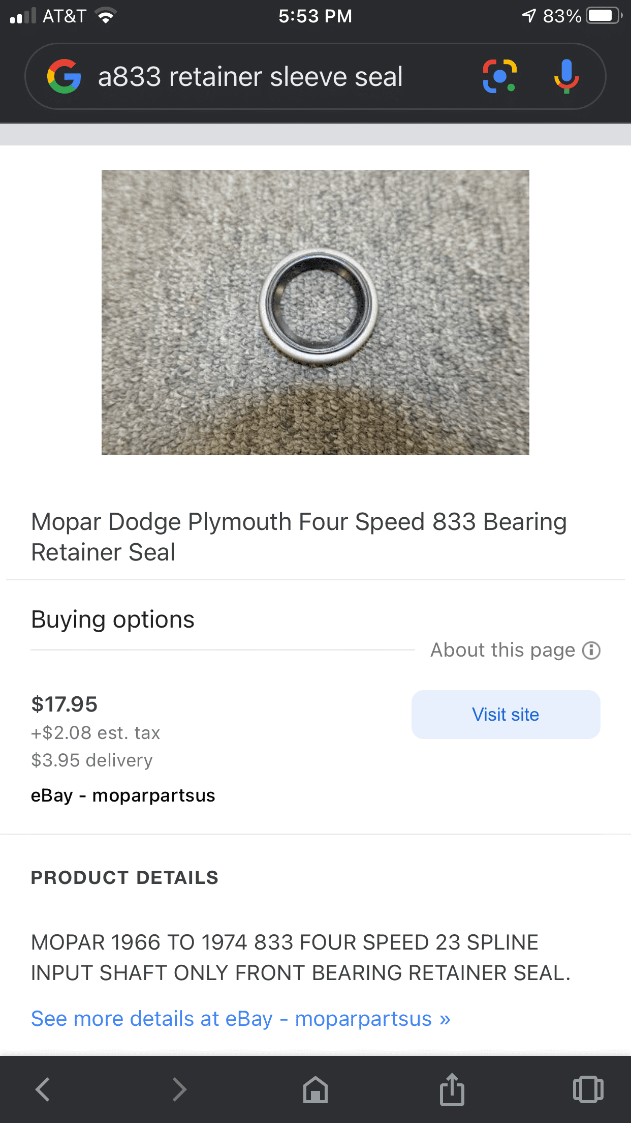

You can do it. It’s in the back of the sleeve.
Check the end play of the input bearing. It it’s extreme, it could be time for tranny work. Did you hear any excessive bearing noise while driving?

I would suggest downloading the factory repair manual. It’s free at mymopar.com
Good to have if you don’t have a hard copy on hand.

I am not sure what you have for an engine in front of the trans but that diaphragm clutch is not doing its job at all , it has been slipping a lot to have heat spots everywhere like that !
Really you need a new unit & might be able to save the flywheel depending on crack depth etc . I have had far better success with 3 finger clutches , I usually buy from McLeod as this is the factory style & the pressure can be controlled better using various amounts & pressure coil springs , they even have street twins if you have a 512 stroker with massive tq output for example .

Do the front trans seal yourself , it is easy to change just remove the 4 bolts & slide the retainer off & change the seal , make sure you use a sealant on the bolts when you put them back in so no oil seeps through the treads .

Make absolutely sure you install the seal in the correct direction.
