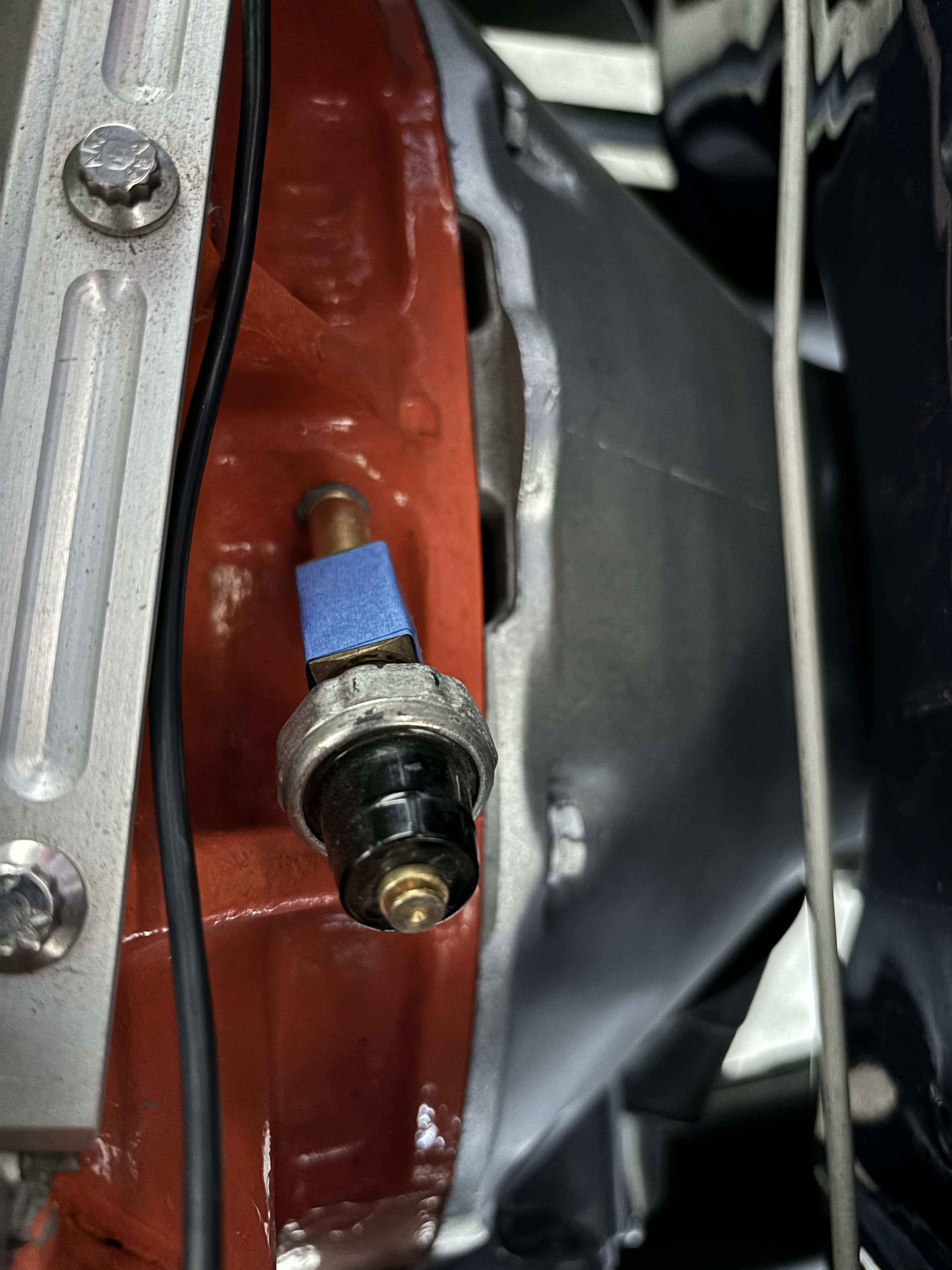

What are you all using to make this connection? I can’t keep my wire attached. I bent it a bit hoping to tighten the connection up, but it si still not staying on. Are ther any other oil pressure sending units out there with a better connection to the wire?

The one posted by @Xcudame should work. Many did not have the plastic connector.

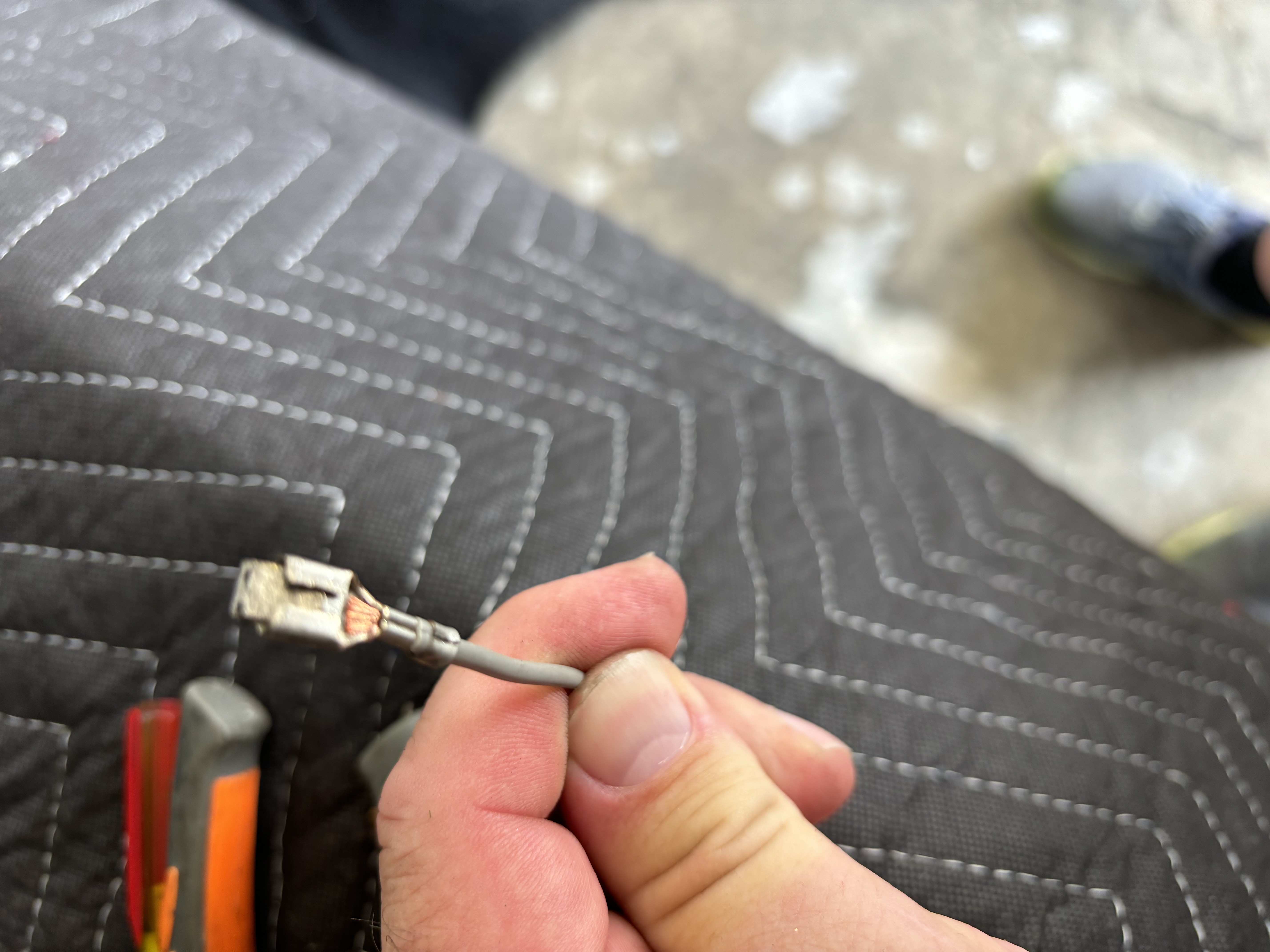

Simply slide on the brass terminal after crimping it to your wire. Use a good set of crimpers, not the $3 cheapos.
