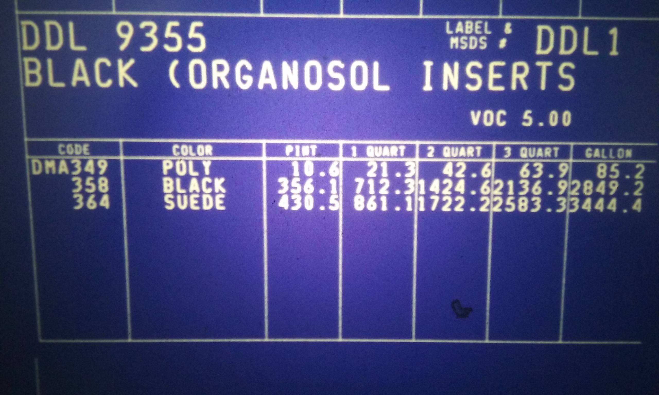

There is no flake in the mix . The 349 is a poly found in most mixes.I have to research that.The suede gives it the finsh and texture. 431 is a fine poly. 433 medium poly. 635 course poly. I need to reference the toner list when I find it. 300s are lacquer 400s are enamel.600sDBU.
I see, I’m open to try it, with what’s available these days to get it close. Thanks I’m following here…
