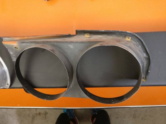

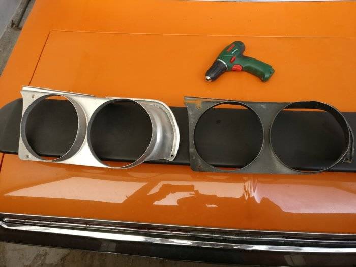

Have two pairs of front light bezels. One seems to be new the other one is way older. None of them show any numbers on it.
Are both repops?

The headlight bezels look to be original.

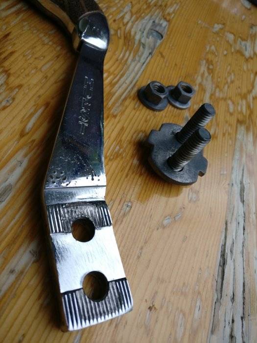

Another part would be that Hurst pistol grip.
No numbers again besides on the plate.

The bolt-on pistol grip came out in 71 (I think). Hurst just stamped 4 digit numbers on their stuff. You probably have a Competition Plus shifter.

The headlight bezel on the left is correct as for the paint lines. The one on the right has been painted or powder coated without being masked off properly. Can't really tell if it is a re-pop or original but I have had both and while the re-popped ones I had, looked good, they did not fit as well as the originals.

Thank you for your replies so far guys.
@sixpactogo i cant really tell if one of the two bezels fits better than the other.
I think both are good.
I think the right one could be the original one and was badly painted at one point - Like you say.

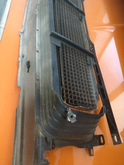

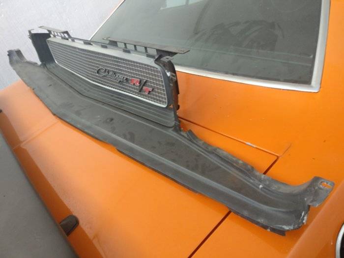

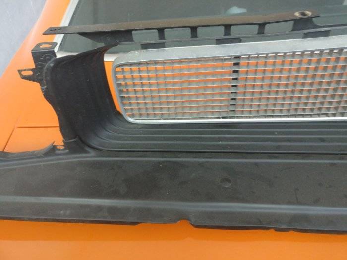

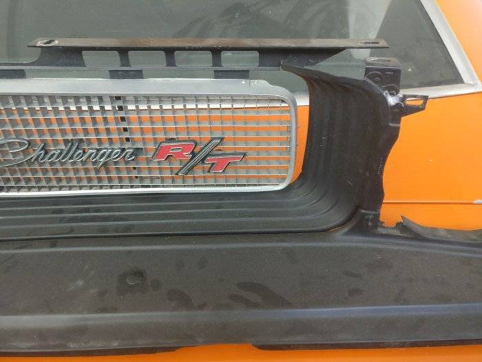

I made some pictures of the second grille today. Not sure but it appears too new to me to be original.
I hope i made at least one usefull photo.
quapman
878
227
That grille looks original and has been re-painted (incorrectly) once.

I think that explaines the older incorrect painted light bezels too. It seems someone wanted to get the grille a darker look back then.
