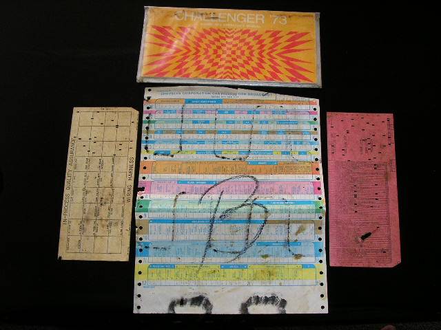

We still have the owners manual and found some paperwork under the rear seat. The broadcast sheet is unforunatly NOT the one for this car. The sheet I found is for a 340 4-speed Cuda. The quality controle cards DO appear to be from the Challenger though.

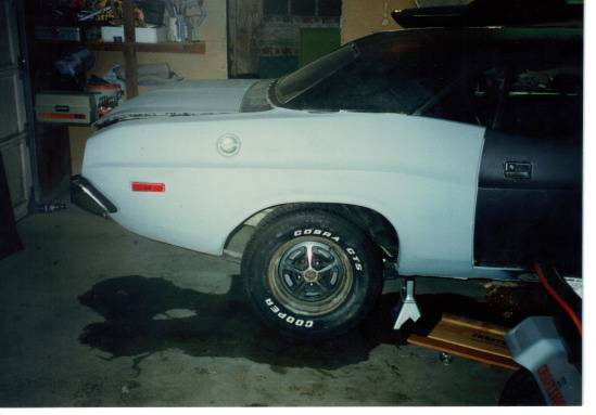

In the mid 90's ,while I was in High School, we got the car on the road again. The exhaust as replaced and the brakes were gone through. The back end was sagging badly so extra leaves were added in the rear to get the hight up a few inches. The carb was rebuilt and new white letter tires were installed. I put about 3000 miles on the car before it went to the bodyshop for the first time in 95. The car now shows 96,000 miles.

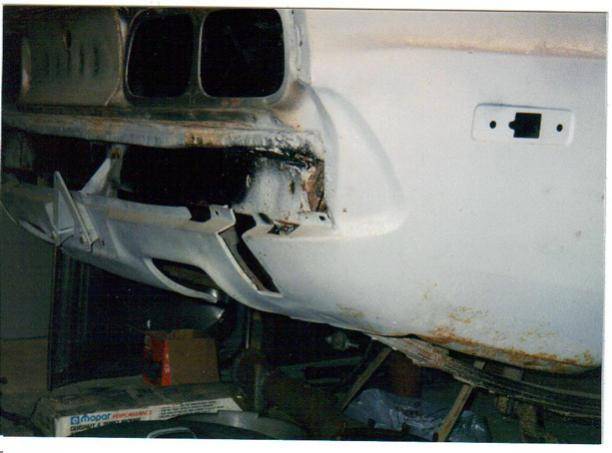

Long Iowa winters had taken there tole on the body. It was easy to see that the quarters were junk as well as the front fenders. The car had been repainted at least once in its lifetime and it looked as if there was a good deal of bondo in the trunk lid as well. It didn't sit flush with the quarters.
In 95 I went around to a few bodyshops to get some estimates on body work. The few shops I went to basically just laughed at me and said they weren't interested. I found a shop that was willing to put quarters on the car and fix some rust in the trunk. It was only after the car was at the shop that I found out they did really bad work. What was supposed to be a 3 month job turned out to be 2 years. When I got the car back, I understood what everyone was talking about.
There was bondo everywhere. A lot of the rust was just bondoed over and it was up to a half inch in places. The quarters were hung very poorly and the rust in the rocker area wasn't addressed before hand. I wasn't even told that there was rust in that area. The used rear valance I had purchased for the car had some minor damage that would need fixing. The valance was just tack welded to the quarters and the seam was bondoed over. Big steel plates were slapped onto the sides of the frame instead of being fixed and large sheet metal patches were placed on the trunk floor and tacked in place. Everything that the shop did would have to be replaced. Here's some pics of there work.

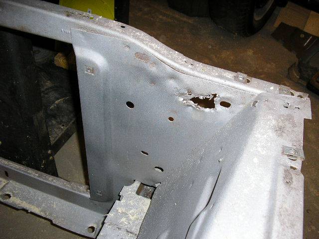

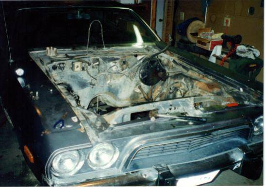

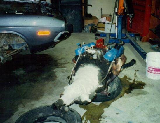

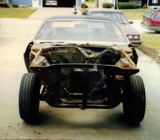

I started taking the car appart in 1998. The engine/trans was pulled first and set aside. With them out of the way you could really see the extent of the rust on the inner fenders.
I'd like to say that I labled and bagged all of the nut/bolts and screws so I know exactly where they all go but I didn't. Putting this thing back together is going to be a challenge.
Here are a couple pics of the engine and what the engine compartment looked like.

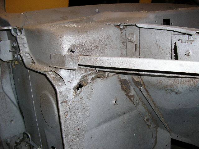

The front fenders came off next. There wasn't a whole lot left of them. They were being held together with filler. The car had to have looked pretty bad when it went in for a repaint in the late 70's because a lot of filler was used at that time.

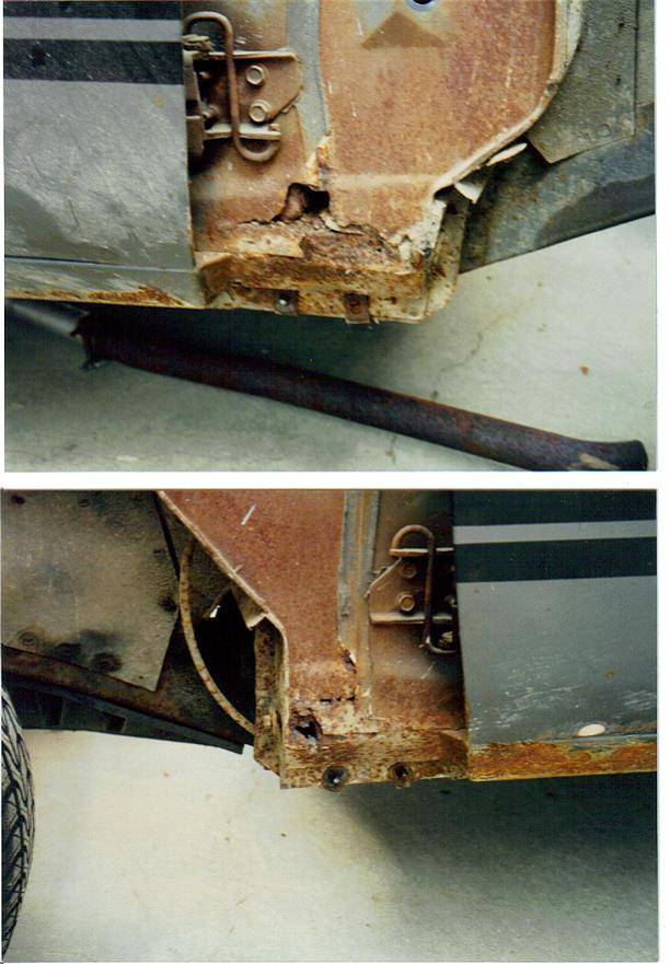

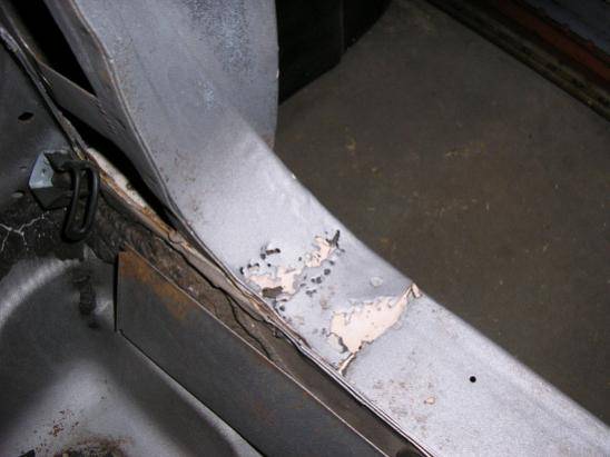

I was pretty dissapointed in what I saw once the fenders were off. The rockers were in horrible shape. I have been going to the Mopar Nats every year since 95 and finally found a pair of complete rockers in 06 so I bought them.

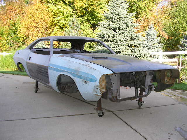

In October 2007, the car went to the blasters. I was pretty happy when it returned. There were no surprises. Don't get me wrong...the car needed a lot of work but all the parts that I thought were still good...were still good.

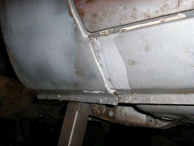

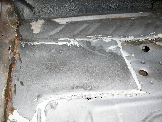

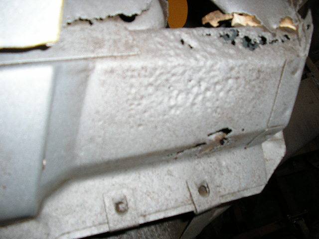

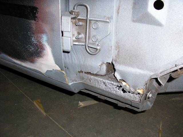

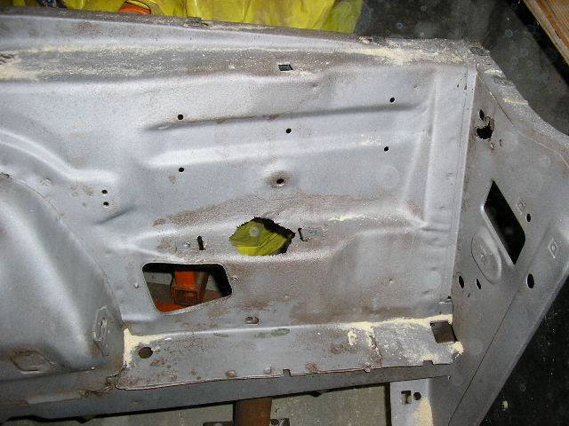

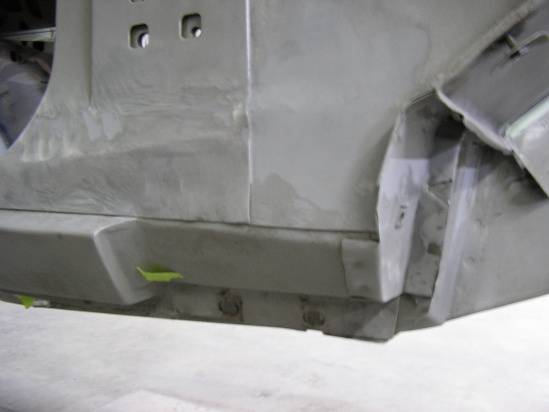

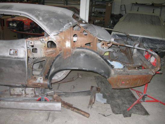

Here are a few pics of when the car came back from blasting. In one pic you can see how bad the quarter panels were installed by the first shop the car was taken to. You can also see the rust holes in the rocker that were just filled with bondo.
The center part of the trunk floor was in great shape. It was too bad that the first shop had to butcher the sides. I was sure that the entire trunk floor would then have to be replaced. That didn't turn out to be the case though.

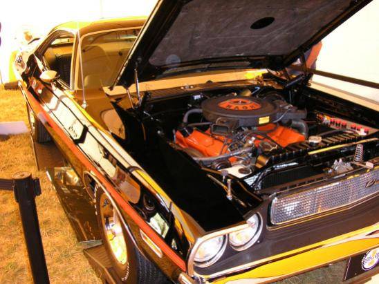

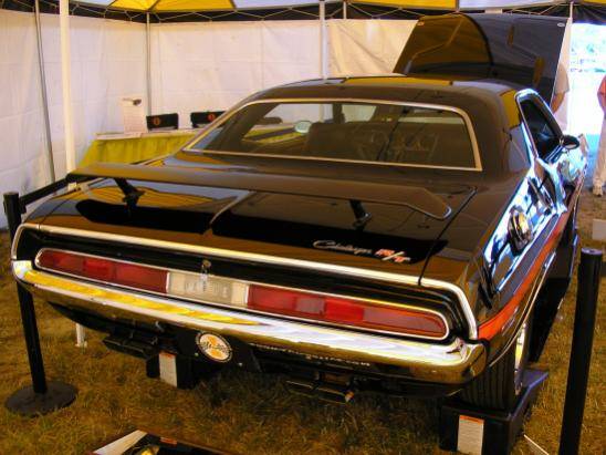

Here is a few pictures of the 70 R/T that was being worked on at the old shop here in Iowa. This car was taken to Ohio and was finished there. These pics aren't very good since they were taken inside a tent, but you still can see what great work they did on it.

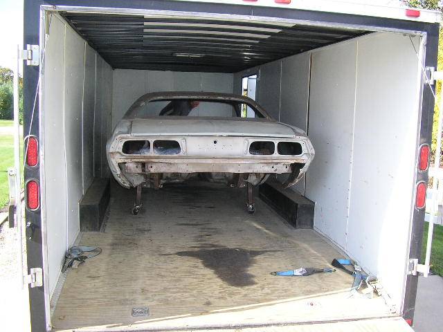

On October 14th 2008, the car left for Best of Show Automotive in Ohio.

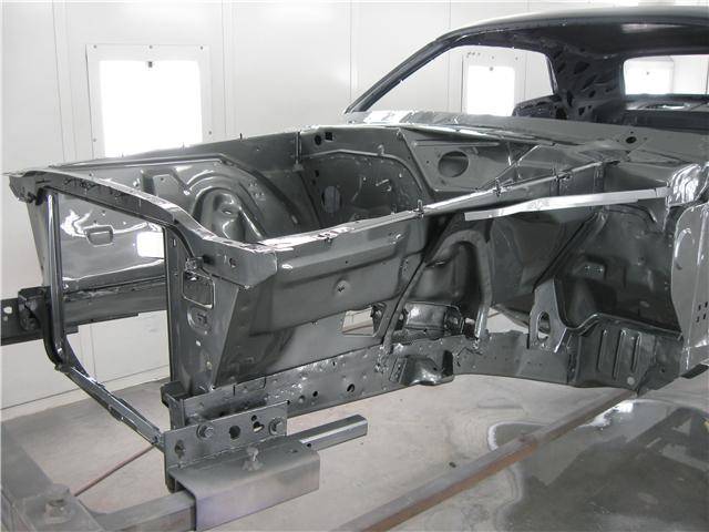

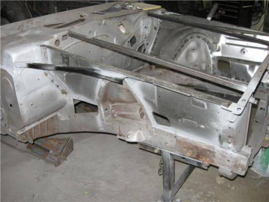

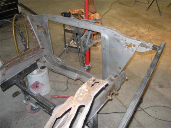

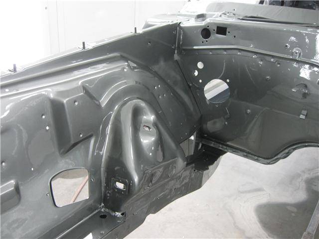

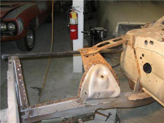

Well, the work really started at the begining of the year. They they started with the inner fenders. You can see the bracing that was installed when the old inners were cut out. The also fixed the radiator support and the firewall area. The two inner fender braces were also replaced due to rot.
The rockers were next. I found a pair of complete rockers at the Mopar Nats a few years back. They used the entire drivers side rocker that I supplied but only needed the front section of the passengers side. That was the part of the car that gave me the most worries. It didn't seem to be a problem for them. I guess it pays to take the car to people who really know what they are doing.

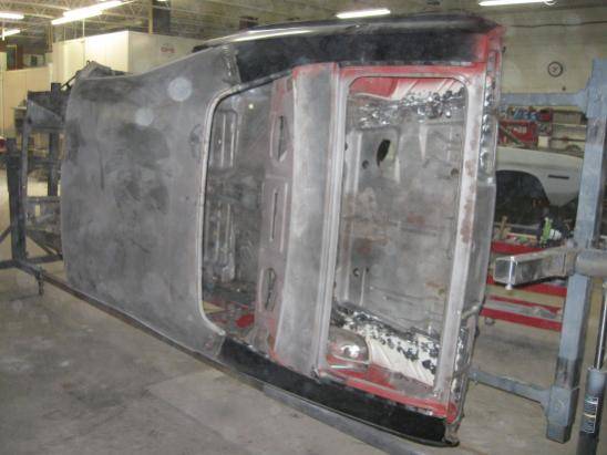

After the rockers were done, the back half of the car was started. The quarter skins that had been previously installed were cut off and full quarters were installed.
While the quarters were being fitted, the trunk floor got some attention. Instead of replacing the entire floor, the sides were replaced using and old 2-piece trunk pan. The center of the trunk is origonal with the spot welds on the fuel tank braces. The new sections were spliced in ontop of the framerails were the rear shackles mount.

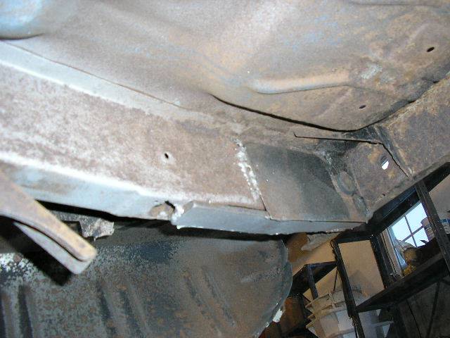

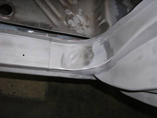

New framerail sections were installed in the rear that I purchased from The Paddock. The seam between the old and new frame was metal finished and you can't even tell there was a repair done. A new filler panel(the part that the rear bumper bolts to) was also installed.

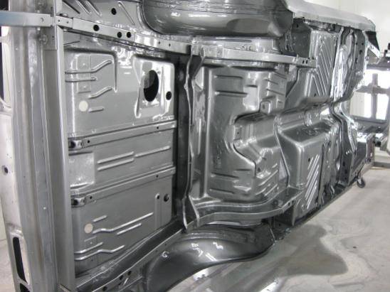

Here you can see the new frame rail sections in place. The torsion bar x-member needed work too. It was pretty rusted at the ends where it met the rockers. A new drivers side front floorpan was also installed due to some pitting.

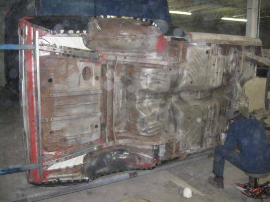

At this point the car was able to be put on the roticerie. It was then taken to the media blasters and the underside was cleaned up for paint. You can see in the last picture that the seam sealer has been applied.

When I was out there I ok'd a test sample of the body color. A few weeks later, the engine compartment, trunk and entire underneith side were painted. It's really starting to look good. Here are some pics.
