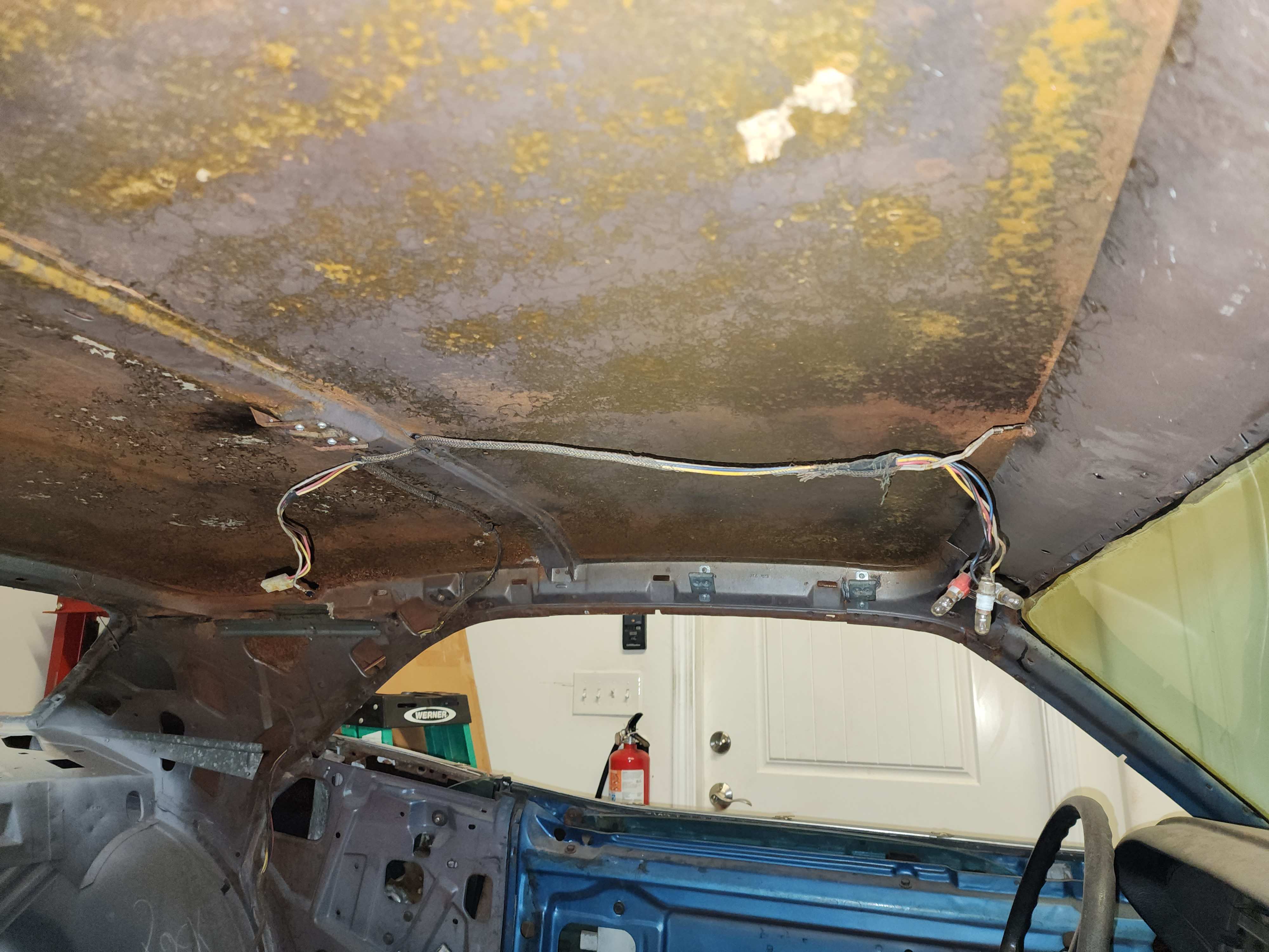

I am looking for some help in connecting my overhead consollette. I routed the main harness through the left rear pillar, but am at a loss where the connectors connect.
Does anyone have a clear picture of how it is routed and where it connects to on the car? About ready to install the headliner and consolette but want the wiring to be complete.

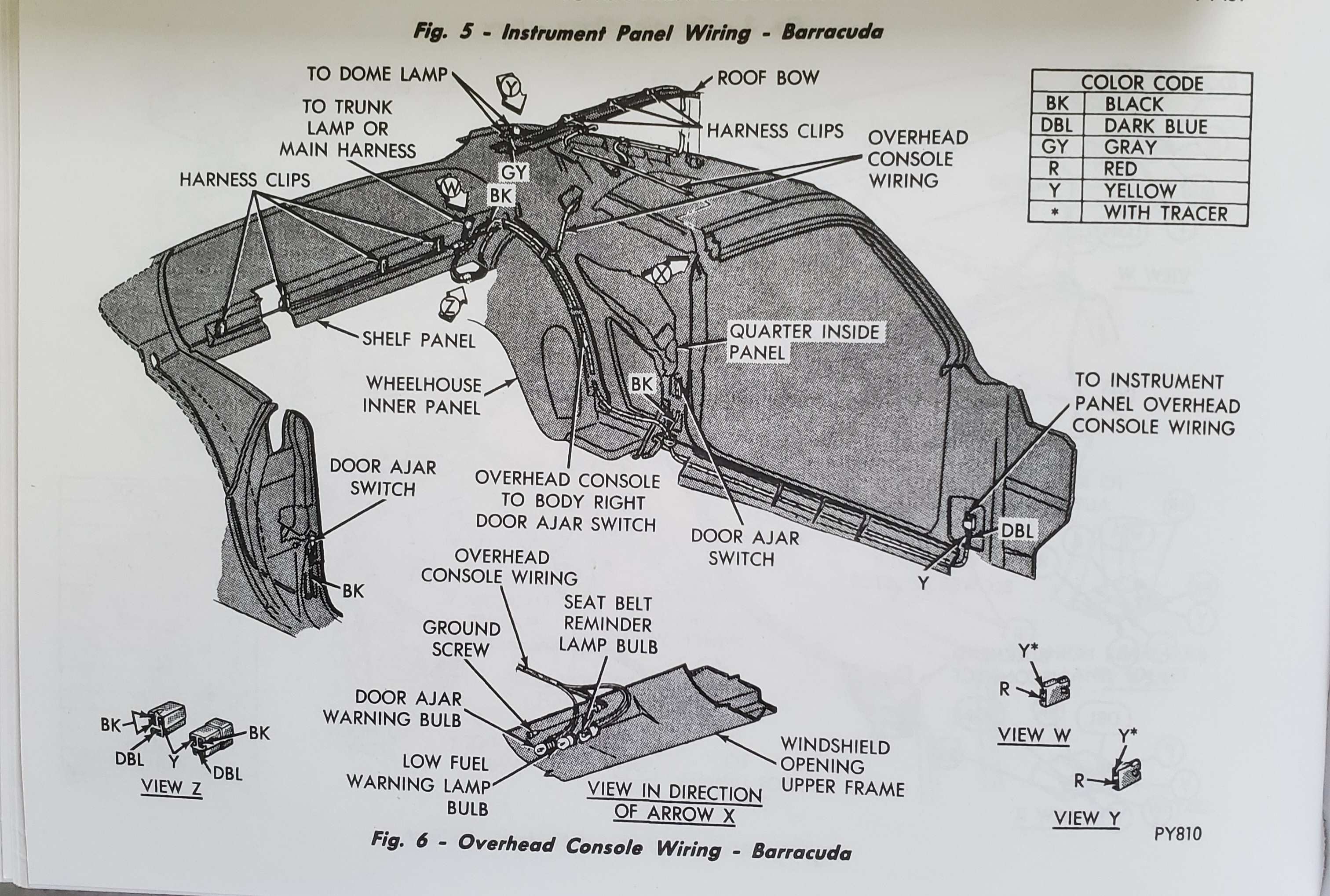

It's not the best, but here's what's in the shop manual.

Thank you for the photo. I took mine apart so long ago I don't recall how it goes back together.
