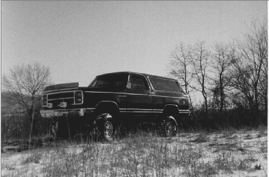

I had a (Miss it) Ramcharger steer box worked on by an older guy that showed me how to do it. I sure do miss those older guys that did know everything! The one thing he said is that I should upgrade to a 3/4 ton type box with 36" tires. In the picture there are 34's on it so I could get it in the garage.

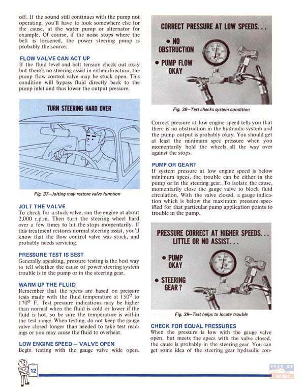

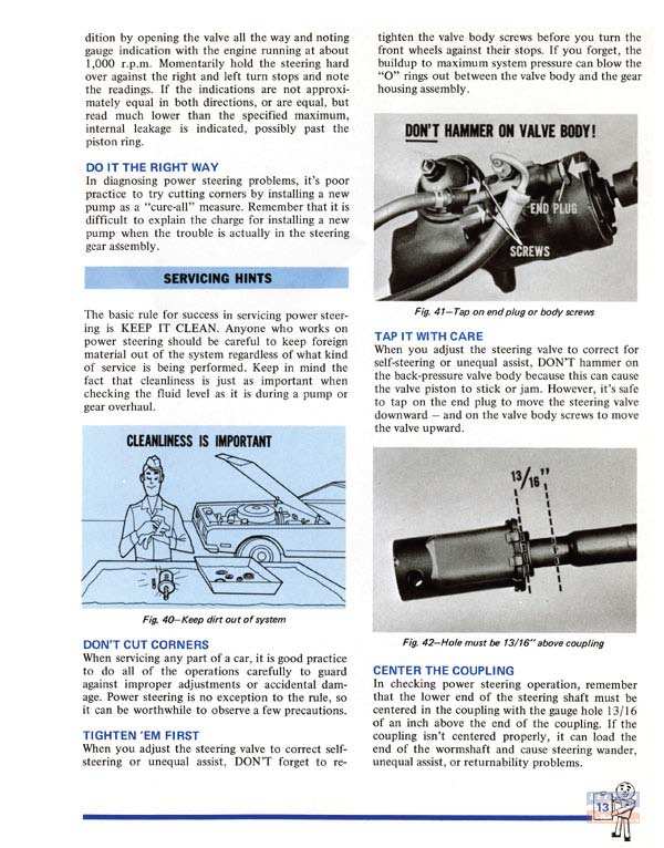

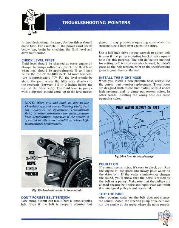

The Master Tech Reference Book 70-10 POWER STEERING FUNDAMENTALS with pages 11-13 on troubleshooting pointers.
