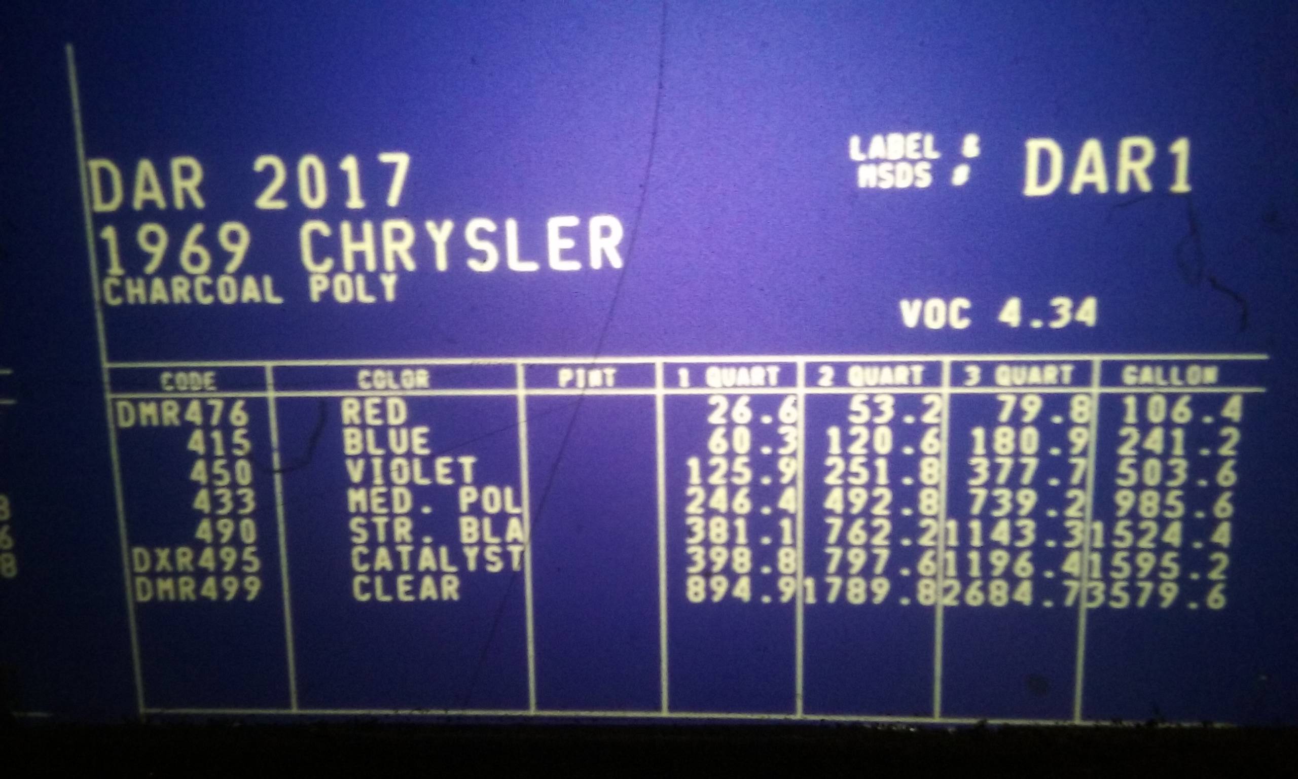

PAINT 1 1972 DAR Acrylic Enamel
2017 CHARCOAL POLY A9

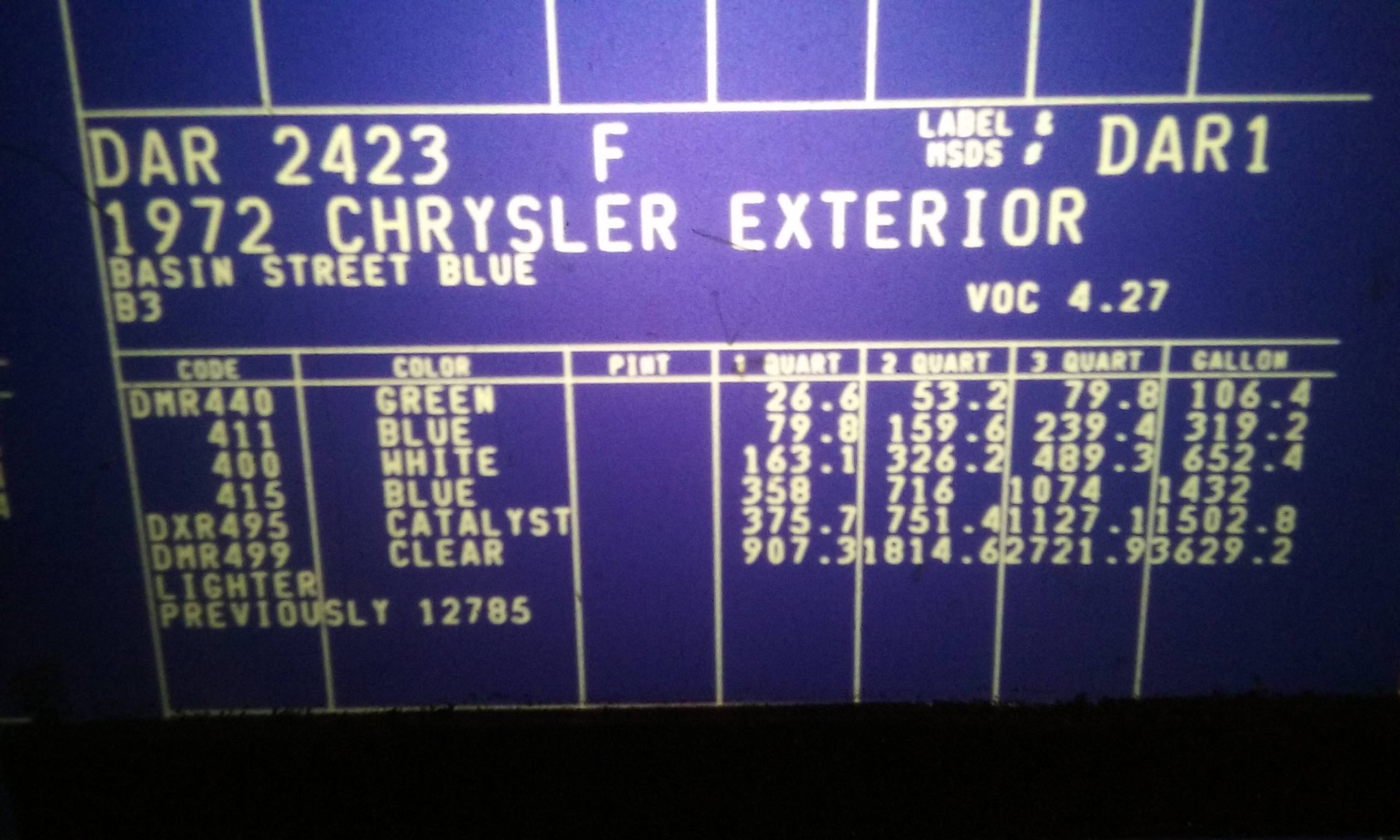

2423 BASIN STREET BLUE B3

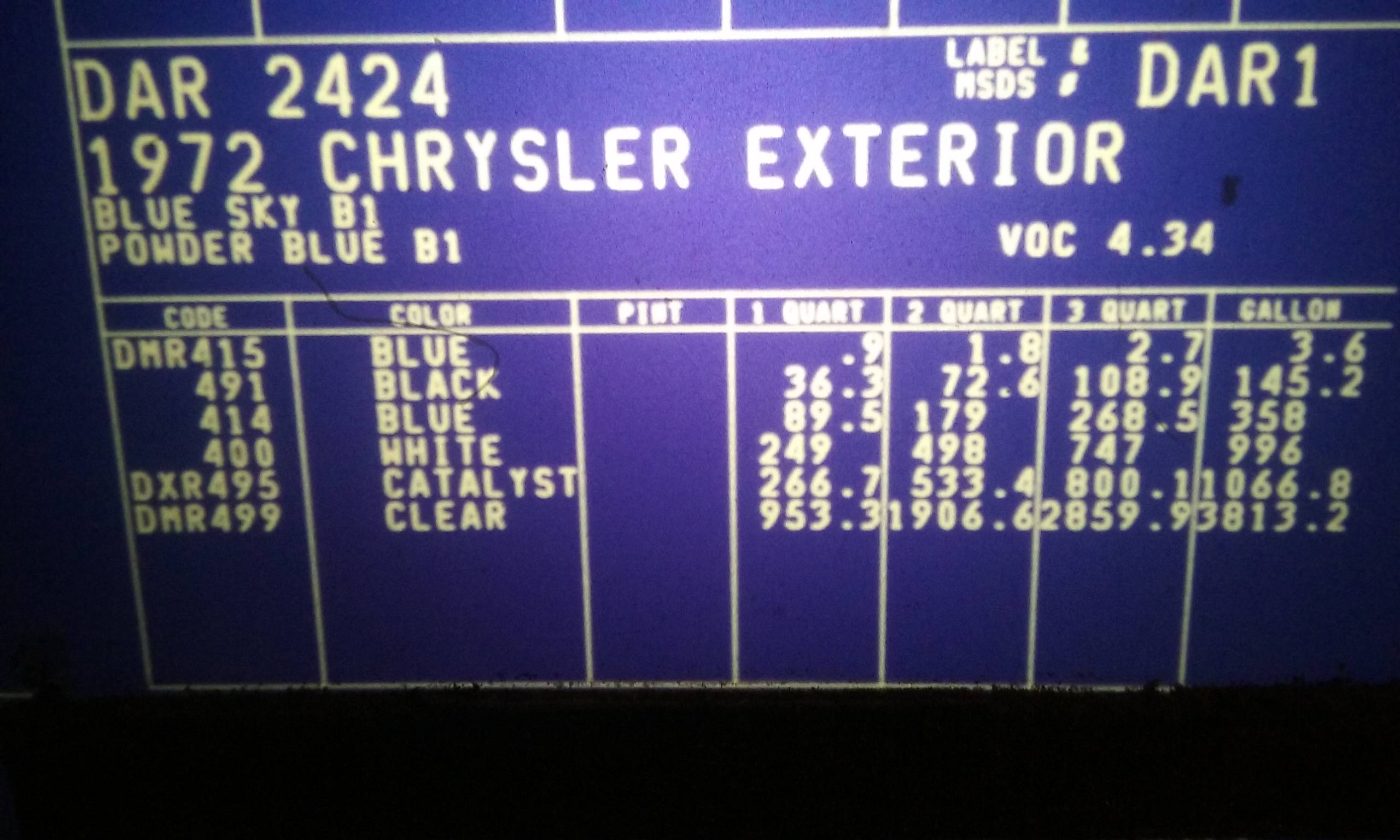

2424 BLUE SKY POLY B1

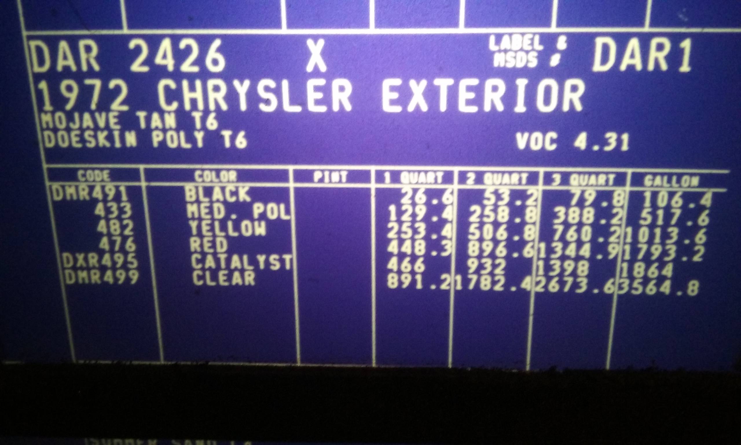

2426 DOESKIN POLY T6

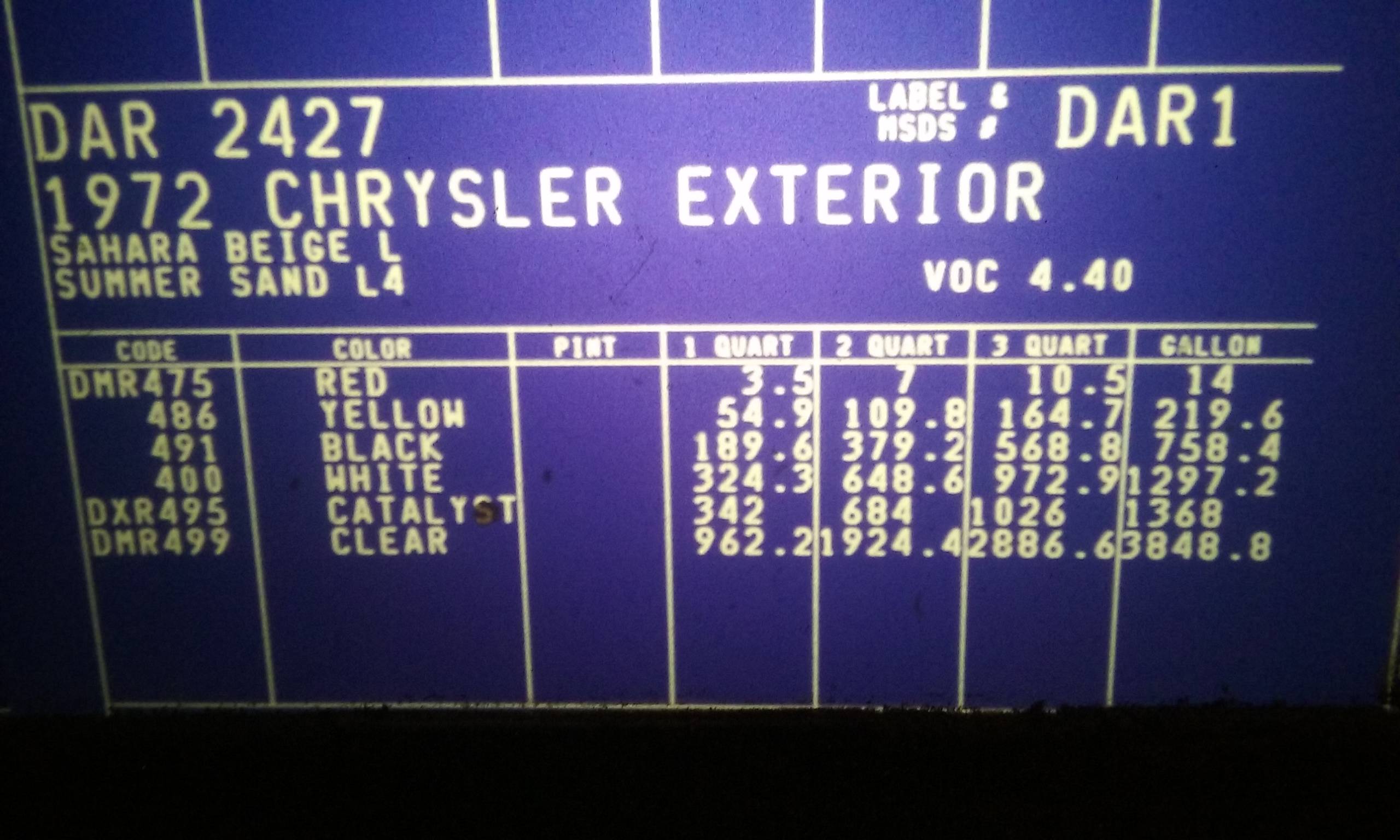

2427 SUMMER SAND L4

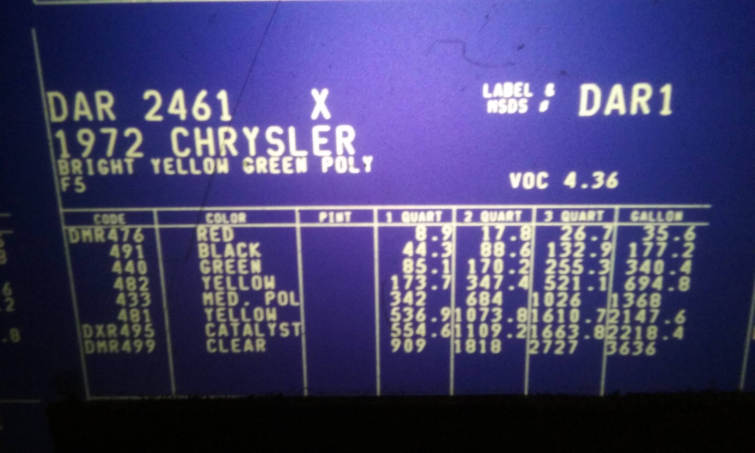

2461 BRIGHT YELLOW GREEN POLY F5

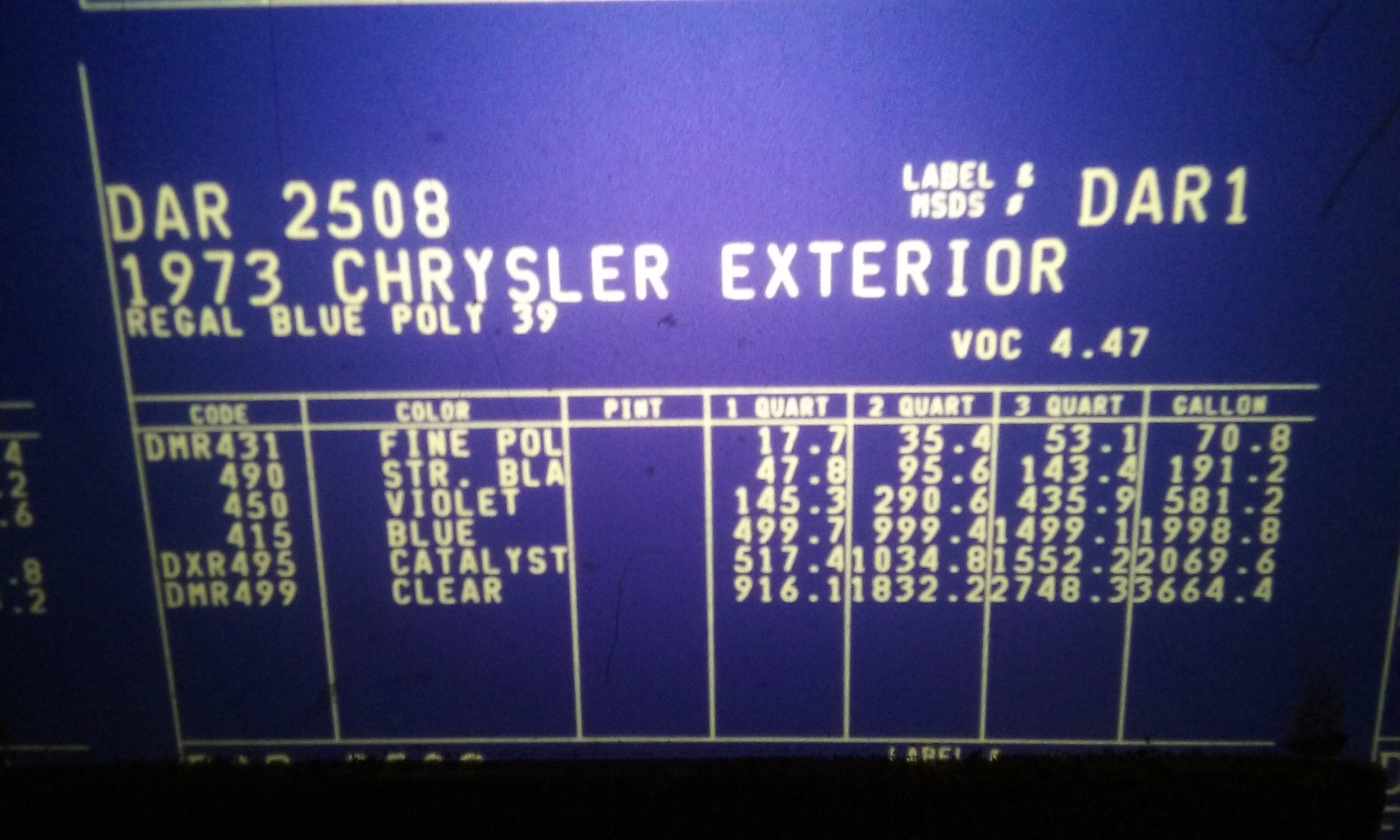

2508 REGAL BLUE POLY B9

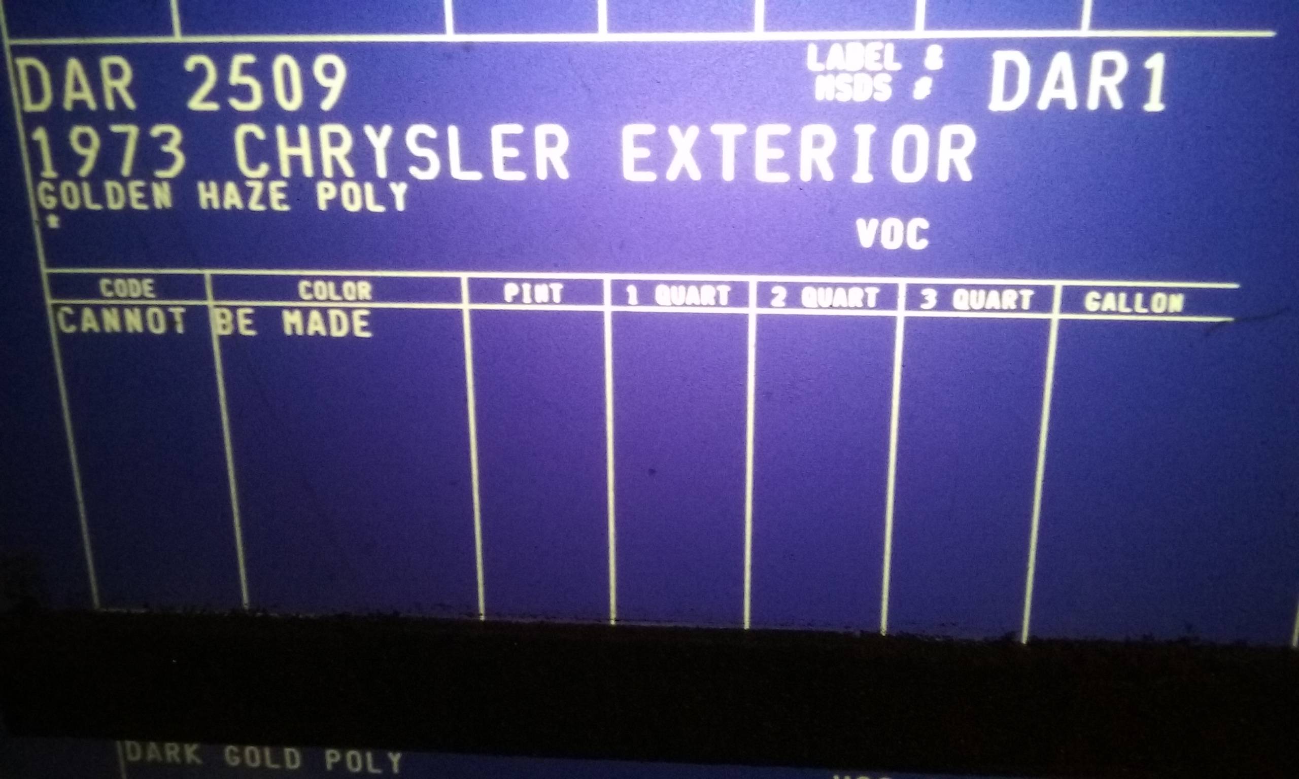

2509 GOLDEN HAZE POLY Y6

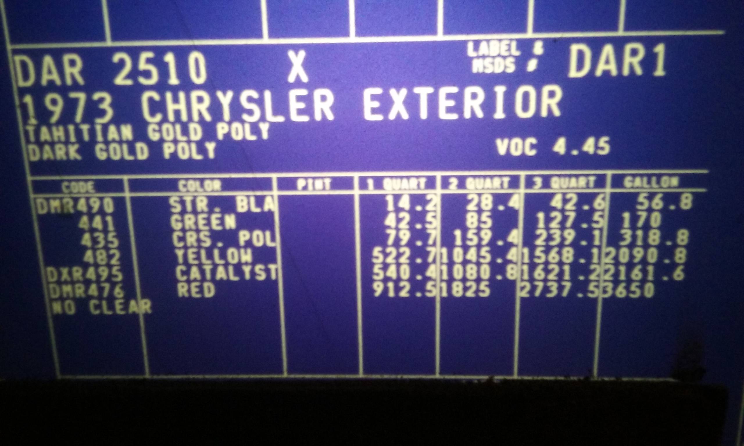

2510 DARK GOLD POLY Y4

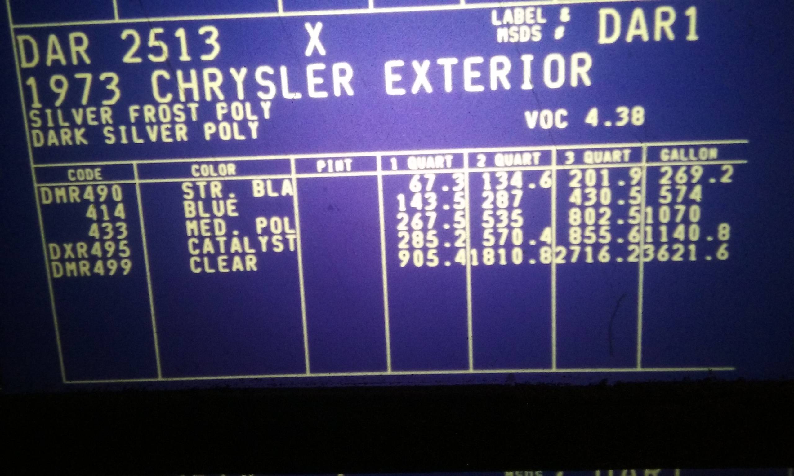

PAINT 2 1972 DAR Acrylic Enamel
2513 SILVER FROST POLY A5

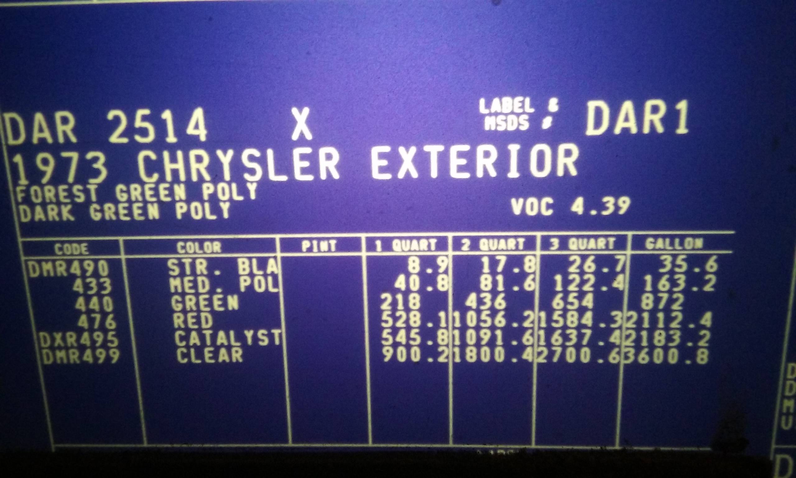

2514 FOREST GREEN POLY F8

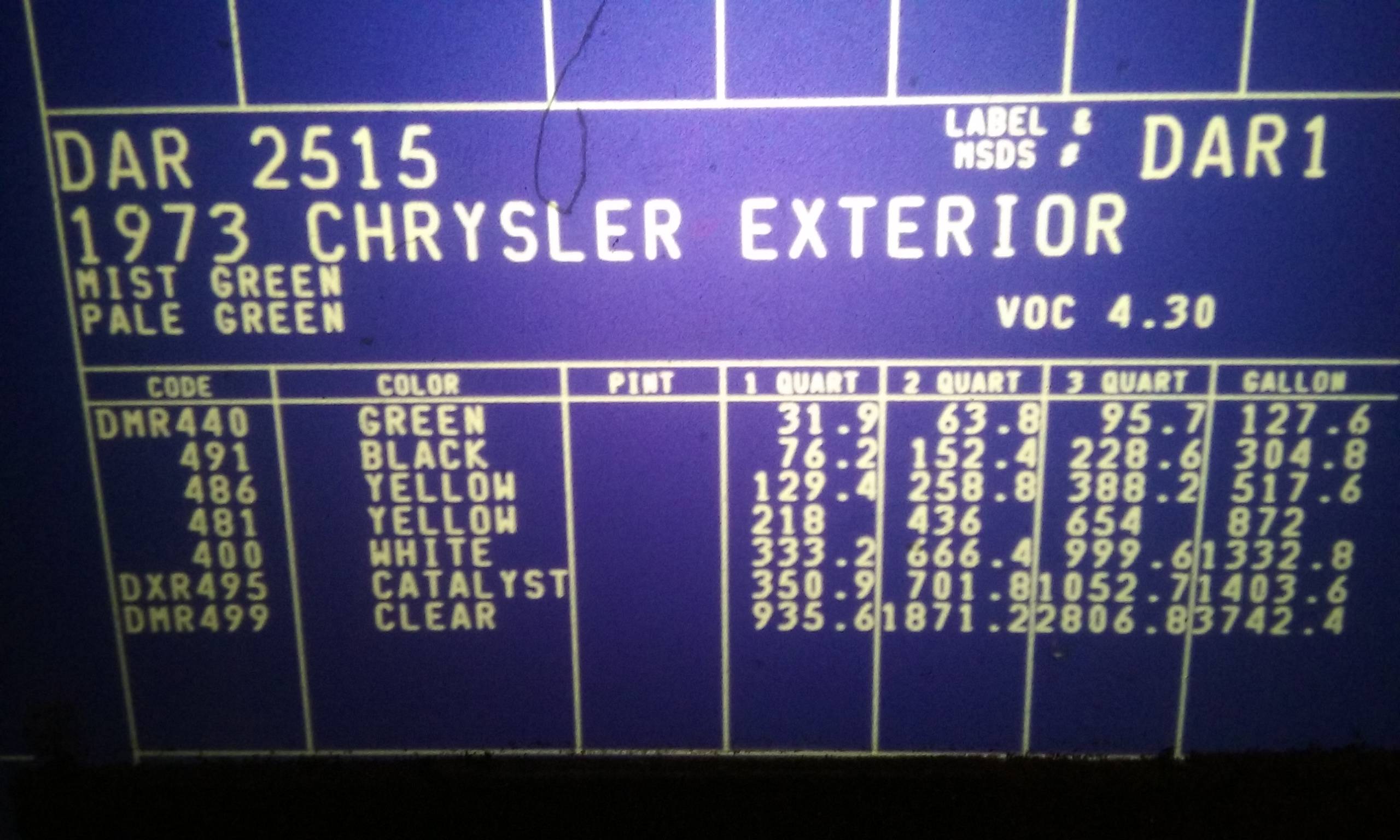

2515 MIST GREEN F1

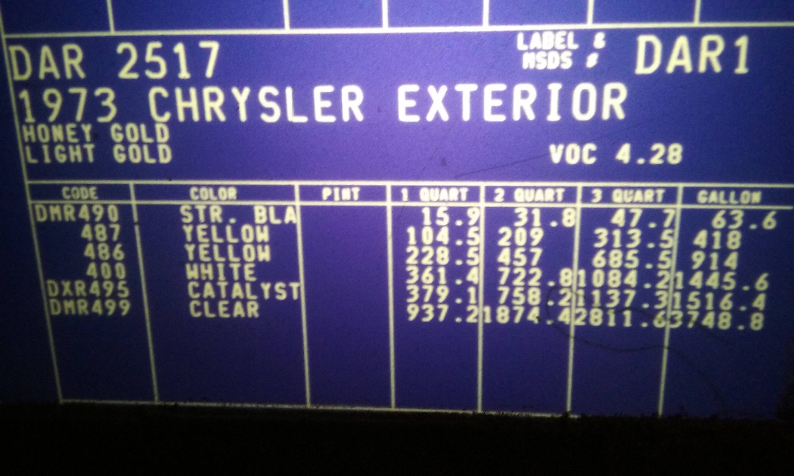

2517 HONEY GOLD Y3

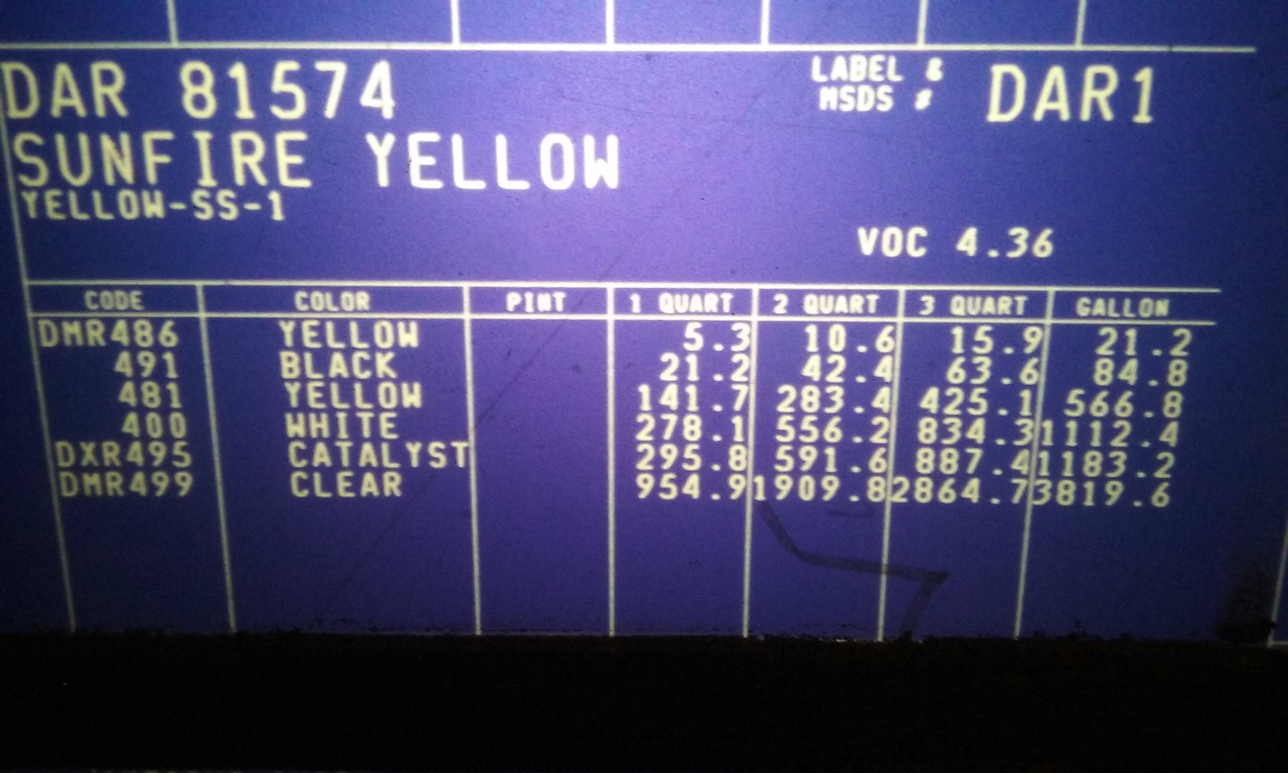

81574 SUNFIRE YELLOW Y2

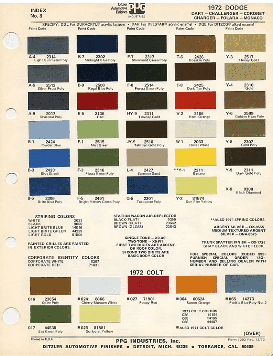

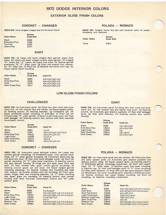

If you don't see the paint code look at the previous year.
