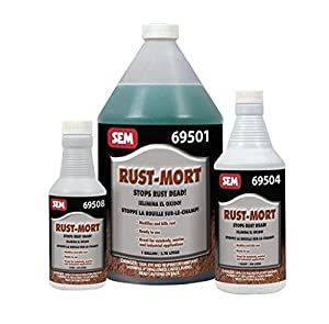

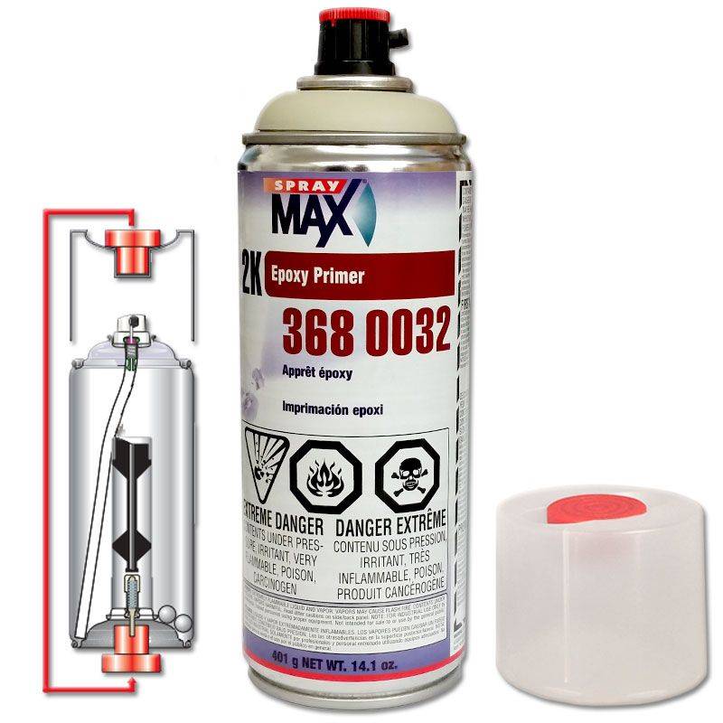

Challenger RTA
Oct 28, 2018
4,539
2,507
PA Flood city
SEM rust mort. Do it first. I should have bought a gallon.in the long run would have been cheaper.Then apply USC SPRAY MAX 2K EPOXY RUST CURE PRIMER 3680032 AEROSOL SPRAY CAN Spraymax. best way to buy as you prep areas. once you activate you have to use it! If you spay a thin coat just to cover, it will be a sealer.. then when ready scuff and recoat for build up if needed. someone else my like a different product.
