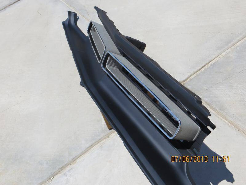

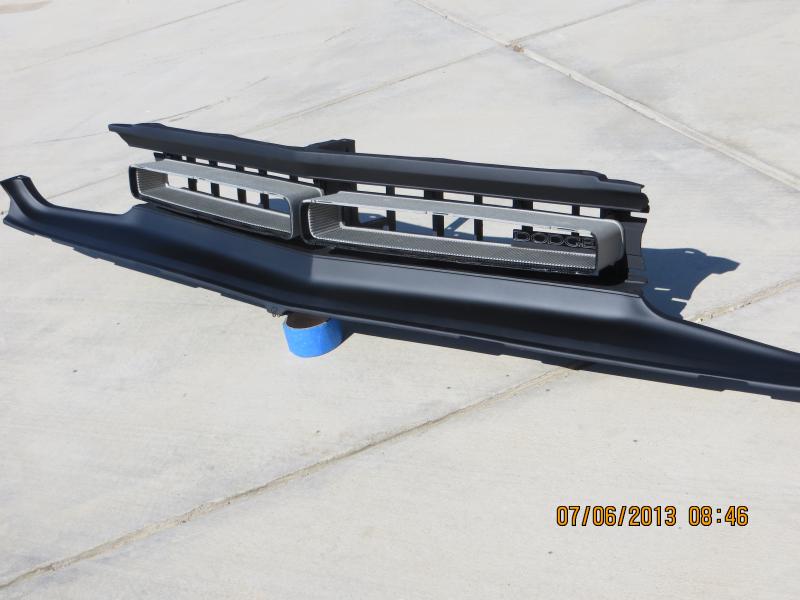

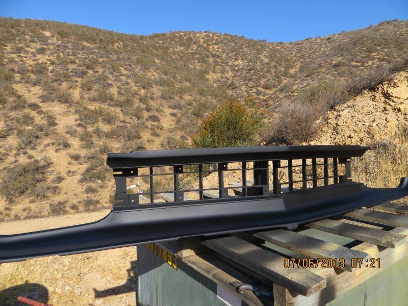

My grill was kind of rough and had several cracks. I repaired the cracks from the backside with Lord Fusor panel bonding adhesive (good stuff). I used a little filler on the front where necessary, shot it with a 2K primer, wet sanded the primer and topped it with Hot Rod Black urethane... Gretchens 502.jpgGretchens 504.jpg

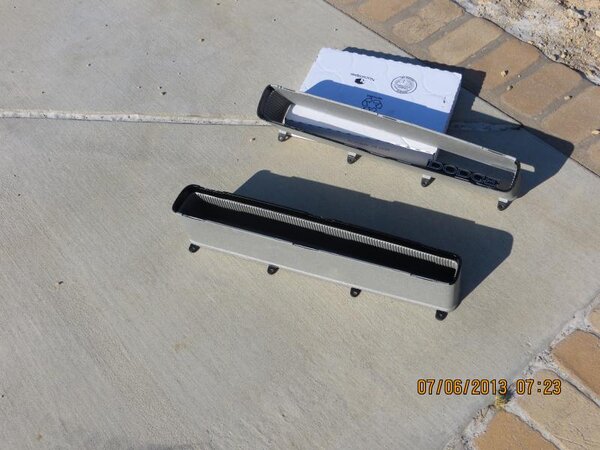

The grille inserts were a major pain; they were bulging where the trim clips attach and had a few mounting tabs broken off. I repaired the bulges & tabs and sanded the outsides to remove the casting lines, also needed a little filler. Originally they appeared to have been a silver with no texture in it. To help hide the flaws I shot em with some left over Textured Argent I got from Year One about 12 years ago! Still good, just had to stir the crap out of it... they turned out well, imo.IMG_3138.jpgGretchens 499.jpgGretchens 501.jpg

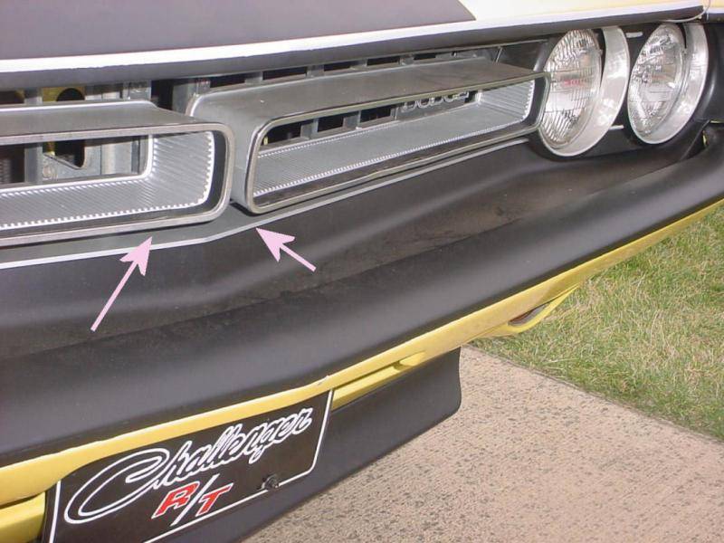

That grille looks a million bucks!! Great job! Have some questions...I'm in the process of doing mine now, but have stalled -not sure where to start. It is in perfect condition, just needs painting. I see you took the centre ovals out -but how did you do it? Just drill those large hollow rivets out? I am reluctant to do that for fear of damaging the surrounding plastic (eg heating up and melting) and 16 rivets to do!! Also, what rivets did you replace them with, do they sell them new? Normal pop rivets wouldn't work I don't think.
Also, what type of black urethane did you use? Here we call it 2-Pack as a hardener is used. It looks like a satin (mild semi gloss) color,.
Sorry for all the Q's
Lastly, were you going to paint the silver areas above and below the ovals (as shown with arrows). As all RTs I have seen have this area in silver
thanks

I used a cut off wheel on a Dremel to grind down the rivets, if you try to drill them they will spin and cause damage. On my grill this was necessary to make repairs, you might be able to leave yours intact. I reassembled it with small stainless Allen head bolts painted black, and Nyloc nuts...
I used "Hot Rod Flatz" urethane, but there are other brands used for rat rods and such...
I will paint the flat area silver when I shoot the silver light recesses on my tail panel...

Thanks for all the answers . I was holding off using a drill on those rivets until I had read how you did it. So I won't drill them now. I have needed a Dremel quite a few times, but they aren't cheap, might go down to a body shop and ask them to do it for me. Also amazing is that you chose the same reattachment method as me - A few days ago I just bought the same thing! Except I bought black oxide Allen bolts with Nyloc nuts. Maybe I better ask them if they rust easily once exposed to water , as I might have to swap them for stainless steel ones also. At least these ovals are easy to remove now, so you can paint the silver top and bottom. It could be done with them in place but it's a masking nightmare. Removing them makes it so much easier.

If you paint them they should be ok... Btw, go buy a Dremel, you will not regret it, I use mine for many things i couldn't anticipate.. get the little fiber reinforced cut off wheels.

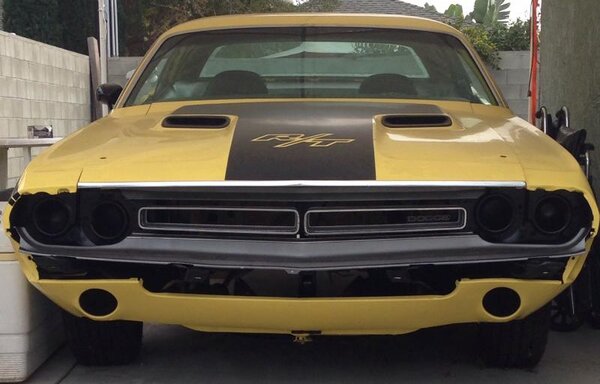

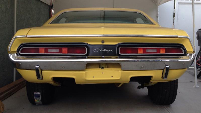

Thanks for the info guys, haven't been here for a while. Been busy with the car. I finally got my grill and headlight bezels, thank you Fall Fling. I don't know if any of you guys went. Now to start getting it to look like an R/T grill.image.jpgimage.jpg

Very cool car! looks like the one with the rubber bumper on pg 1 of this thread. Are you going to black out the tail panel behind the lights? I went to the Fall Fling too... I saw Leo's hinges there.. he does nice work.

I don't know yet, I have seen it done but I'm still not sure. I like the look on both though and leaning on painting it. It was a nice day at the park, and plenty of E bodies to go around. A few decent projects for sale too.
