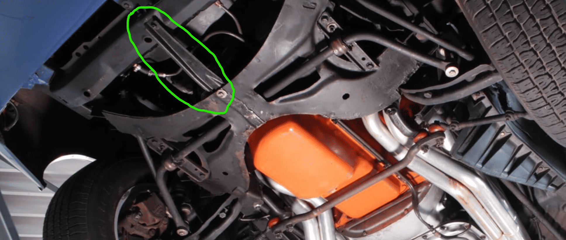

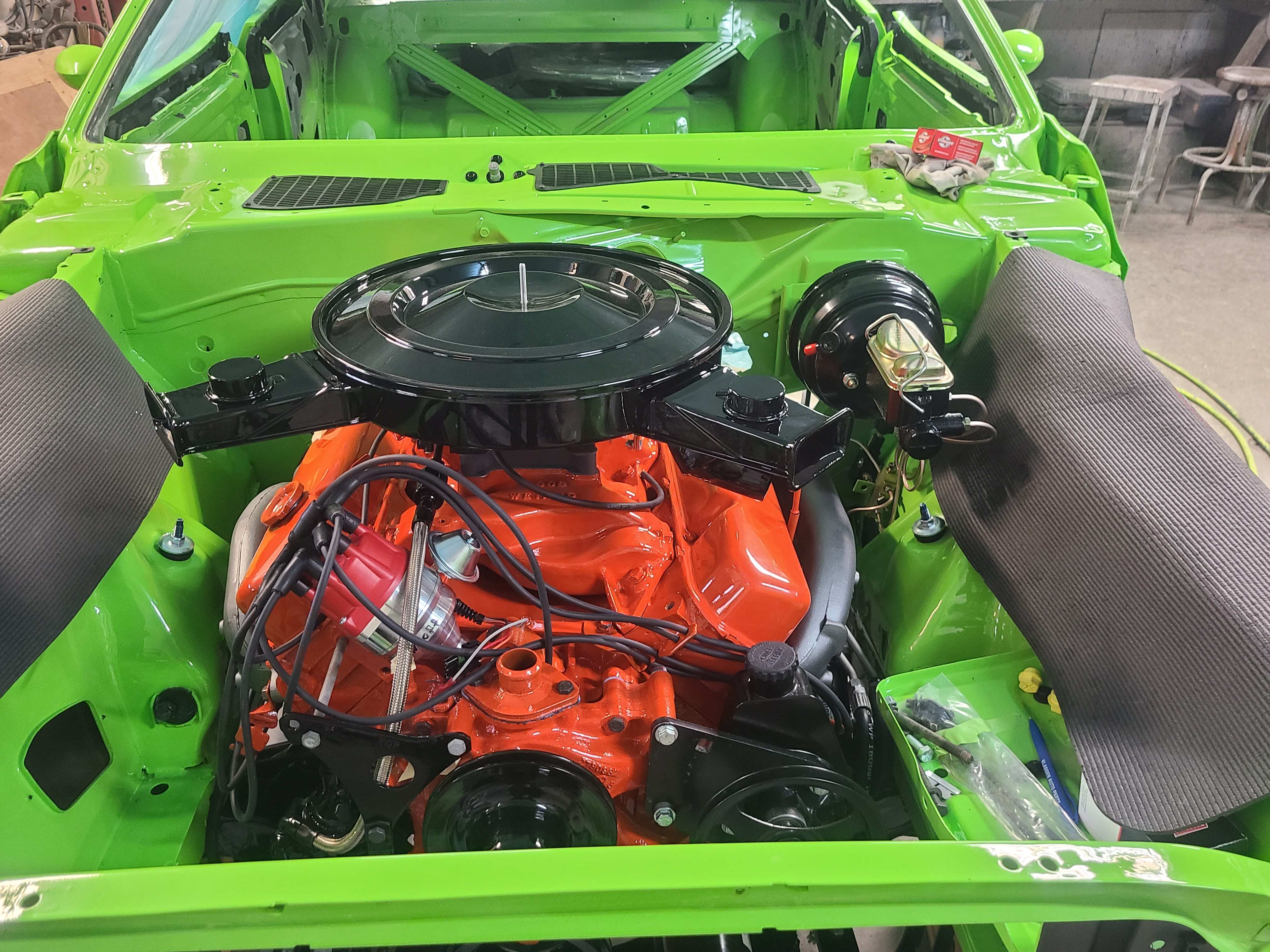

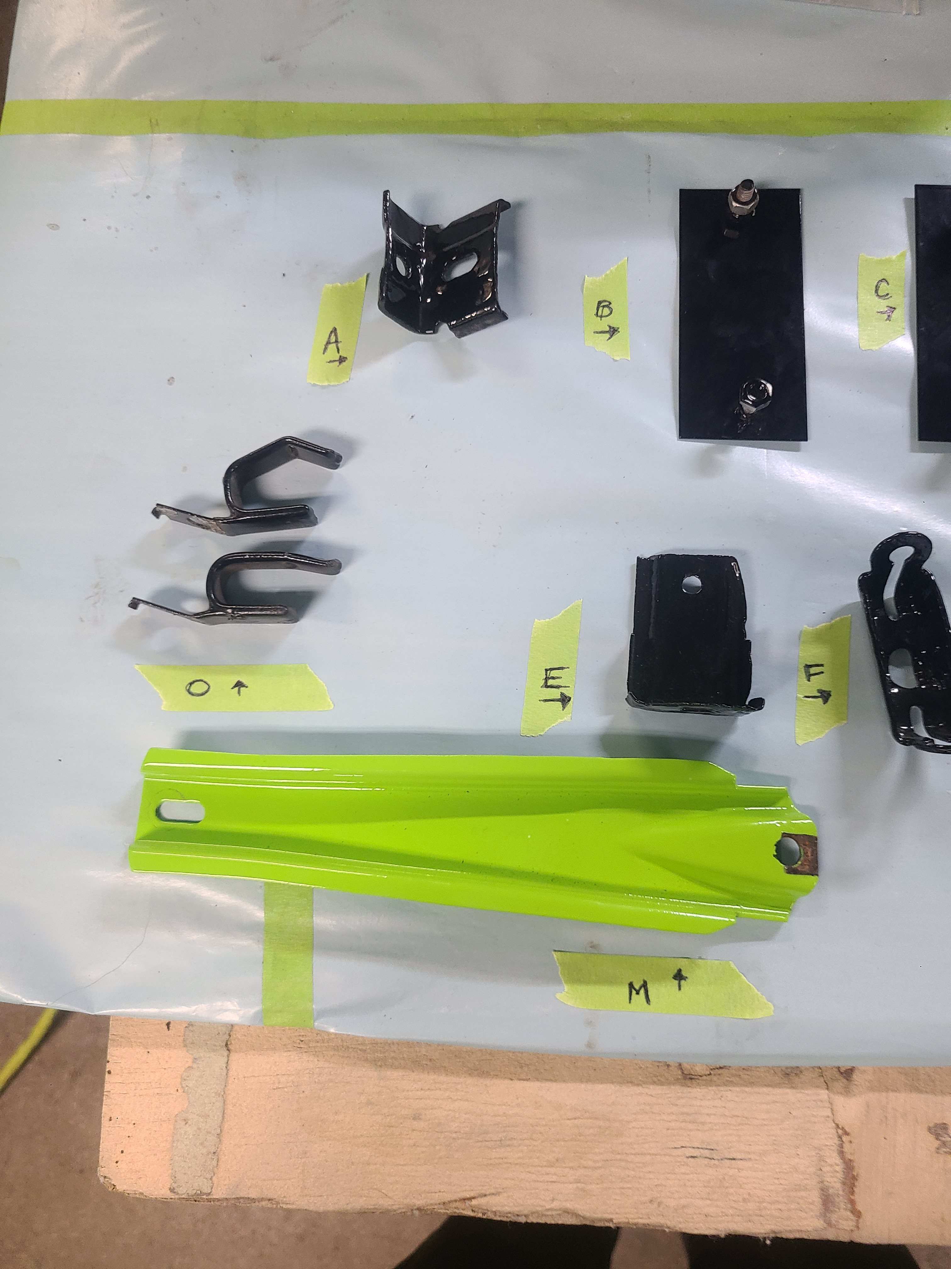

Hello everyone I am looking where these parts go any helpnis greatly appreciated

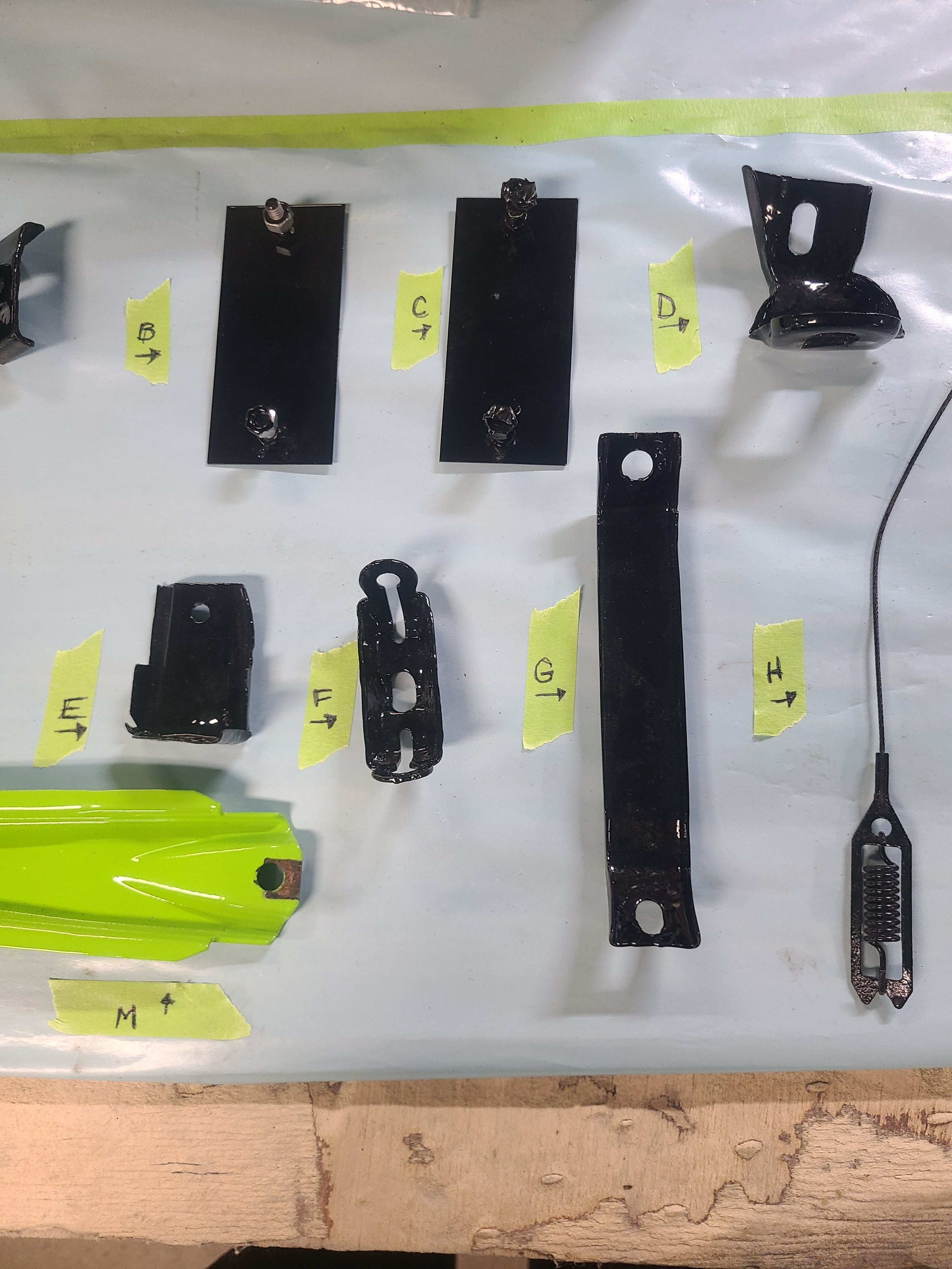

B and C muffler mount brackets I think. N, I, J transmission linkage. D looks like a fender brace.
F,H , look like parking brake peices. O, looks like brackets to hold wiring behind the brake booster. I could be wrong on these as I'm trying to remember these from when I did my car.

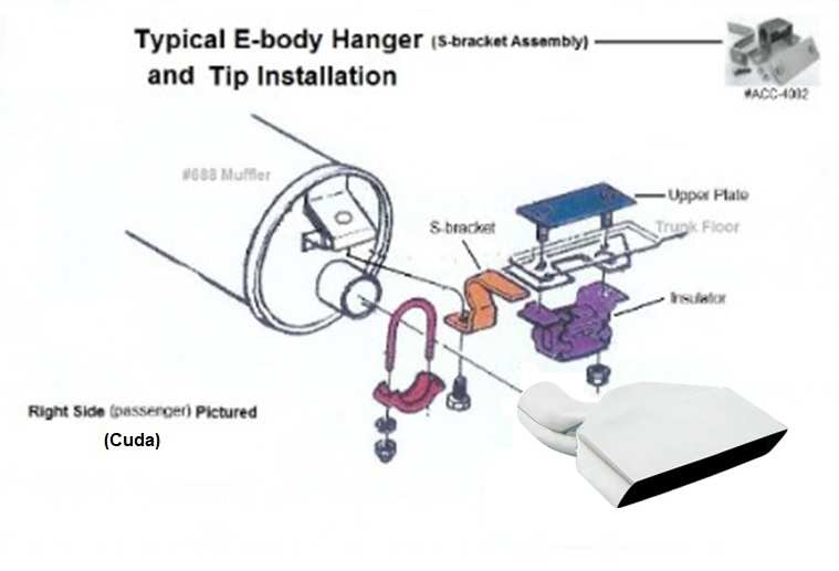

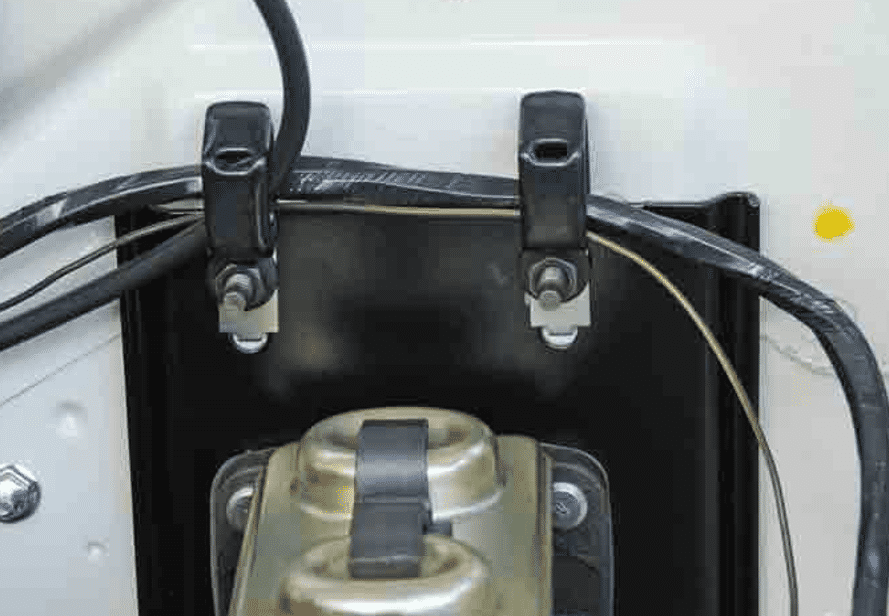

B & C - Exhaust hanger plates inside trunk. One on each side. Should be zinc (silver) color. Marked "Upper Plate" in blue below.

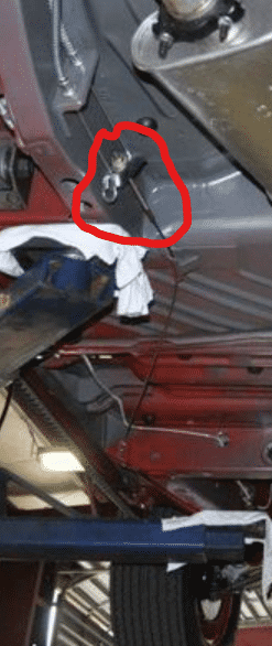

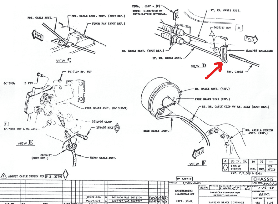

F - Emergency Brake cable tensioner bracket

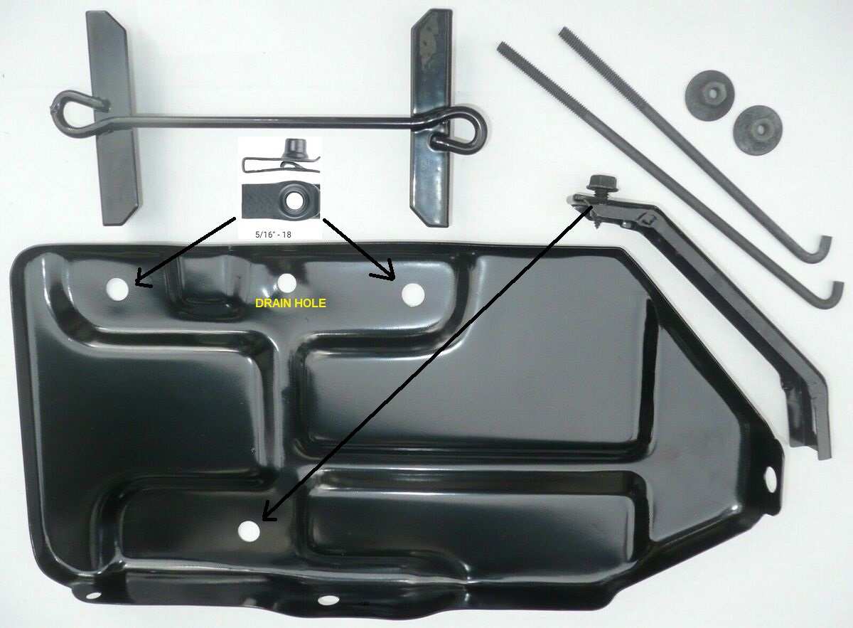

G - Battery Tray support bracket.

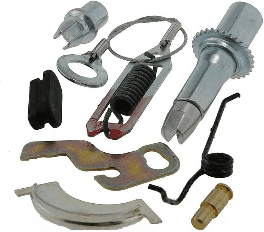

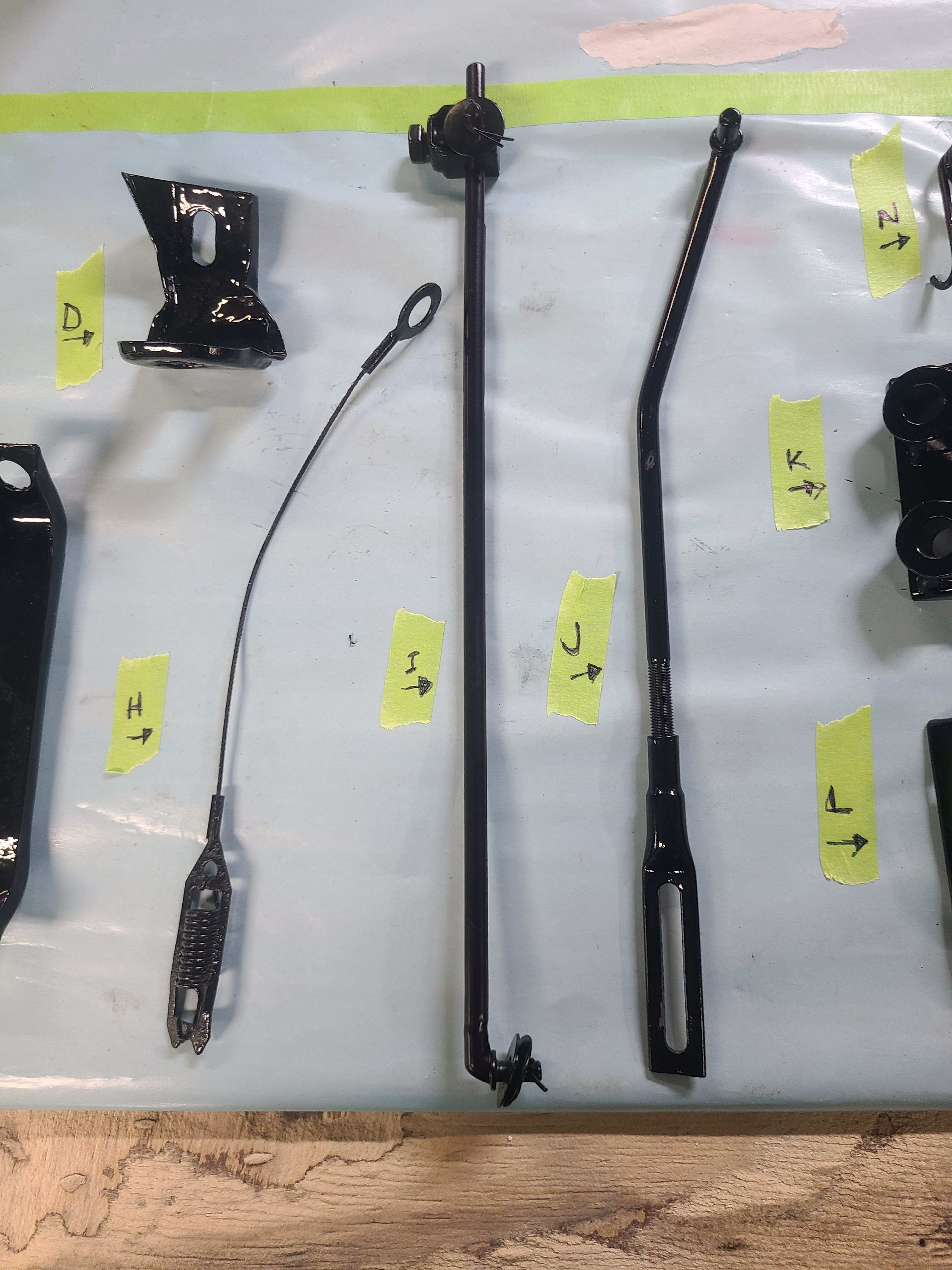

H - Manual brake self-adjuster cable

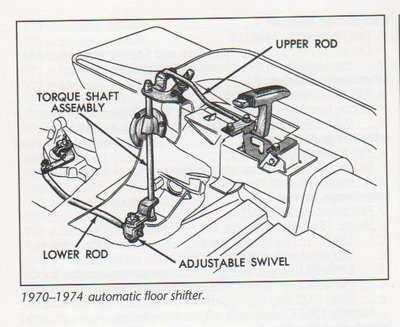

I - Automatic Transmission Lower Rod with Adjustable Swivel (under car at transmission)
J - Throttle pressure "kickdown" linkage
M - Front K-frame to lower radiator support bracket

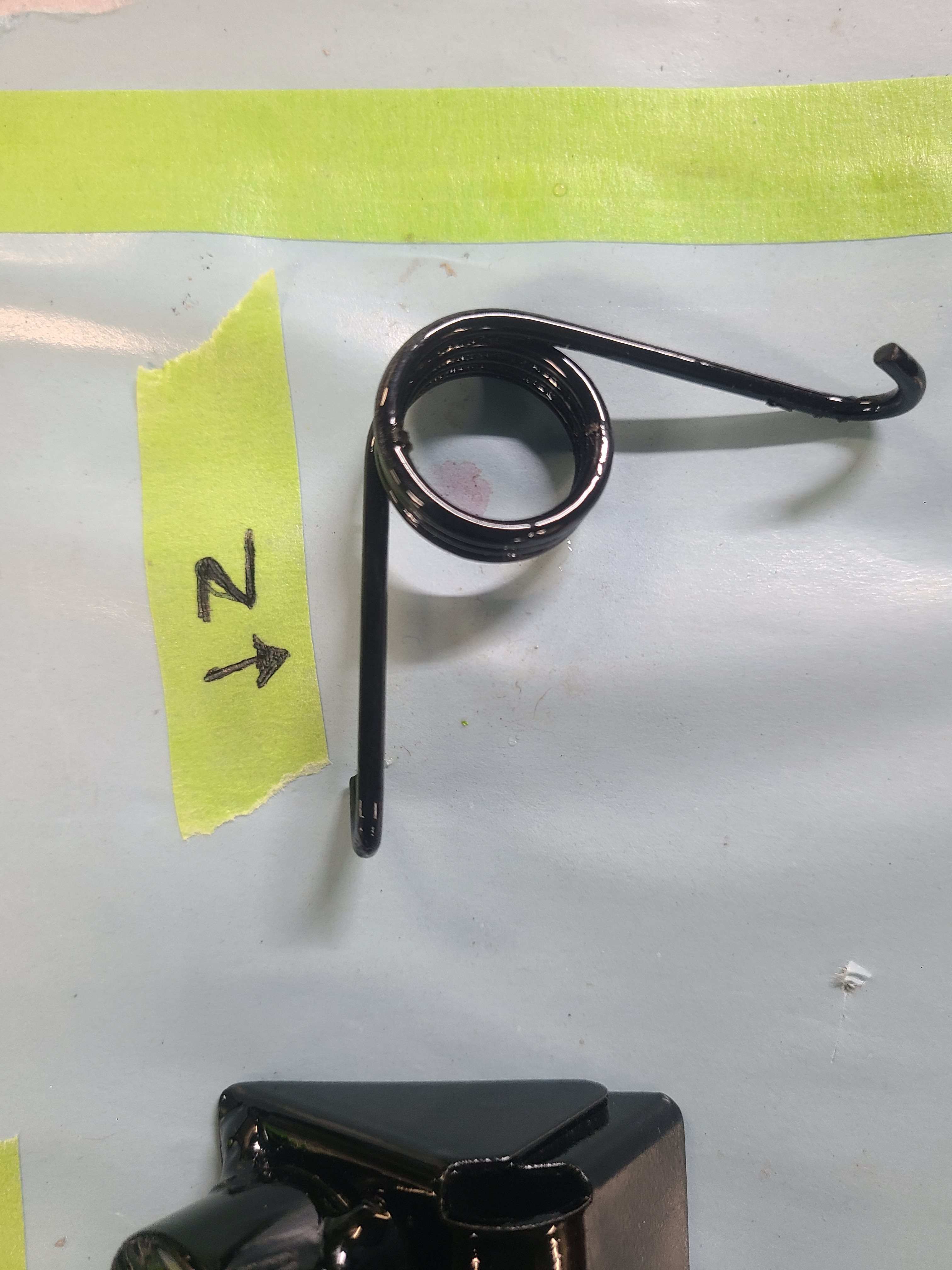

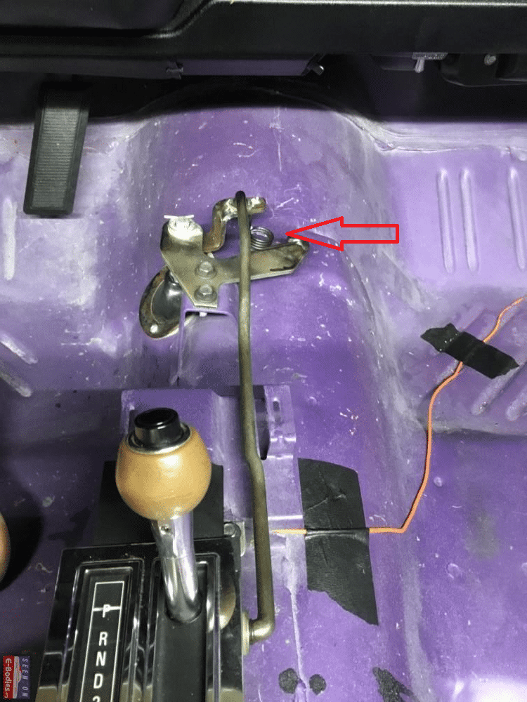

N - Console automatic front linkage spring (under front of console)
O - Manual Brake wire routing brackets (not sure if you have power brakes).
