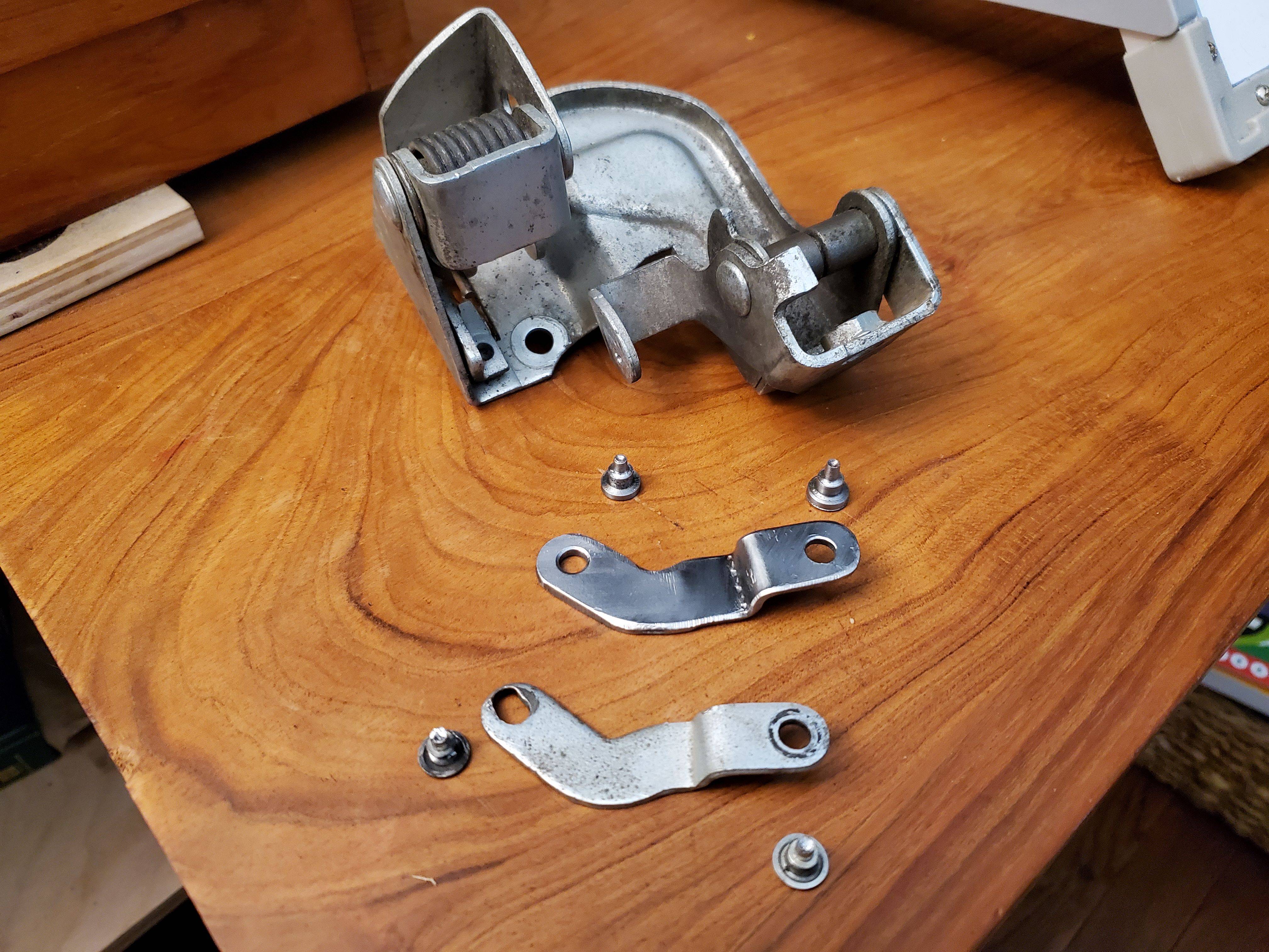

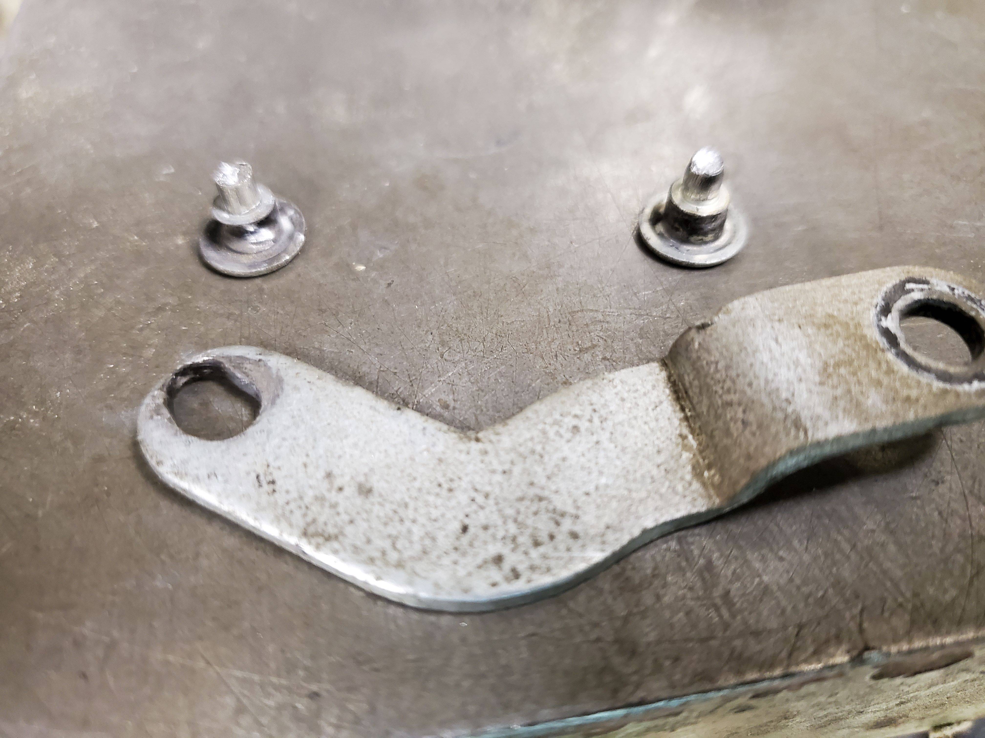

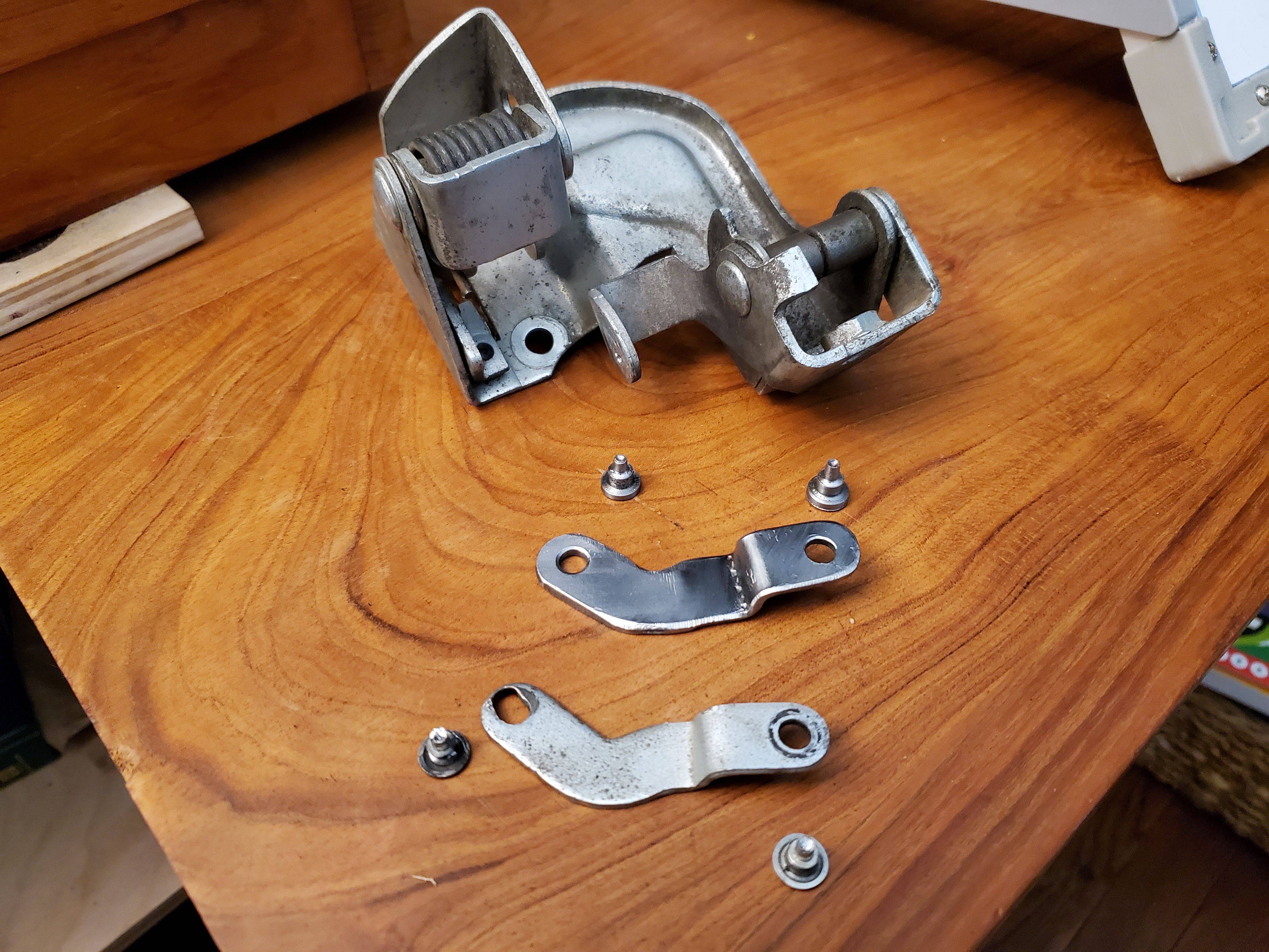

Obviously without pulling the door panel off the inside we can't be sure what's going on. I did a full rotisserie restoration on my 73 Challenger so I had every part off and disassembled. I found that the passenger inside door handle mechanism was worn to the point of almost not functioning. See attached picture. This seemed strange to me because the drivers side that gets a lot more cycles was OK. I had to drill out the pins, make a new link and 2 new pins, then reassemble and swage pins back in place. You can see in the picture how the hole in the old link was almost worn through.

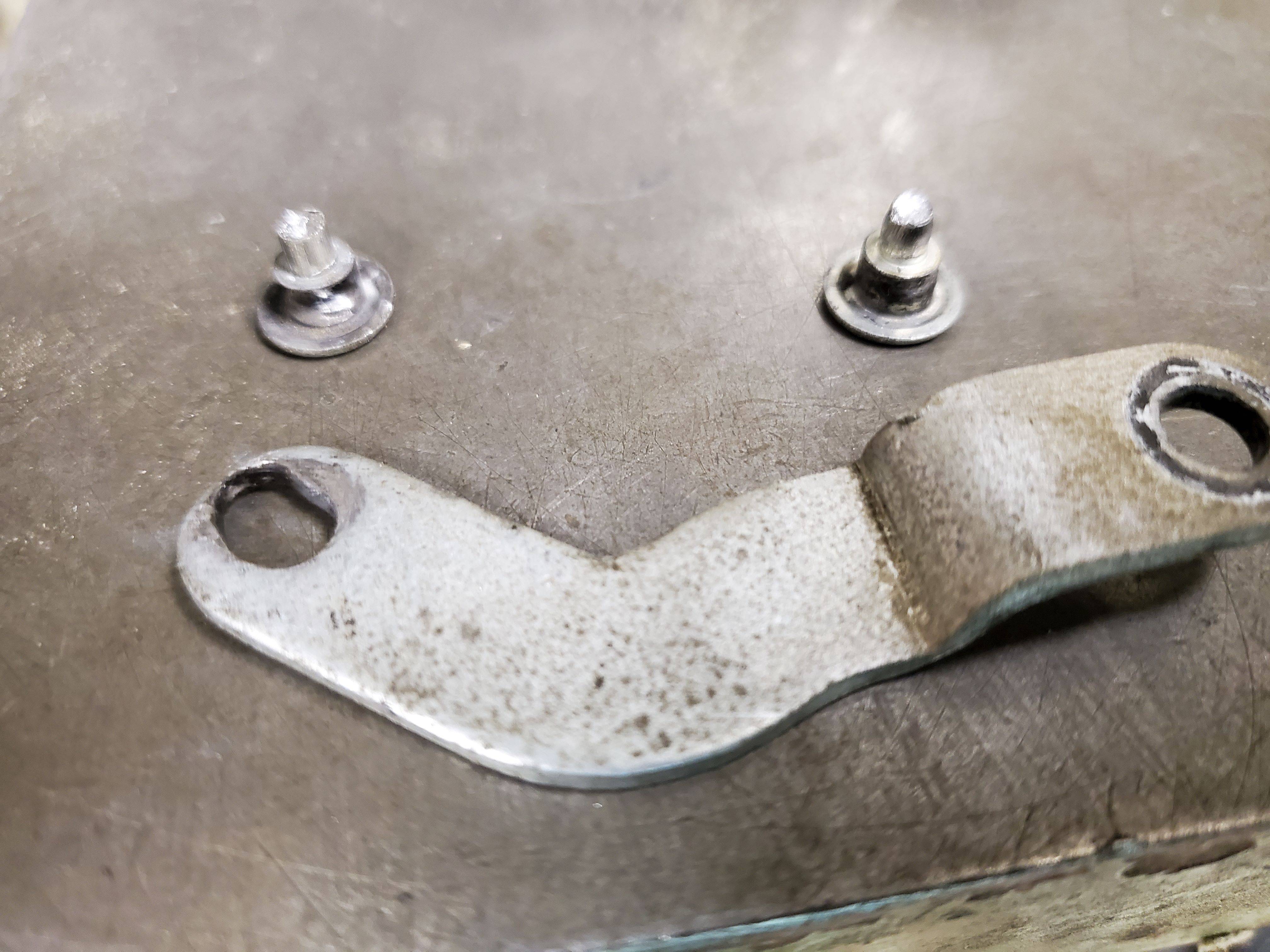

Old link and pins. Pin was almost worn through also
