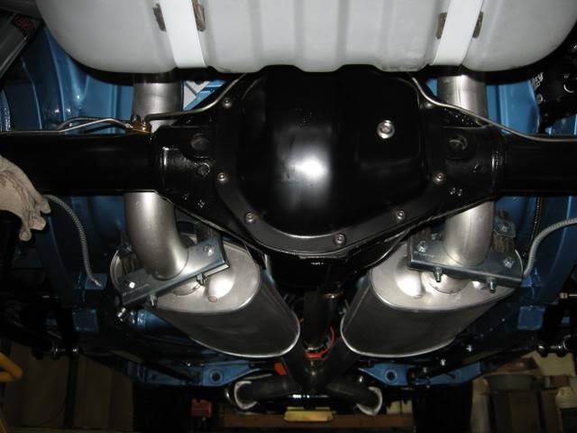

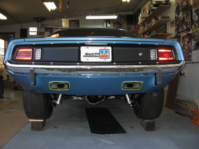

For my Cuda, I went with Hooker Super Comps, 3" TTI x-pipe, Dynomax Super Turbo mufflers and tips.

This is something I've been wanting. Any issues with the pipes fitting clean?
If you are asking about the fitment of the TTI exhaust on my Cuda, there were no problems. I installed the exhaust system by myself in my garage with the car on jack stands. No cutting, no massaging, no hammering. Just fit as you see in the photos above.
There are other (cheaper) kits available, such as those from Summit and Jegs, but based on some buddies' experiences you can expect to massage/modify the pieces to fit your application.
