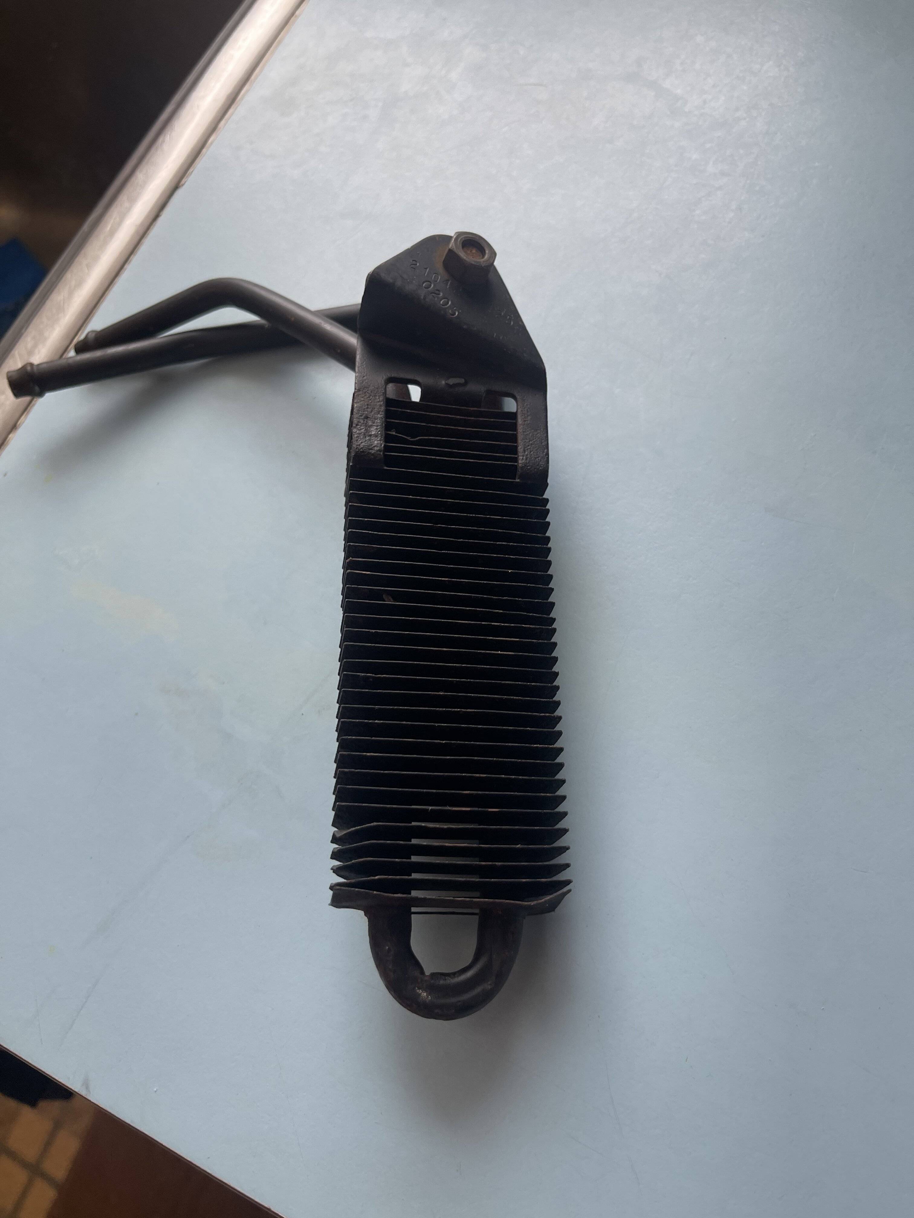

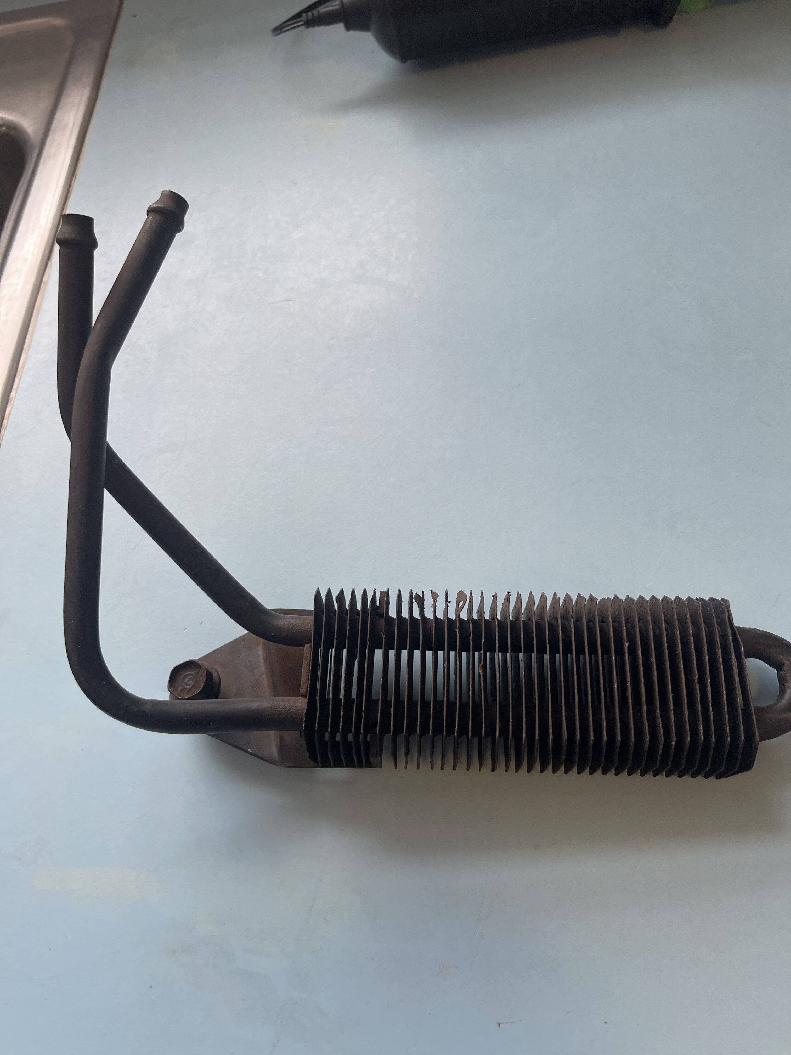

Mar 13, 2023 #1 B bballfan1 Well-Known Member Joined Feb 8, 2016 Messages 90 Reaction score 2 What is its application?
Mar 13, 2023 #2 T tonysrt Well-Known Member Joined Mar 12, 2017 Messages 587 Reaction score 175 On a 71 Cuda was bolted to the P/S pump. Used on cars with 3.90 and taller rear gears.
Mar 13, 2023 #3 340challconvert Well-Known Member Joined Feb 13, 2011 Messages 5,342 Reaction score 2,845 Location Parsippany, NJ My A66 1970 Challenger came with the ps cooler with 3:55 gears
Mar 13, 2023 #4 4 413 Well-Known Member Joined Mar 23, 2019 Messages 193 Reaction score 98 3.54 3.55 3.91 and 4.10 gears had them. 1969-1972 that one is not for a Saginaw pump 383-440 that one is dated 0205 so 1975, not from a musclecar pump.
Mar 14, 2023 #5 T tonysrt Well-Known Member Joined Mar 12, 2017 Messages 587 Reaction score 175 Part # 2891241 on 318 & 340 and # 2891162 is on 383 & 440 cooler is on Dana 3.54, 3.55, 3.91 and 4.10. I have the B engine cooler on my gen 2 hemi.
