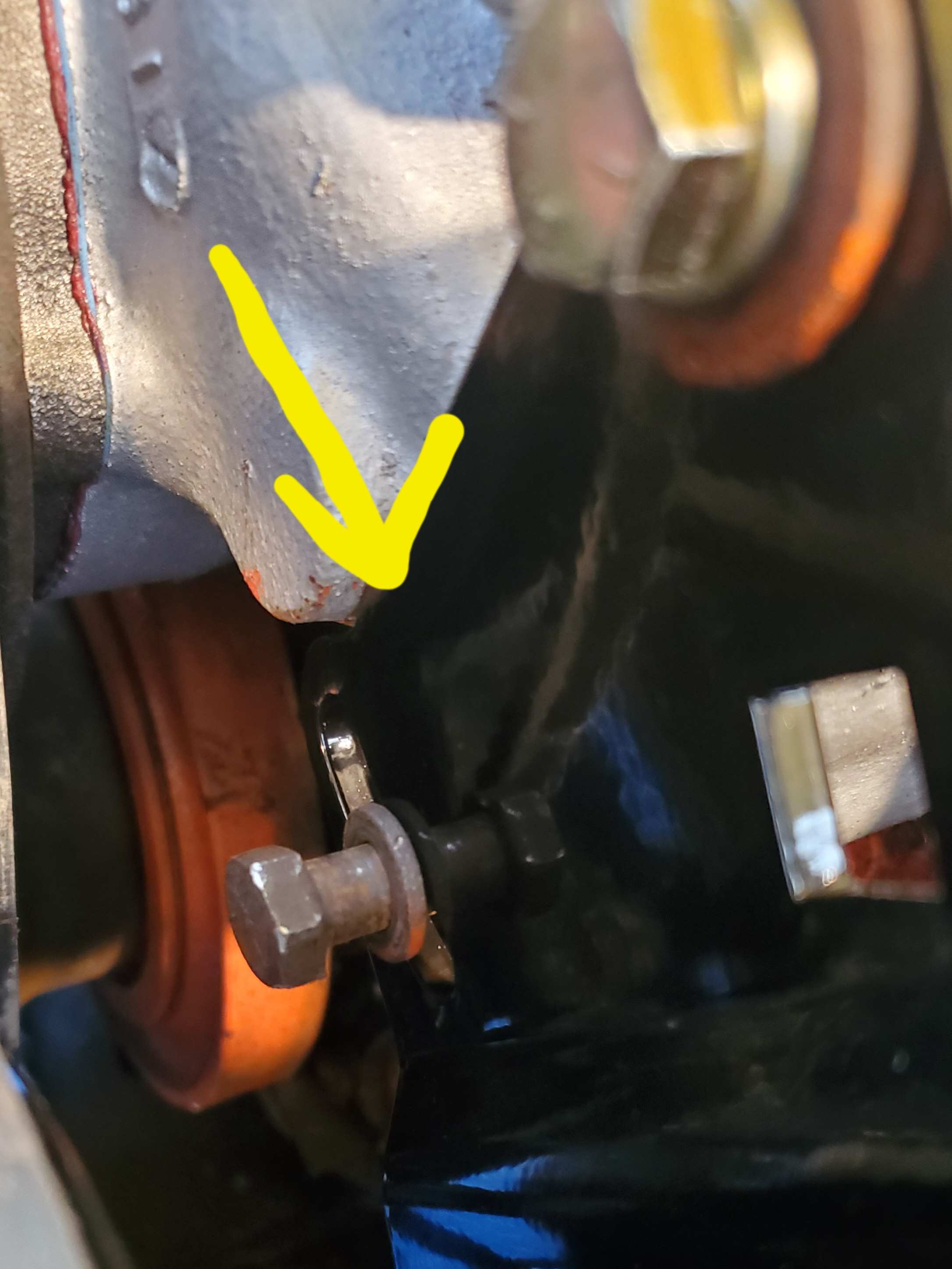

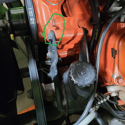

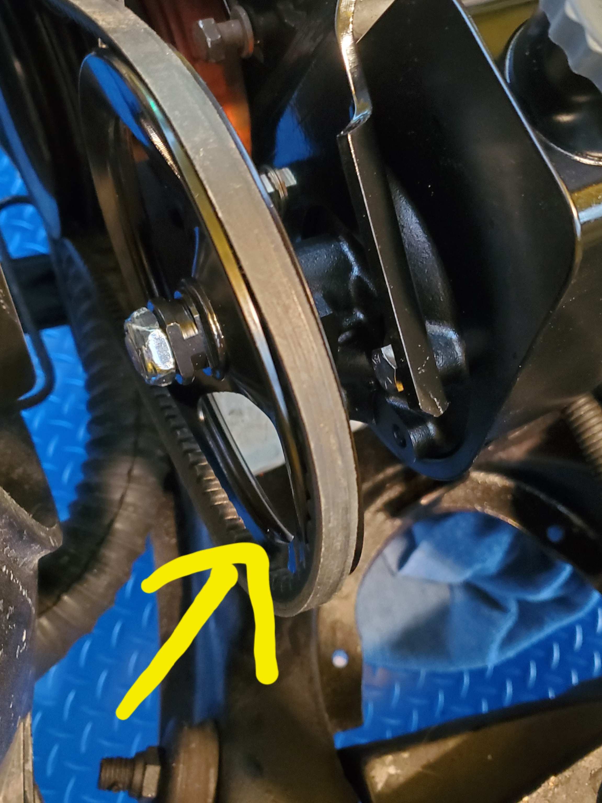

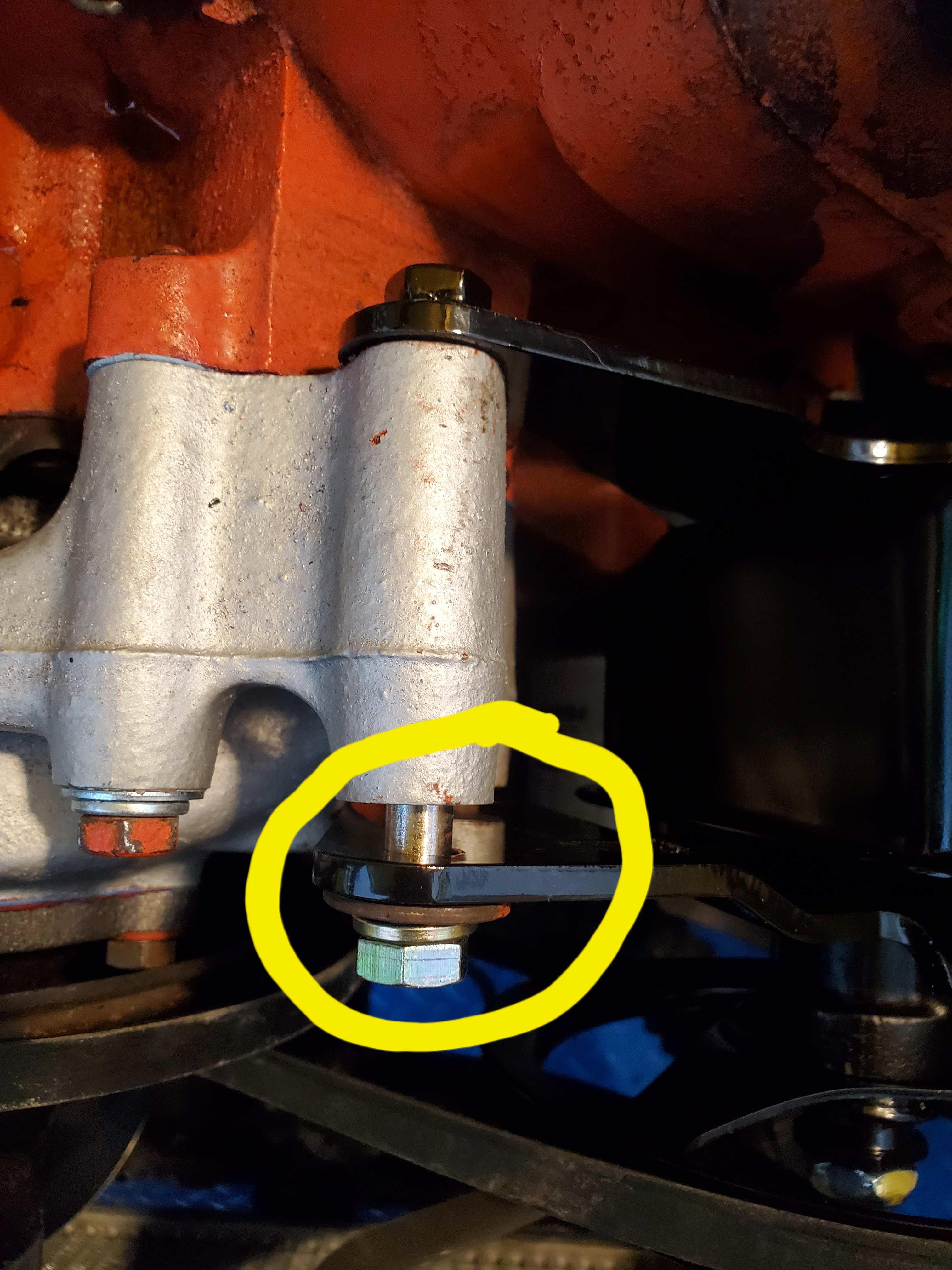

Before I call I want to know if this is easily fixed . This is a Saginaw pump , " canned ham style " , looks great but the top bolt has gaps in it , do I just add washers to tighten it up , the bottom bolt fits but it hits the motor and I can't fit the belt on at all , do I just get a bigger belt , any opinions welcomed , here are some pics .

Before you run with my suggestion, are you sure you are using the correct bracket? If your absolutely sure…..
Measure that gap, and cut a small piece of stainless tubing that slides over that bolt to fill that space.
Challenger RTA
Oct 28, 2018
3,920
2,053
PA Flood city
Thinking you need to flip the back bracket. That might be the problem if I remember. Or is the the alternator I'm thinking of.

I ordered it from 440Source thinking its right , so not mad it doesn't match up perfectly just want to know if its ok to add a bushing and bigger belt .
I don't think it would thread correctly then , but will look again , I'm always out in the garage looking but it has been super cold here in the Midwest .

don't know where the water pump housing came from but on my big blocks the boss that the bracket bolts to appears to be too short. I would try some bushings and for the belt try one a half inch longer.
