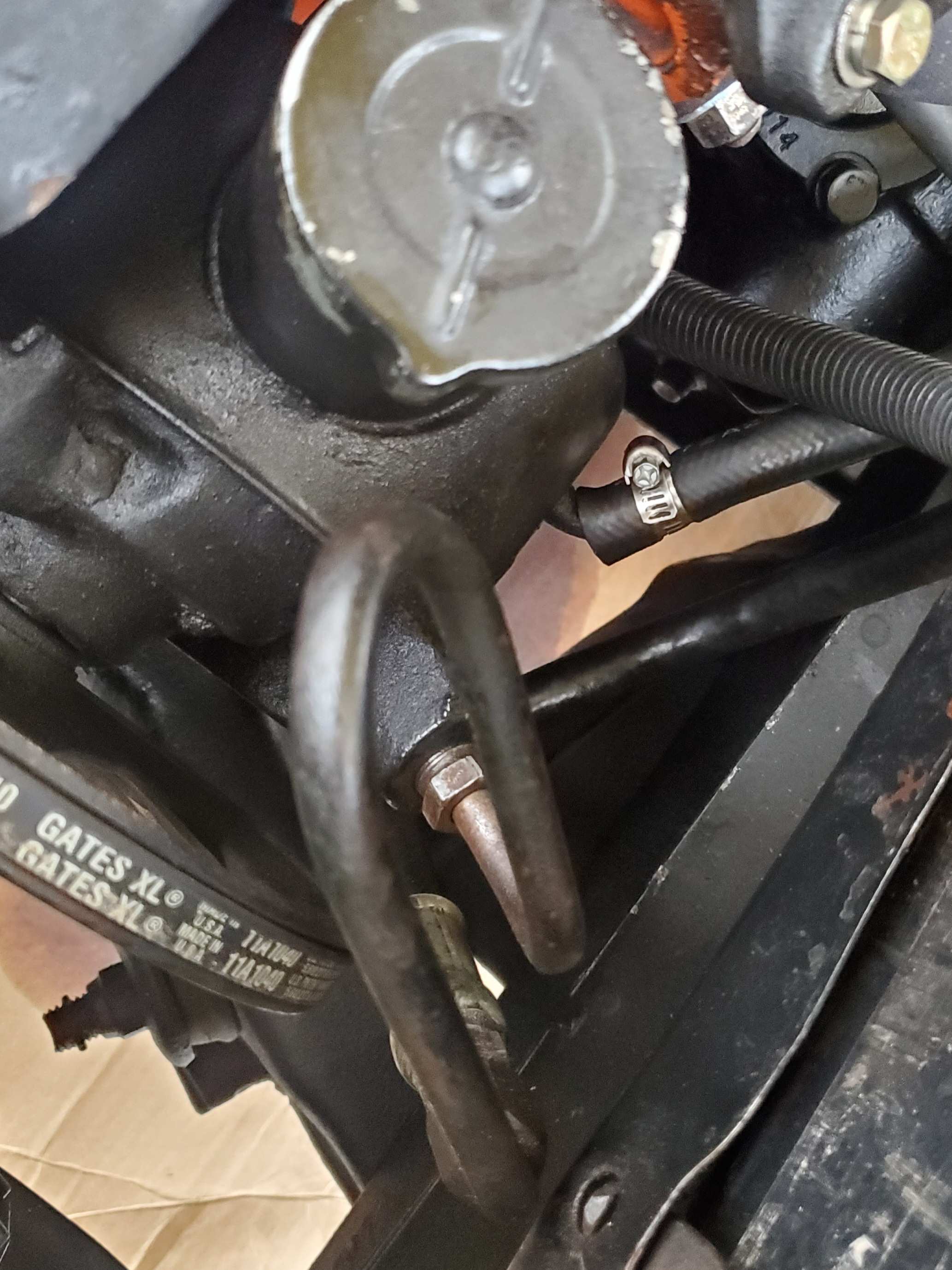

This line looks wrong , it almost hits the belt , plus I'm replacing the pump , any recommendations.

I like the 70 Saginaw pump as it seems to be better. Is the one in the photo above original to the car? Do you care? In the link below you can see the high pressure line screws into the back of the Saginaw pump. You will need a pulley and new high pressure line. Be sure to double check the components below all go together. I think they do, but I'm not guaranteeing it. 🙂 There's other places besides Rockauto that sale the Saginaw pump altogether but it will cost more. I included one link from eBay and another from 440 Source that's a little more than Rockauto but you don't have to worry if I picked the right parts!
Pump:
Pulley:
High pressure line:
Everything ready to bolt on found on eBay:
440 Source:

Thanks dude , probably gonna get the full set up ready to go .
