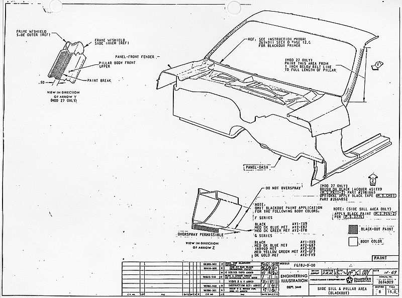

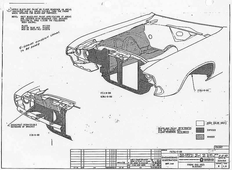

thanks do you know if the inner wheel wheels should be black or body color
Challenger RTA
Oct 28, 2018
3,305
1,739
PA Flood city
Black out areaa.
