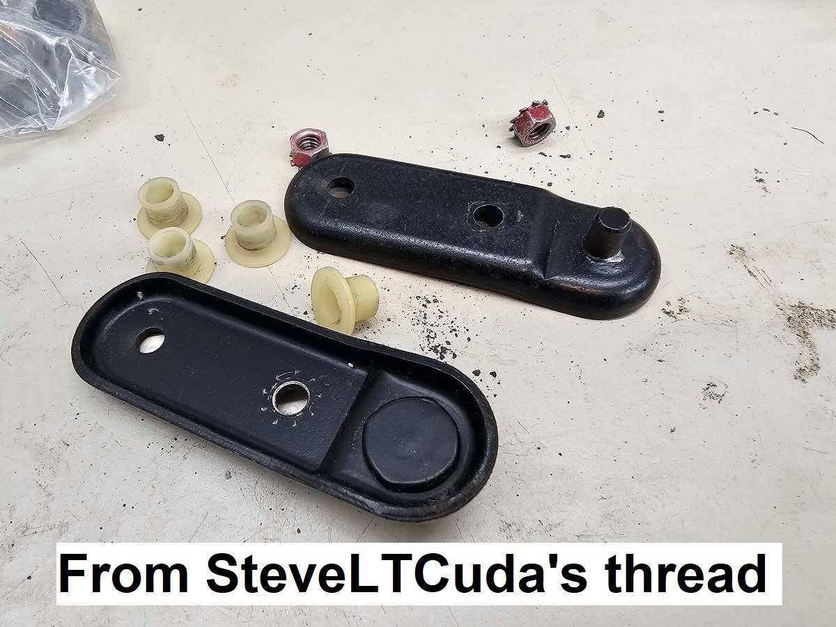

Here's an interesting thread....
My post 7 shows a couple brackets and apparently manual tops have non-hydraulic cylinders so "bracket #2" (in my pic) should be there. If bracket #1 is missing that'll be tough to get.
The correct one (#2) shows up from time to time. In a pinch a suitable replacement would be pretty easy to make.

Here is a link to an old for sale add shows details
Those look the same as the ones SteveLTCuda had (Posts #10 & #18 of his thread). I got the impression they were from/for his non-power top. If there's a difference I don't see it and would appreciate it being pointed out if there is one. Thanks, John.

Again, there is no difference between the power and manual top other than the presence of the appropriate bracket and the correct power rams/pump etc. The actual frame is the same.
This is what’s sidetracking me. What exactly is the “appropriate “ bracket you’re talking about? Is it the bracket that the cylinder goes to? Those look the same to me between manual & power. Or are you referring to the bracket that holds the motor/pump? I’d really like more specifics.
I’m just trying to help the OP so he doesn’t go hunting for something he might not need.
With respect to the top "frame", there is _no_ difference. The "brackets" mentioned are how the cylinders connect to the top frame. If you look though that other thread, it shows good pictures of the parts. They are the ones shown above. They have two holes in them, One for a "peg", the other is for a stud. The picture YOU posted shows this clearly. The protrusion/ stud on the actual bracket, is where the cylinder mounts to it. The other end mounts lower down. The pump mounts to the cross member that all verst have behind the rear seat. There is a spot for the pump to sit right in the middle.
