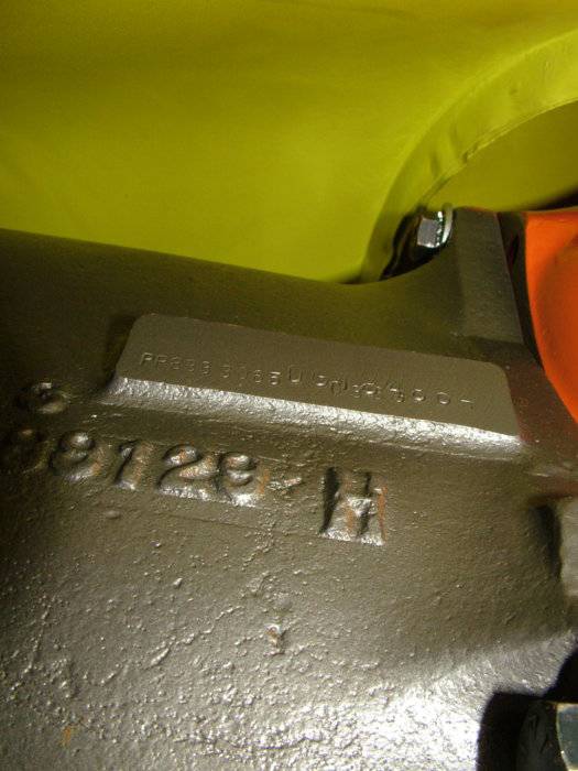

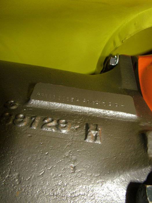

The A833 4-spd numbers are on the machined pad on the drivers side.
