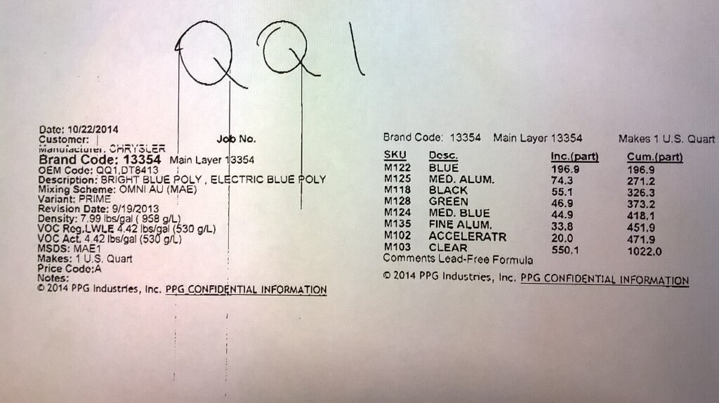

Does anyone know the PPG paint code for 1970 EB5 "Bright Blue Metallic"? It will be for base and clear application
If you ask them to hold 2 of the 4 drops of black, it lightens it just a lil and the silver metallic really stands out. Ask for different swatches.

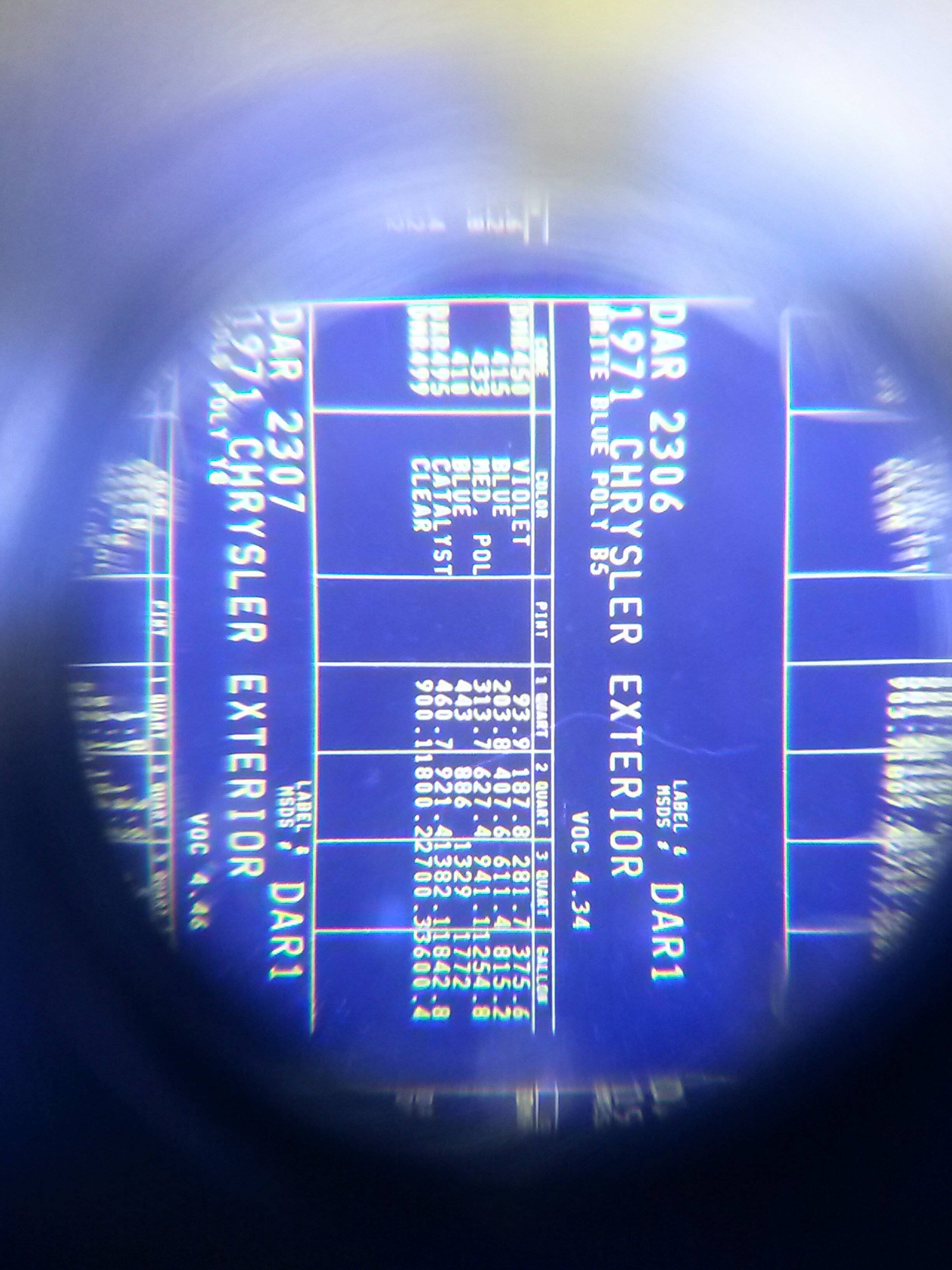

This is the paint mixing code for 1971 B5 DAR 2306 Acrylic Enamel. I mixed paint in the 70's I do recall the 70 B5 blue was lighter. I don't have a micro fiche. need a little time to find. I don't have it the base coat formula. maybe this will help.

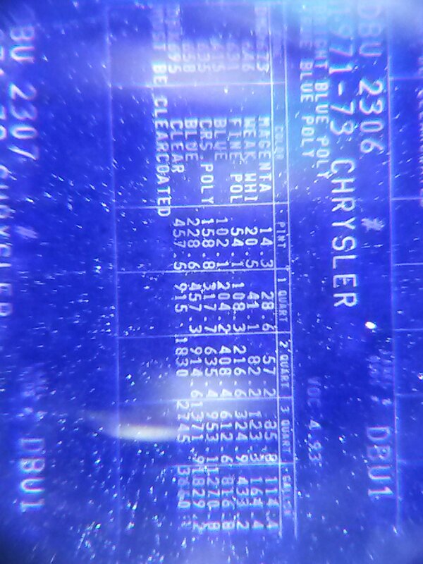

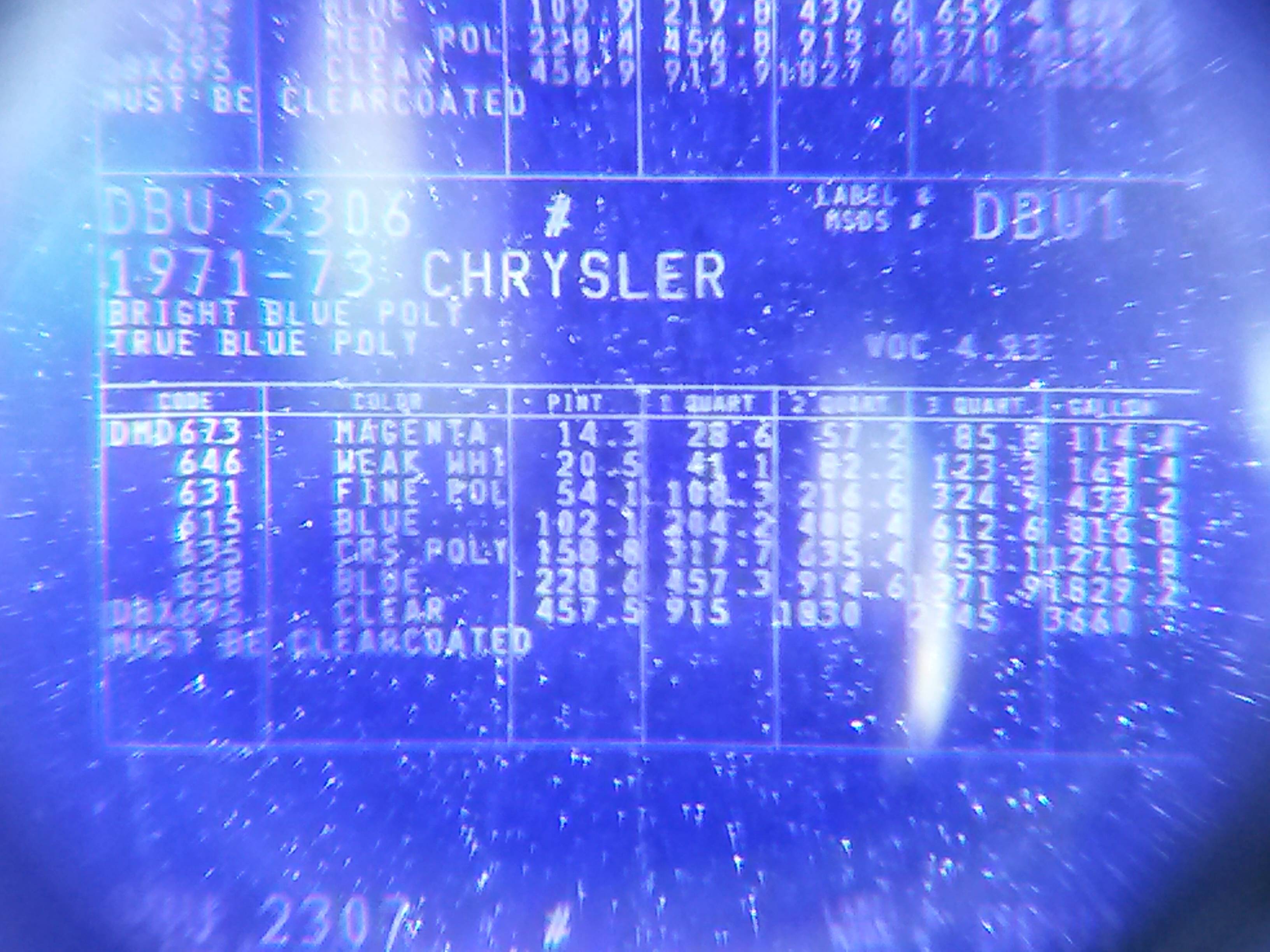

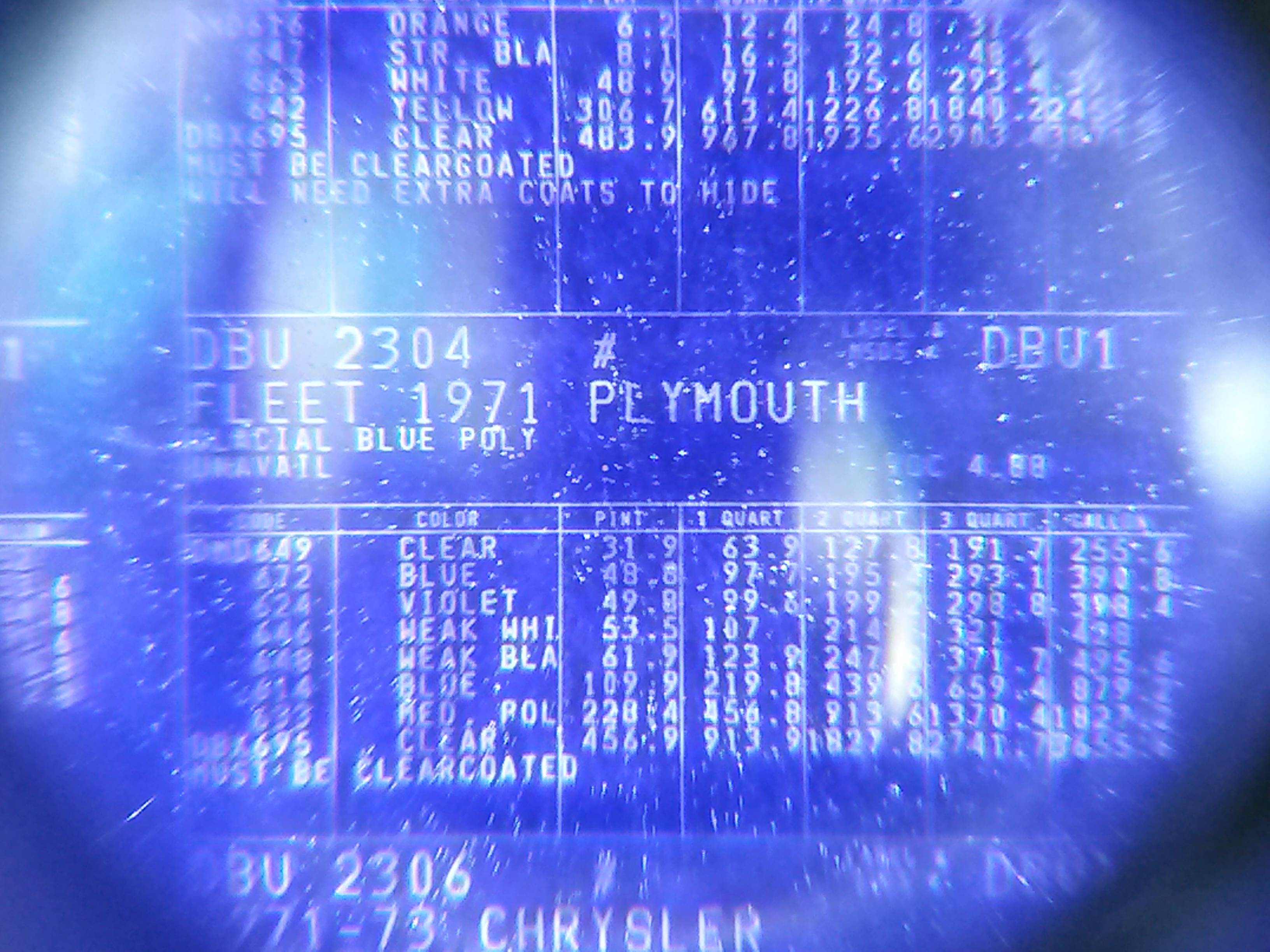

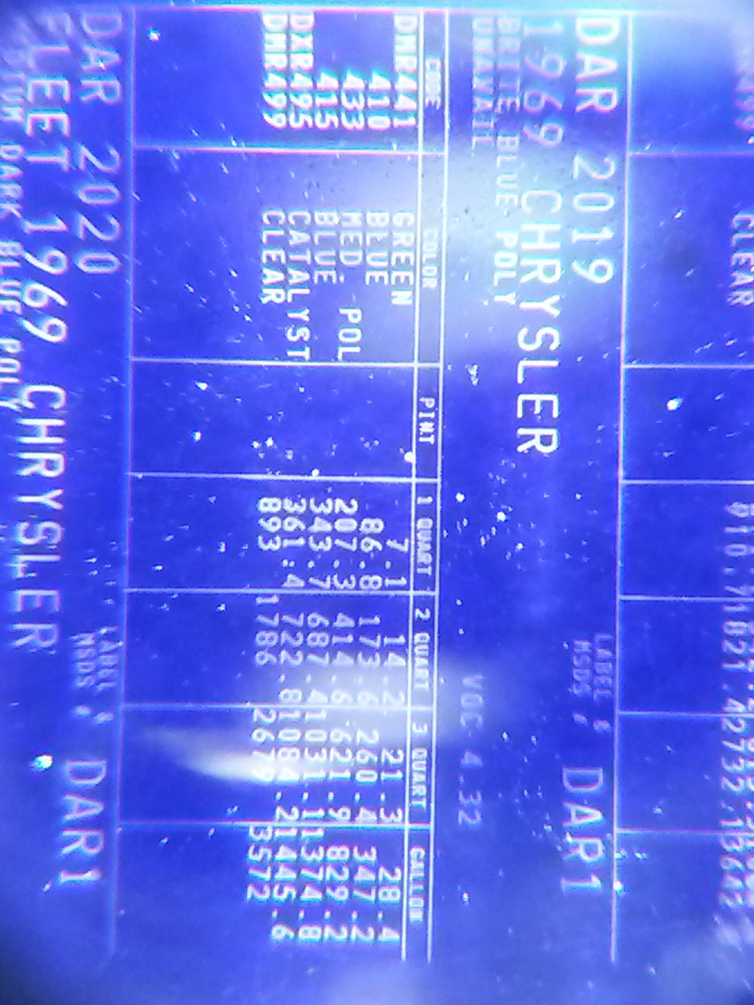

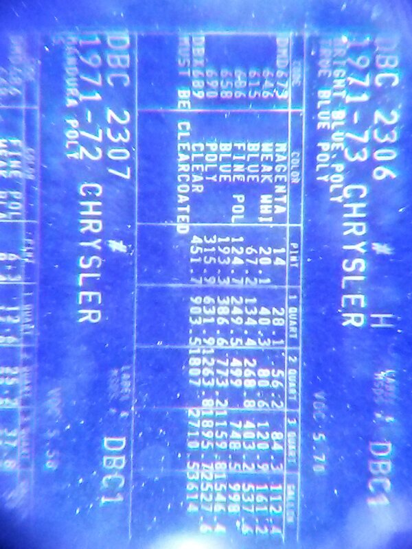

Here is the clear coat formula for 2304 and 2306. if I recall the 71 blue had more poly not sure if it had less blue. I think 1970 was 2305 or 2019 still looking. the micro film is old and degrading.
2019 2306

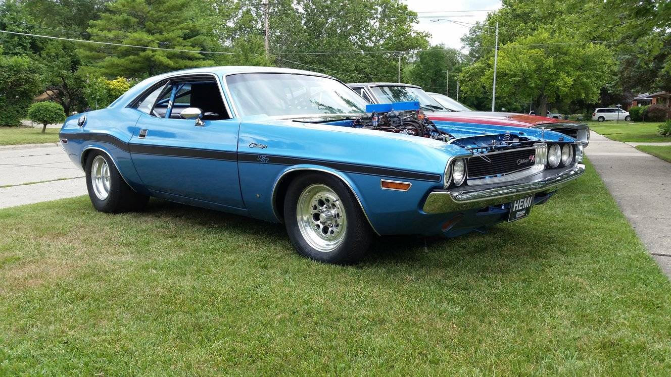

I will have to look at the label on my paint can. It has the formula on the can from when we painted my car.
