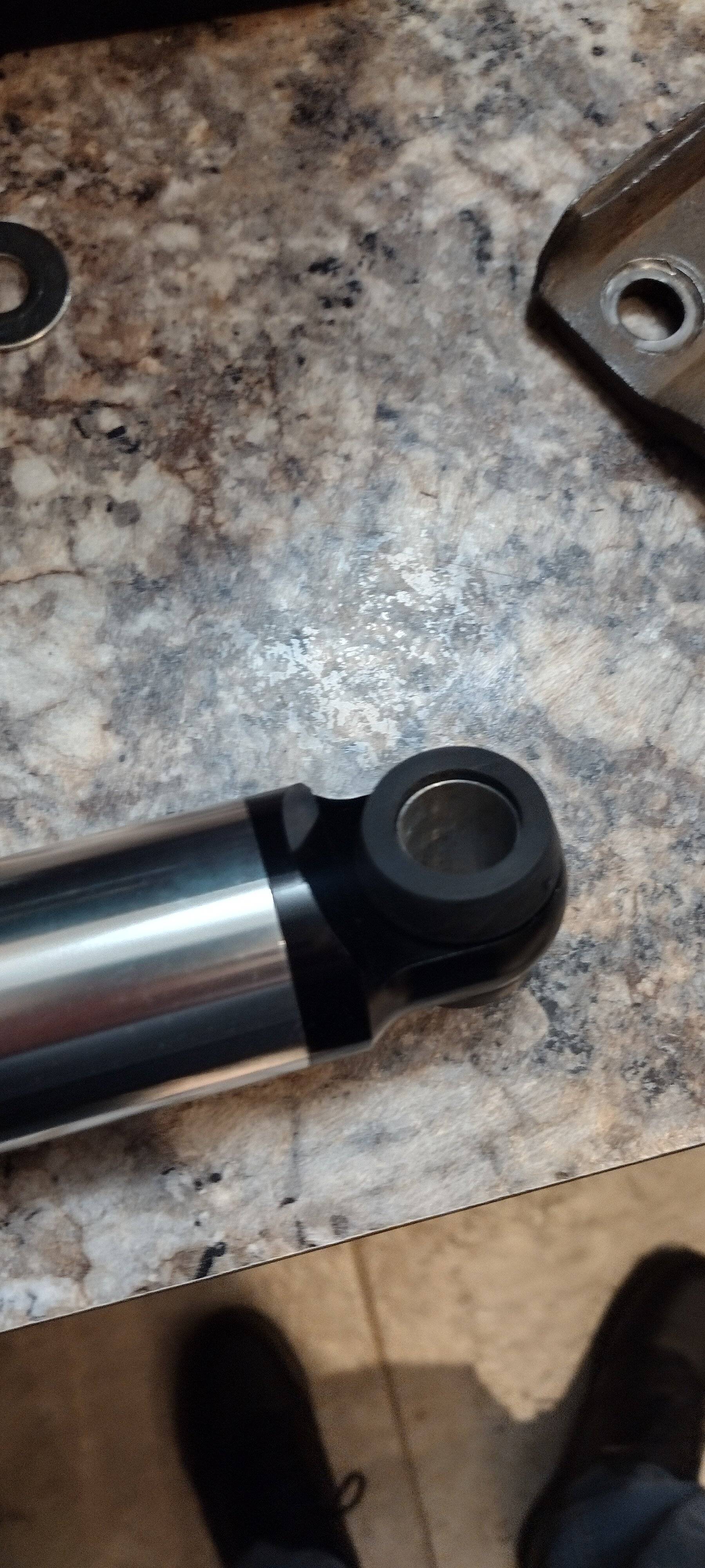

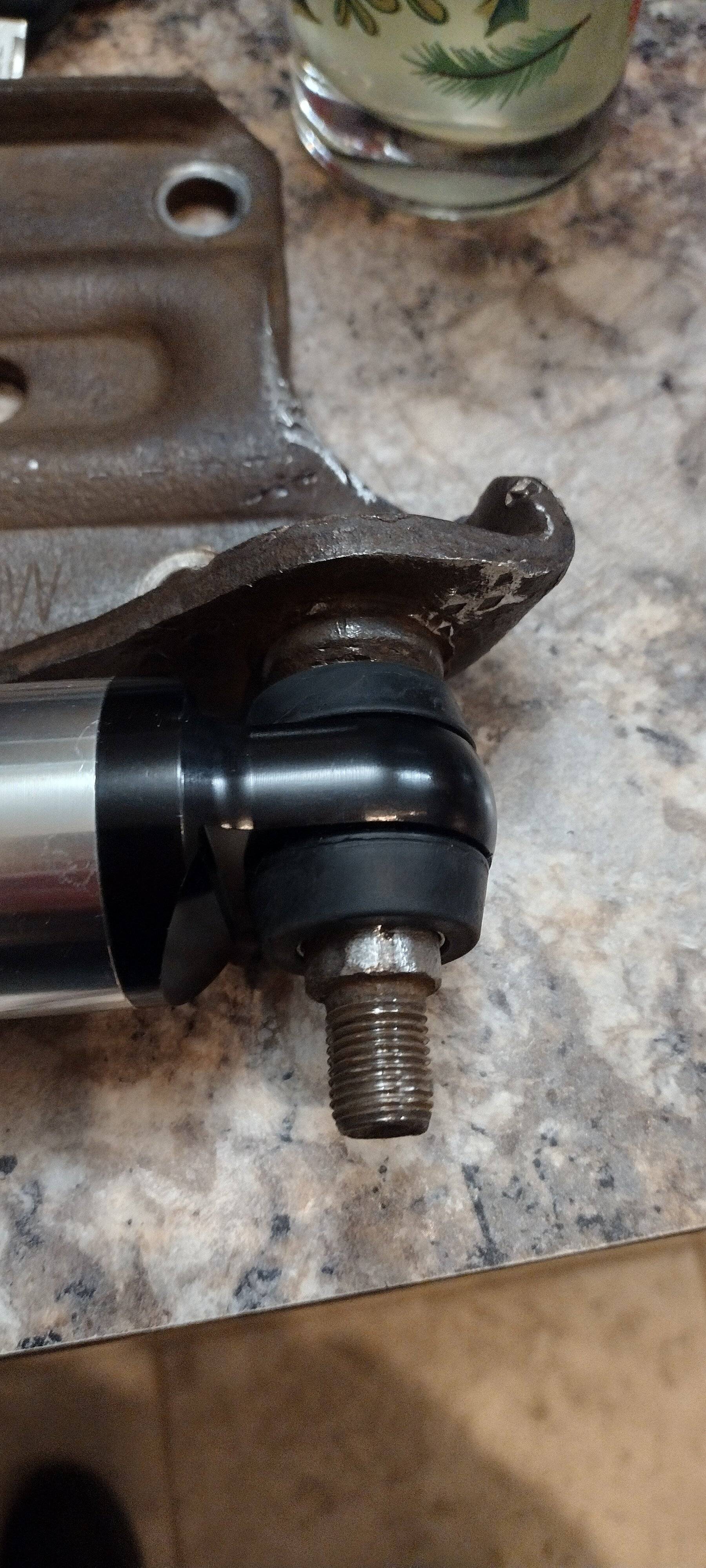

Got these QA1 non adjustables as an upgrade for my challenger and of course, I can't just simply replace my old ones with these without scratching my head for a while so I have to ask if anyone has mounted these and how you may have solved this issue or any suggestions on what I can do. The shock has a very thin sleeve in the bushing which is slightly shorter than the bushing itself I called the tech support and they seem to have no clue as to why they don't interchange but as the pics show, the bushing is way too short to compress on the stud and the original cup washers don't take up the slack either. All I can come up with is shimming it with flat washers, which will take 3-4 or more to compress the bushing only and the sleeve slides thru the washer itself. Nothing like spending several hundred dollars to find out aftermarket crap don't work. I hate rigging stuff to make up for unnecessary fitment issues. These are the correct shocks for the car so now I'm stuck figuring this out when it's like a 20 minute job turning into another day with no real solution. Hope someone can help.

Ok everyone. For the record, after wasting many hours and researching this issue, the lower plate has to be drilled out and you have to buy qa1 7888-108 shock mount bolt. Why couldn't the qa1 tech just tell me that? Apparently because they don't know.
