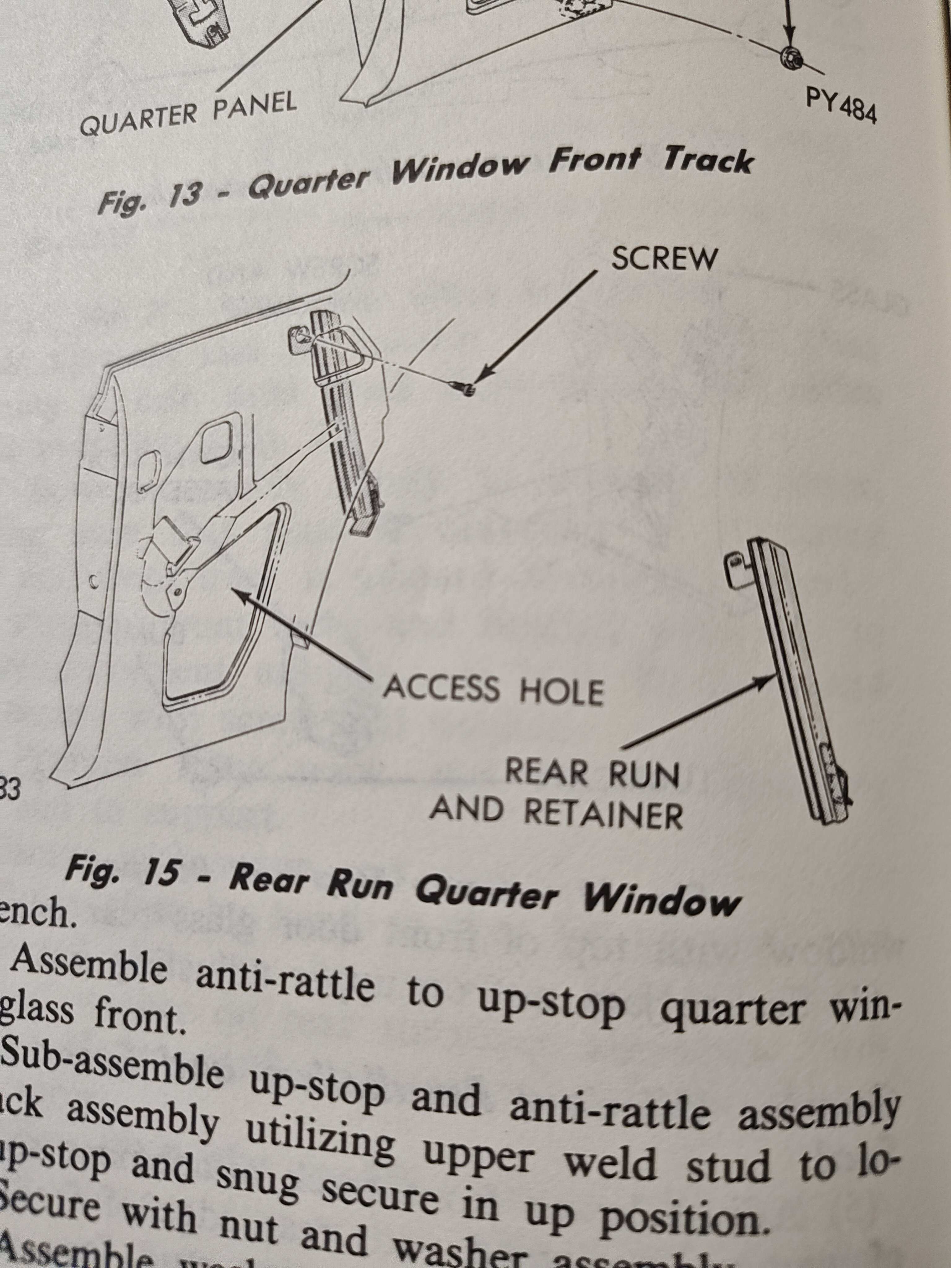

Do the attached pictures from the Body Service Manual help? Looks like they attach on a bracket and with one screw.

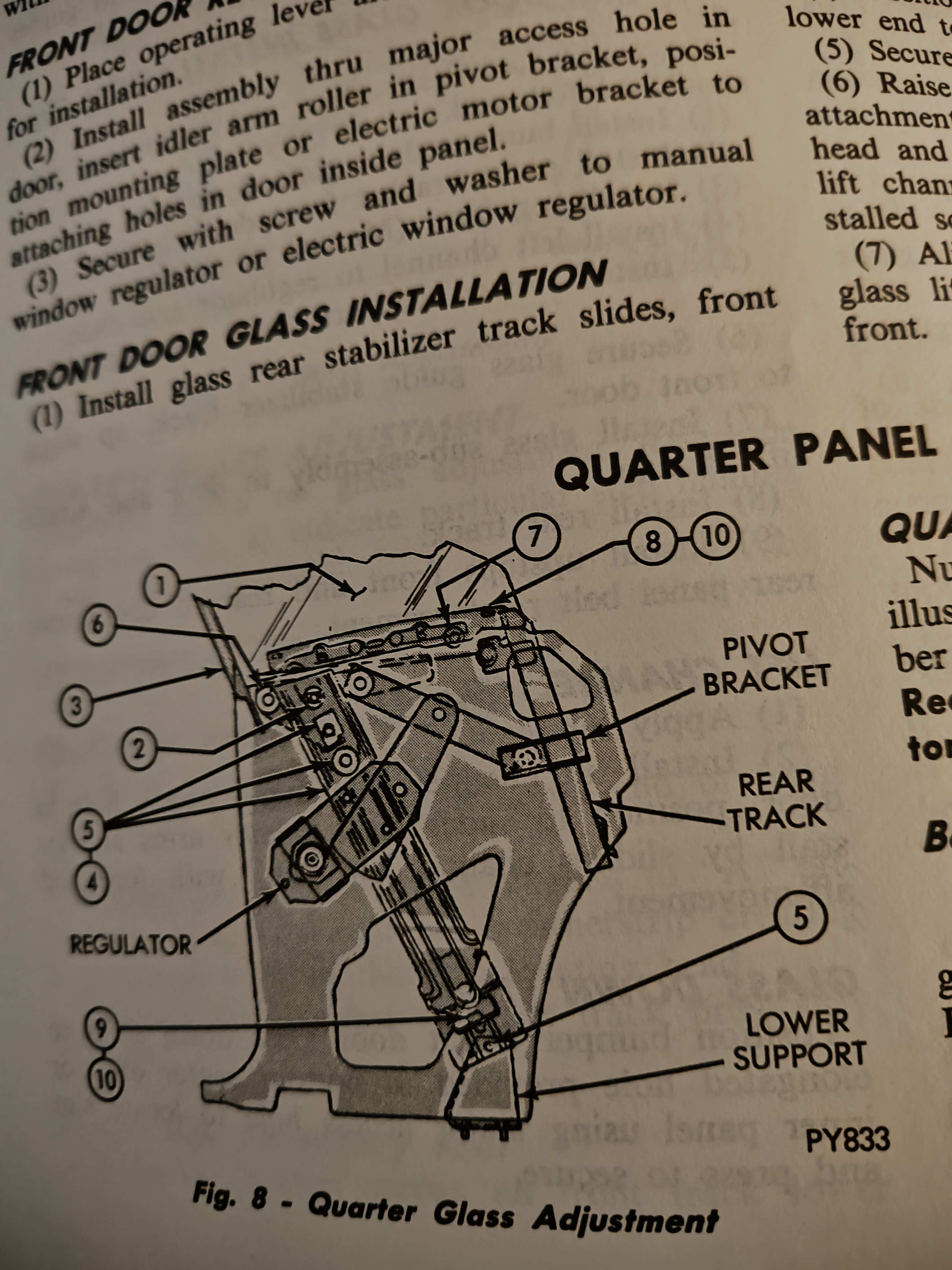

Challenger RTA, you always have pictures! The "quarter window track" hole is where the screw for the rail goes I think.

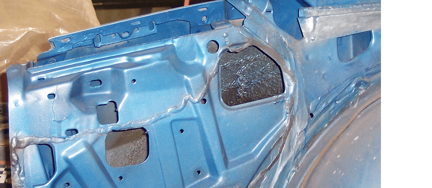

The first one is a 70. This one is 71 . There might be a difference. by the way this is how the rope caulk was installed for the air shield.
