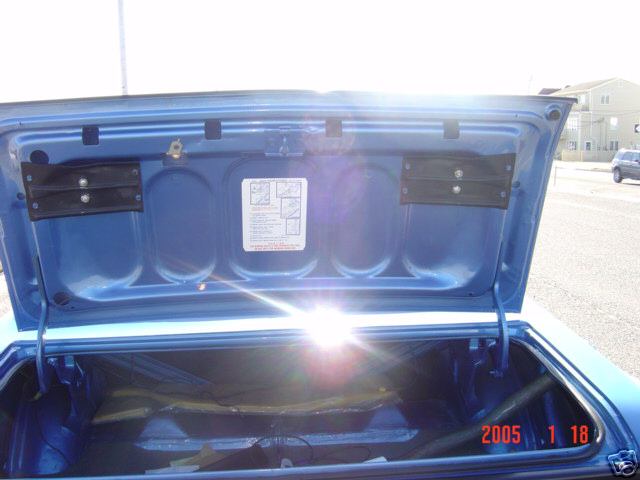

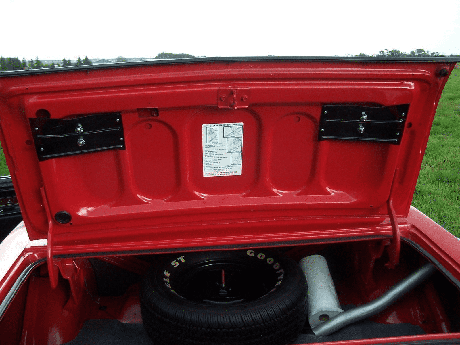

I was looking at a Challenger and the mount brackets under rear deck lid didnt quite look right to me. I know they are black but the shape and size looked wrong to me. Can anyone post a pic showing the underside of the deck lid for the view of the mounting brackets for me to see please?

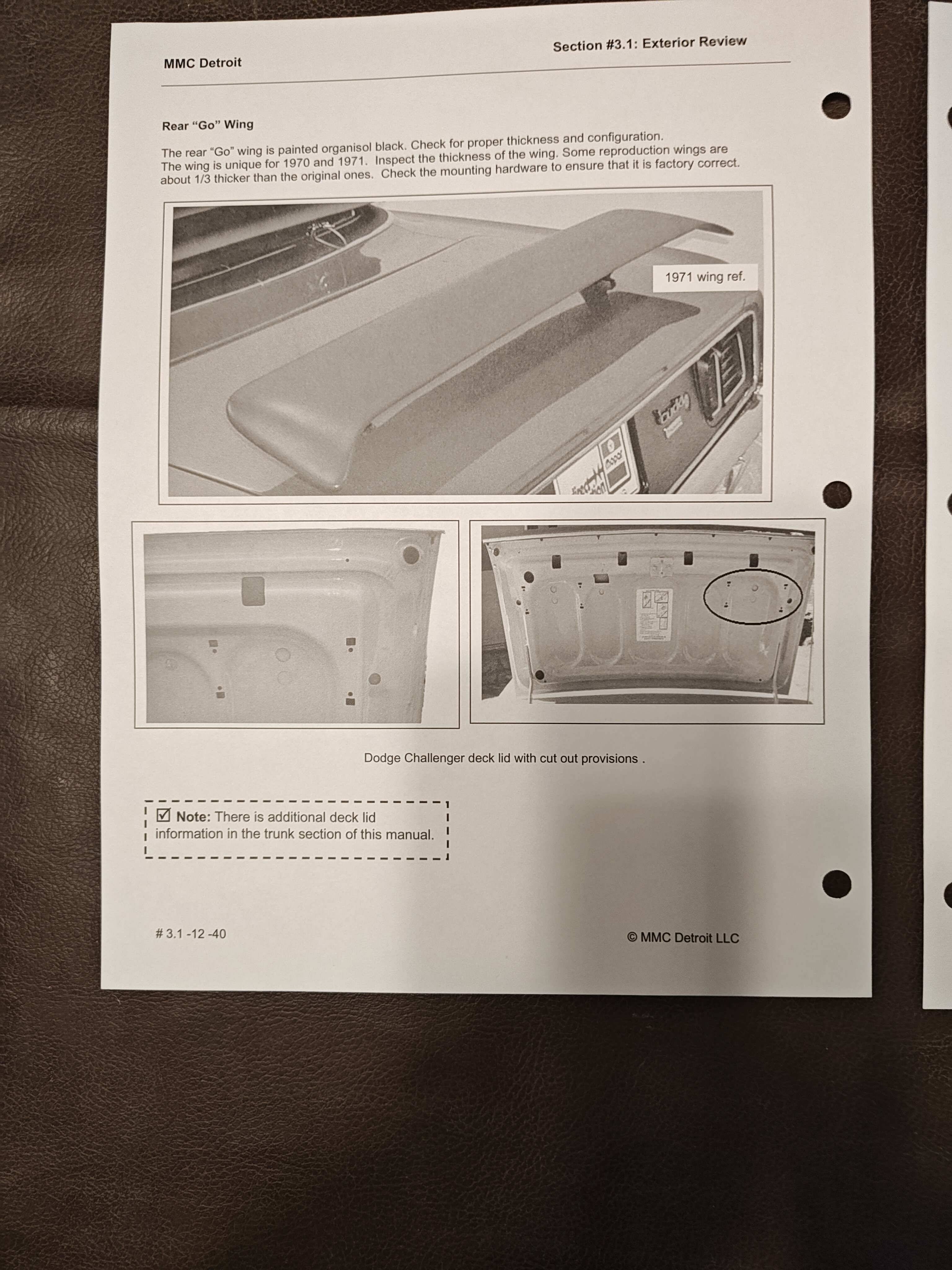

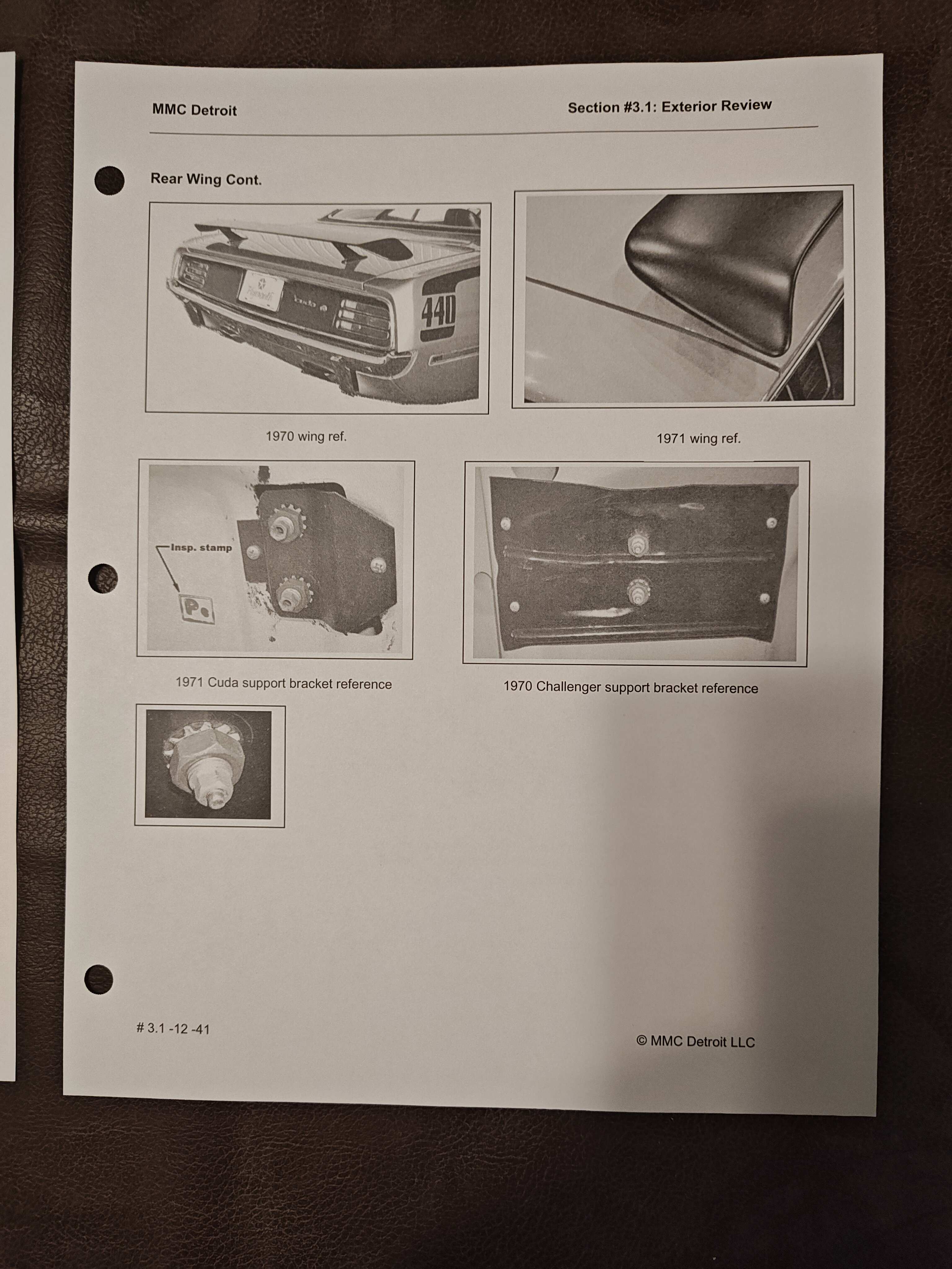

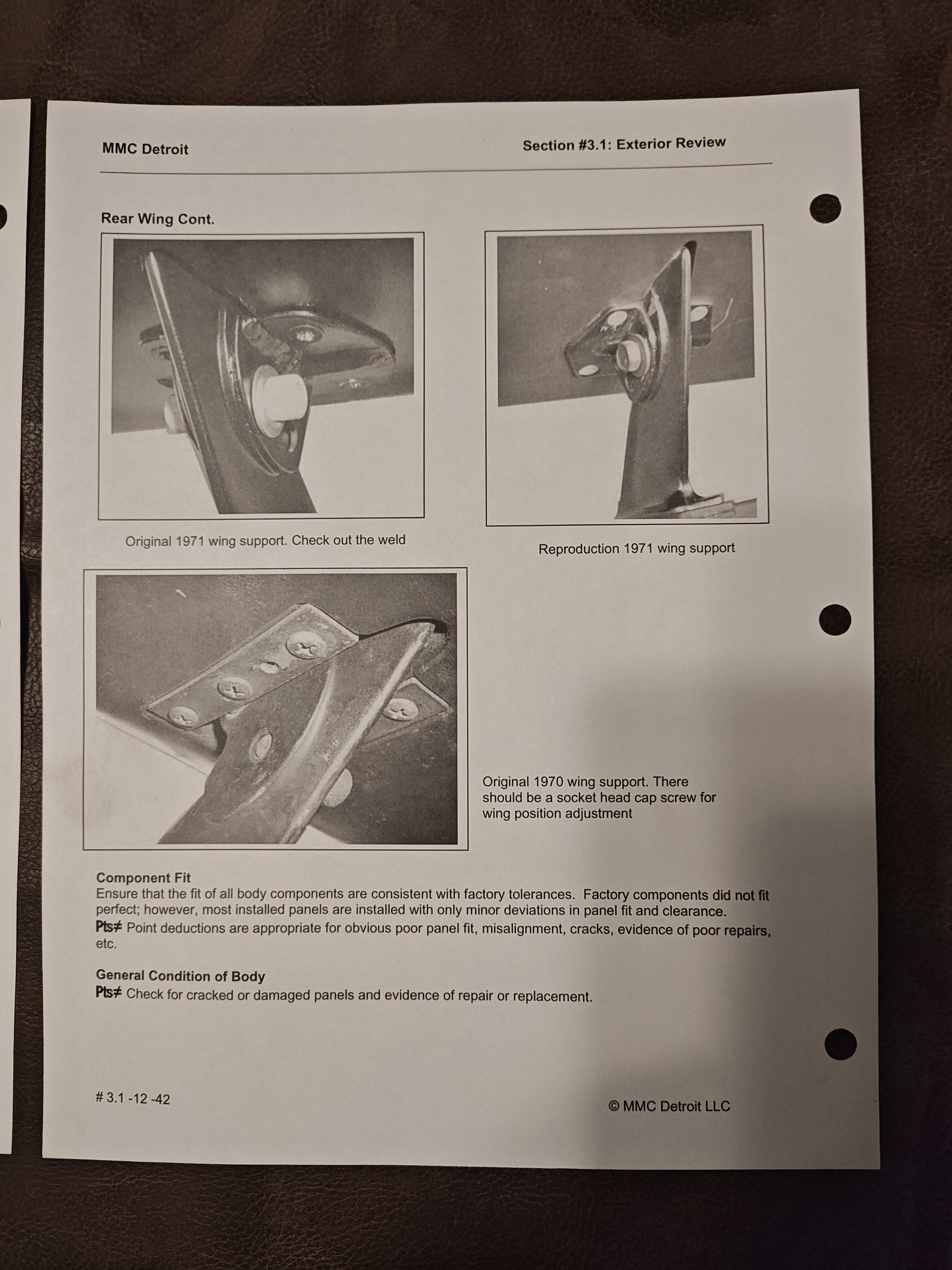

Does this help? Challenger RTA probably has pictures of actual cars, if he sees this post.

Thanks "X'. That helps a lot. Just what I thought. I seen a 71 with 70 support brackets. I knew something didnt look right.
