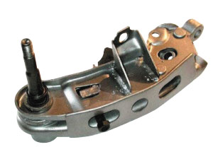

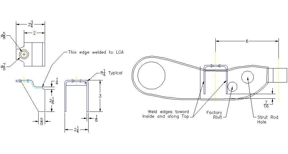

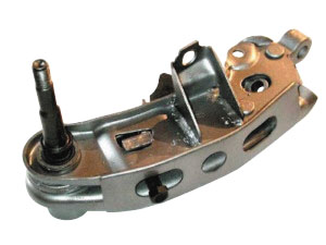

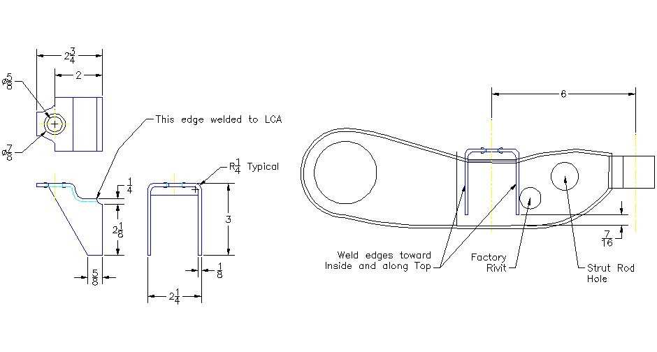

Lower control arms. I have extensively cleaned one, and am debating whether to install stiffeners, and perches for a sway bar, which I may or may not get.
My concern with the perches is having them be lined up correctly....would it not make more sense to weld them on with a sway bar in hand for proper fitment?

I recently purchased new T-bars for my project, 1.03" is basically the standard offering now, you won't have any regrets using them. My brother also has them on his 70 R/T and the car goes down the road really nicely. Definitely add the lower control arm reinforcement plates, and a front sway bar, and while you're at it also a rear bar. The factory one works decently although the aftermarket also offers one that mounts below the rear axle that is actually a better design if you're not concerned with original appearance. Here's a diagram for the front sway bar tabs.
Thanks for an awesome post, especially the drawings. I appreciate the 1.03 endorsement as well. My mission is to get the front suspension done first. Then pull the back end apart. I have new green bearings, and a separate 489 case holding 3.23s. Right now I have a 741 with 2.76s. Good idea about the rear tabs.

Hey man, I found this website in Prescott, AZ that makes all kinds of tabs, and sent them your drawing and photo to see if he has anything that is a match. www.tabzone.com
