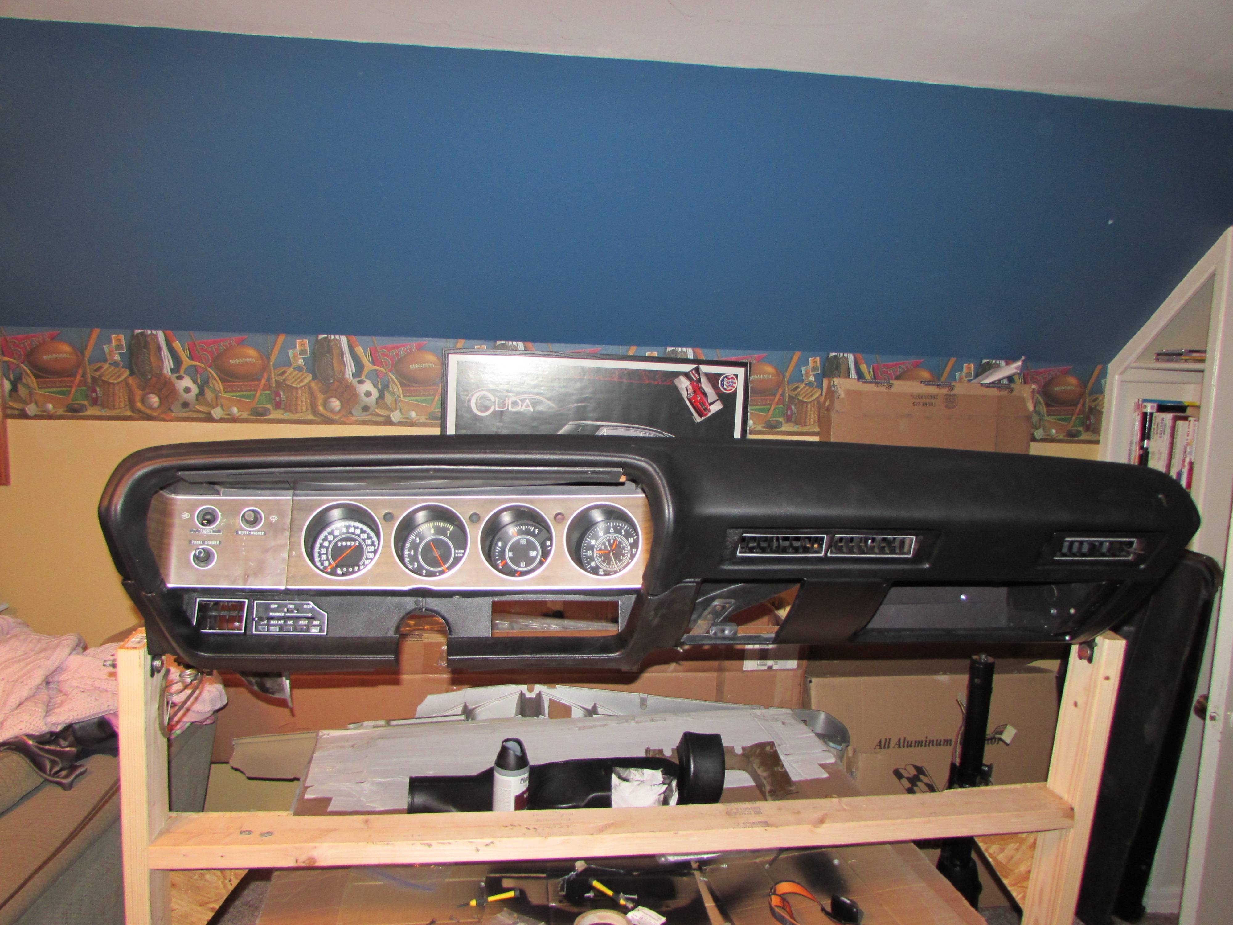

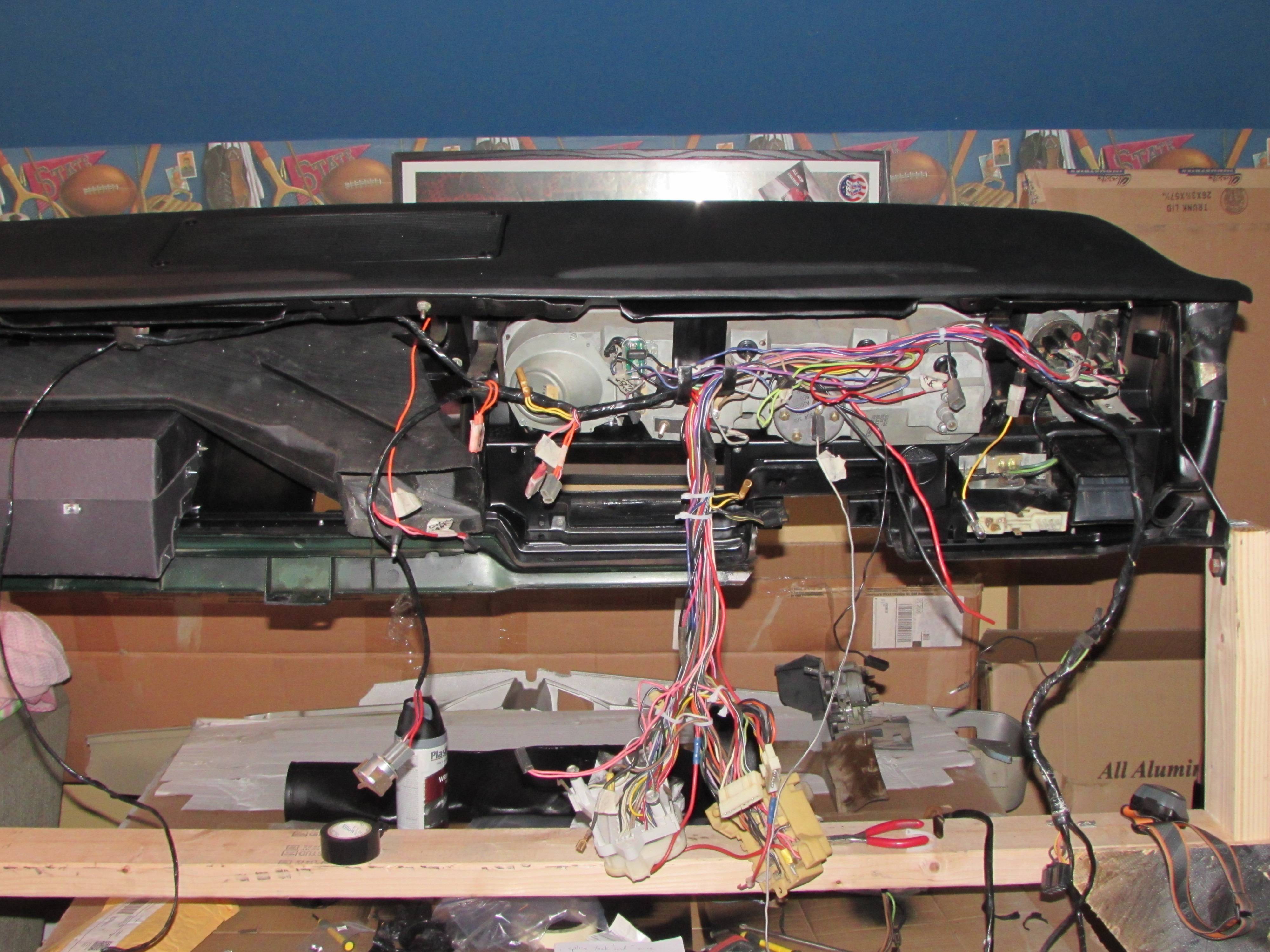

If you are doing this out of the car, I highly recommend making yourself a simple 2x4 stand to hold the dash. I did mine in an upstairs bedroom. Working inside sitting on a step stool is the bomb. Anyhow, I modified my existing wiring to do my conversion. You will need a tach wire, change the wires for the idiot lights, really simple stuff. I still have the three light standard bar in my dash as I just can't see spending several hundred dollars for a four light bar that came with the rallye dash.
I spent the money on the 4 light panel. Love the pictures. What did you have to do with the idiot wires for the dash?

I see you did the AMP to Volt Meter conversion as well? Is the A/C panel for standard dash? I got one for a rallye dash from vintage air.
