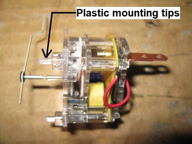

I've done 3 of the Quartz (R-3035) upgrades. if you go that route test the unit first, before doing anything. One of my new movements didn't work right out of the box. I temporarily put the second hand on the shaft to get a good look at it not turning. Be careful pressing on the new retaining clips, the housing's tips are only plastic.
As to why it won't adjust, I have no experience with '72+ styles. Maybe the shaft isn't depressing far enough. Once apart you'll get a better idea.

Thanks for the tips. I’ve ordered one of those kits to give it a try.

FYI, the quartz kit that's in my car was put in decades ago and still keeps perfect time. With that R-3035 kit the second hand is a constant sweep rather than the second by second incremental tick of the original clocks. I'm pretty sure the OER reproduction clock's second hand does the incremental movement. You can have that too for around $400.00 USD.

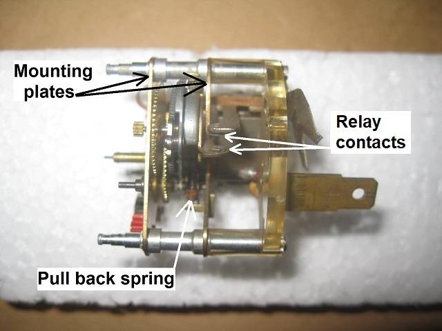

A friend of mine told me how to kick start an original clock. Take the clock out of dash, pull cover from same and spray lightly with WD-40. Connect directly to battery. This should jump start the clock. I did this about a year and a half ago and it has been working just fine.
pschlosser
Dec 8, 2022
681
263
Santa Rosa, California
There is a copper contact within the factory rallye clock that gets oxidized and stops working. After cleaning the contact, so the clock winds itself, and sets many clocks right, again.
EW1BH27
Dec 31, 2021
571
295
Canada
I've worked on the OE mechanisms before finally going quartz. Cleaning the contacts, spaying WD40 all worked for a while. Another thing to consider, is the small pull back spring too weak to overcome the friction and wear of the gear shafts that go through the mounting plates. That spring tension is critical to maintain correct time, it's what causes everything to go into motion. Then the tabs can be bent, to open up the clock, only a few times before they break off. Just sharing some of my experience.
