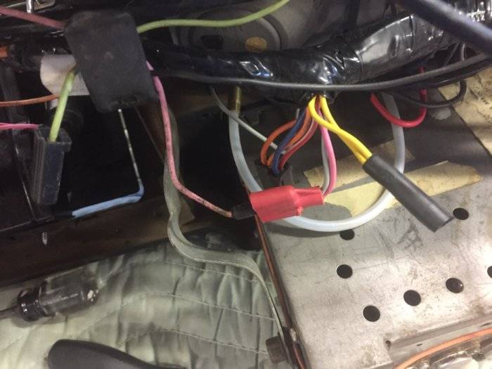

I am trying to reassemble my ‘70 Rallye dash and seem to have extra connectors that I don’t know what to do with. I’ve included some pics of what I am down to. Also it’s a SE car so I have no idea where the wiring is that goes to the low fuel sender. Any help or leads on information is appreciated. Yes it does have a three speaker harness in it too.

1st Picture:
The T green and dark green connects to the heater box for the fan.
The 45 degree green and black is part of a sub harness for a three speaker dash and connects to the left speaker.

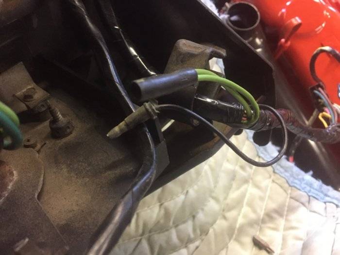

2nd Picture:
Double yellow female socket ground feed to A01 light package map light and key light.
Triple red female socket is battery power for the glove box switch and A01 light package sub harness.

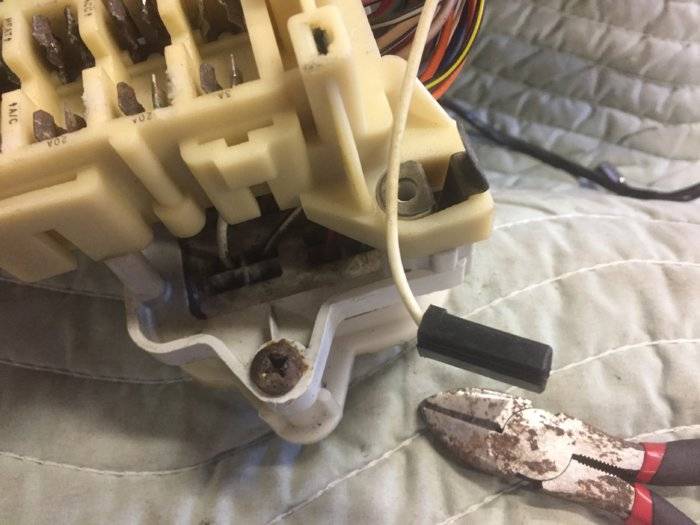

3rd Picture:
Dual pink single female connector is for on side of the brake light switch.
Two tan wires with three female sockets each are for accessory power.
Double yellow w/ black tracer are triggered grounds for the A01 time delay relay.

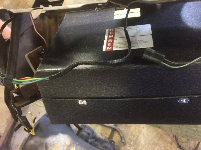

4th Picture:
White single female connector is for the other side of the brake light switch.

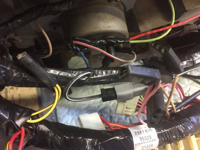

5th Picture:
Black male connector is for the emergency switch.
Dual green female connector is for the option headlight on delay relay.
With an SE or GC car, there is a sub harness to connect your low fuel relay. You may have to go digging to find that one is your parts were stored. That sub harness will have the odd shaped four conductor connector to plug into the low fuel relay.

Jim- I am amazed! Thank you. I can now stop pulling my hair out!
