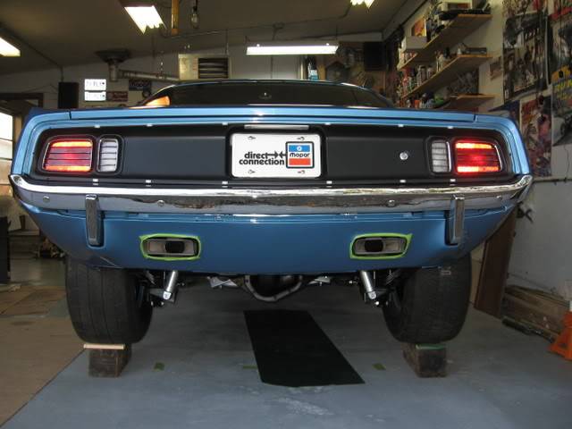

That's not uncommon. Mine was offset to the passenger also. I centered it when I put the dana in.

71plym beautiful car! What Dana are you running under there? Looks like a B body with some 3/4" off set shackle/perches. The fit really looks nice.
