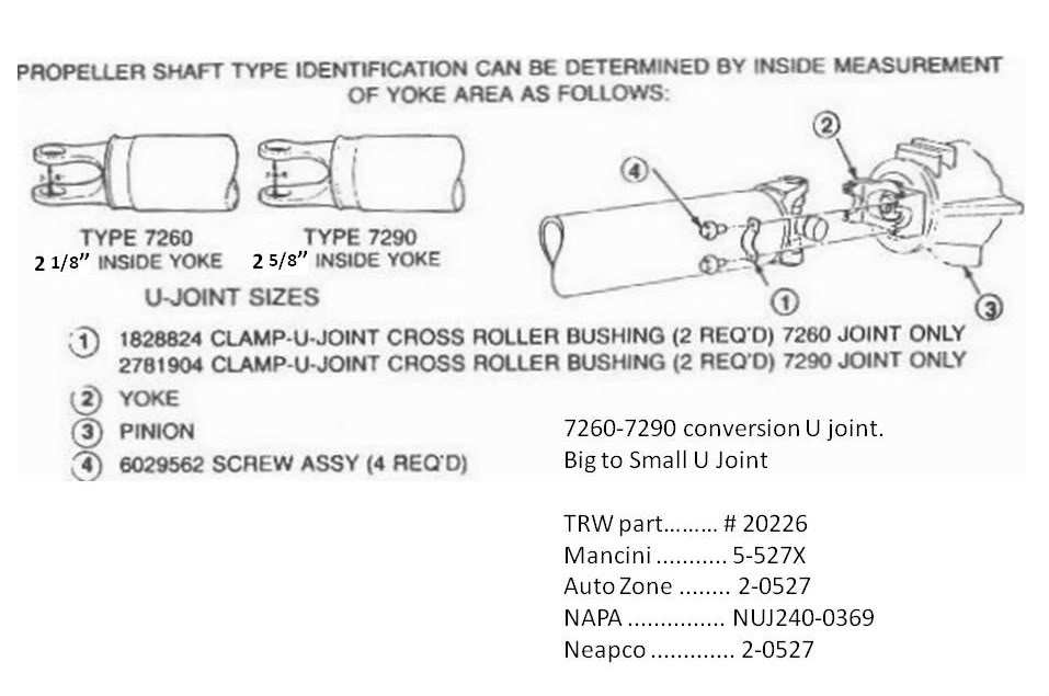

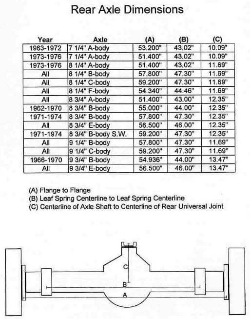

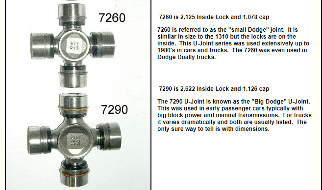

Rear Differential:
To be clear, the 8-3/4" rear differential also known as a "chunk" or a carrier with a 741, 742, or 489 case will fit your existing rear axle housing and will work with your 1973 E-Body rear axles.
The rear axle spline counts are the same.
Rear Axle Housing & Shafts:
The 1970 Charger (B-Body ) 8-3/4" rear axle housing is ~55.000" wide which is 1.5" narrower than an E-Body 8-3/4" housing (~56.500").
The axles themselves from a 70 Charger 8-3/4" rear will NOT fit a 1973 E-Body 8-3/4".
1970 B-Body axle shaft length 29-3/16" (narrower than E-Body).
1970-74 E-Body axle shaft length 29-31/32".
Factory axle shafts are 30-spline for all 8-3/4" Rear Differentials/Housings.
@Ricks72Chlgr440 is correct for your differential question and yoke verification (see U-joint chart below).
Just want to make sure others understand the axles themselves differ in length.
SOURCE:
Mopar Action magazine Tech Archive on moparts.com

Yes, any of the 8-3/4" differentials (carriers) will work in your 1973 Cuda's 8-3/4" housing.
The axles are all the same spline count. Only the length of the axles changes to match the housing width.
The driveshaft length should not change. The U-Joint and yoke combination can vary so read the below and just measure your current U-joint and the yoke of the Charger 489 carrier you plan to use. Hopefully, you will not need a 7260/7290 conversion U-joint at all.
Info below pasted from the Guide to the Chrysler 8-3/4″ by Gary Lewallen, January 1998 LINK
There are four different yokes that have been used with the 8-3/4″ axle for the ‘7260’ and ‘7290’ style universal joints. The ‘741’/’742′ assemblies used a coarse spline (10 splines) drive pinion. Most of the aftermarket gears also use this coarse spline yoke mount. There is a small yoke for the ‘7260’ and a larger one for the ‘7290’. The ‘489’ assembly used a fine spline (29 splines) yoke. Note: during the phase-in period of 69-71 for the ‘489’ unit, there were several permutations of pinion size and yoke availability. 69-70 ‘489’ units may be equipped with a coarse (10) spline pinion, particularly for the ‘7290’. There are two yokes for the ‘7260’ and ‘7290’ universal joints with fine (29) splines.
Interchange Notes:
7260 & 7290 yokes may be interchanged if the pinion spline count is the same.
