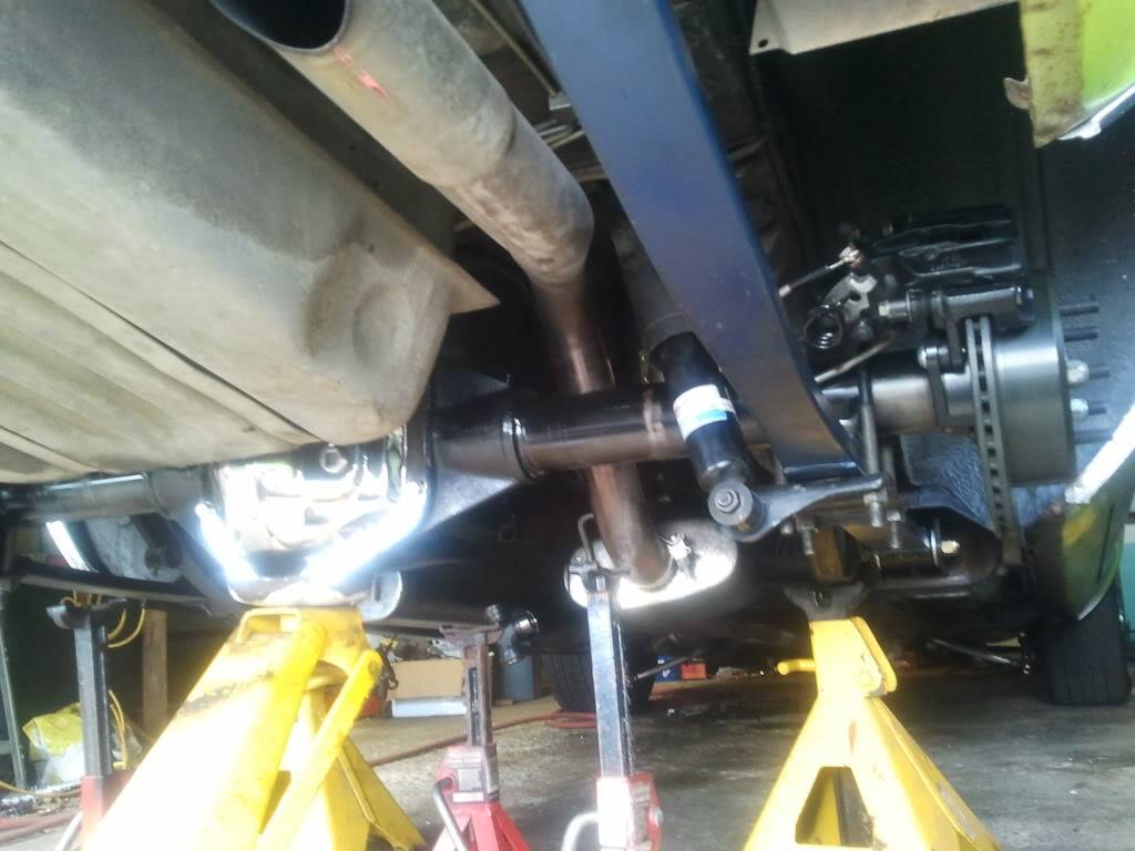

you have to watch the width or the rear calipers or they will hit the sway bar

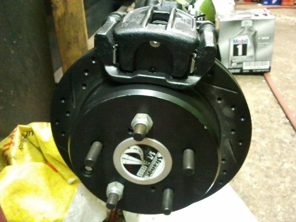

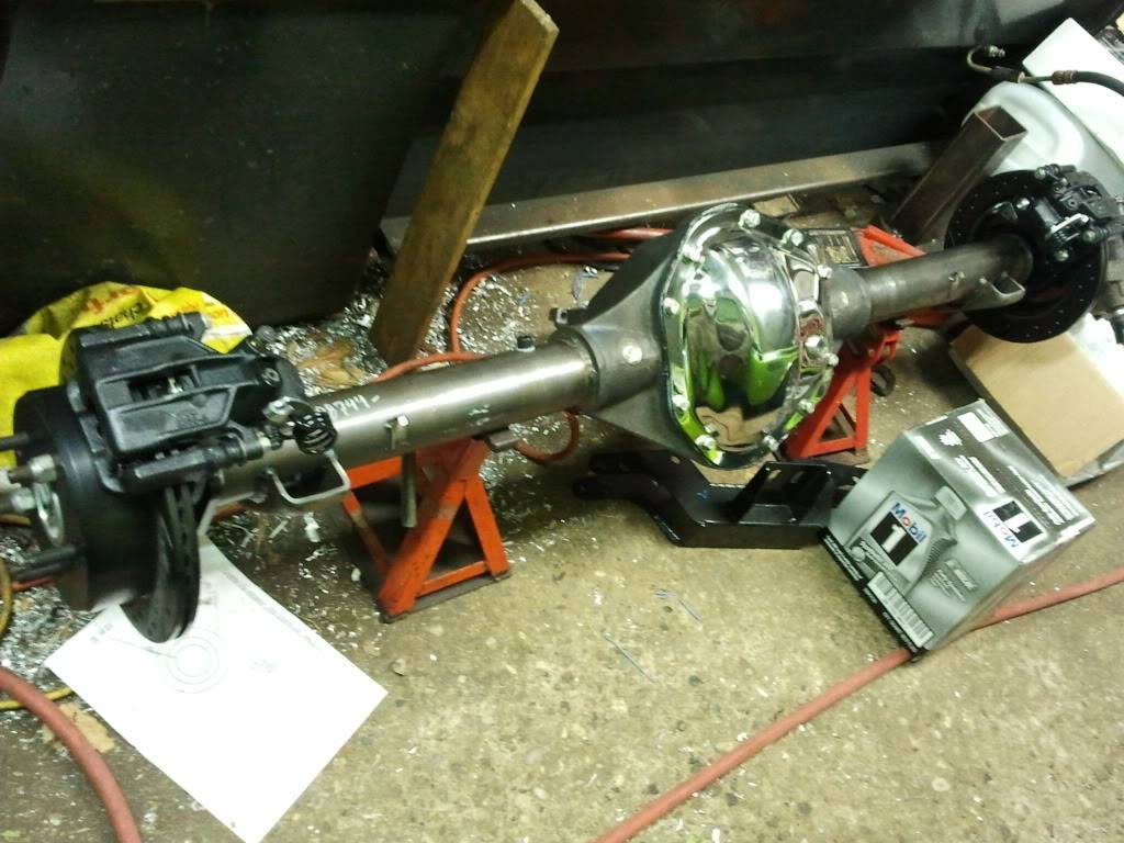

I just installed a new Dana and rear disc kit( 10.7") from DrDiff. They fit great!I'm using a Hotchkis rear sway bar. I haven't had them on the road yet as I'm still busy with a motor swap.
