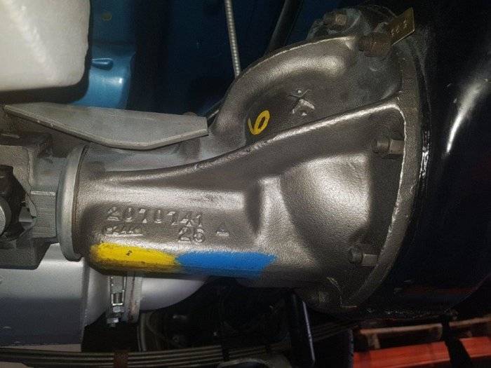

So I just found a guy who is selling an 8 3/4 posi rear end with 3.23 gears...in a 741 case. He's selling it for $600.
First of all, I know my Challenger has the 8 3/4 rear end. How can I verify that this will fit in my Challenger?
If I go look at this, how can I verify that they are indeed 3.23 gears and a 741 case? How about verifying that they are posi traction?
The last 3 numbers on the side will tell you eg: 741,742 & 489
Note not all gears are interchangeable between the models the pinions are different.
Note not all gears are interchangeable between the models the pinions are different.View attachment 45643
Thank You Austa, so basically I need to look at mine to see what housing number it is, and if it's a 741 I know it should be a match, correct? As far as telling what ratio the gears actually are, it it stamped somewhere that will allow me to tell if they're actually 3.23 gears?
The other chunks 742 , 489 will fit the 8.75 housing as long as the axles splines & drive is the same.
The ratio will be on the tag shown in the pic ,the best way to check is the ratio it should be stamped on the circumference of the crown gear.

That seems kind of steep for 3.23 in a 741 case unless it has been rebuilt or it can be proven to be bolt-in condition. I just replaced the 2.76 741 that was in my ‘71 with a 3.23 489 and it required no other mods, just took the old one out and put the new one in after I had it rebuilt.
To be honest I hope I like the 3.23 better after it gets some taller tires. I couldn’t imagine driving one of these with a 3.91 in it. I sometimes regret not rebuilding the 2.76 and reinstalling but it wasn’t a sure grip...
You would also need to verify what yoke you have on your car... 7260 vs. 7290. If you have a 489 case do not change the yoke. There is a crush sleeve that has to be replaced or the pinion nut will come loose and ruin the gears. You can change the yokes on a 741 and 742 case no problem, as long as they are the same spline (course vs fine). If there is a difference in yoke sizes you can just run a conversion joint, 7260x7290 and you're good to go. Moog makes one that is carried at most parts houses. On a street car I wouldn't be afraid of a conversion joint, but on a race car I would be... I have 275/60/15's on my T/A Challenger with 3.55s and an automatic and it drives down the road nice. Since you have a 4 speed there is no converter slippage like an auto car has. I have run every combination over the years and my favorite overall street gear is a 3.23 for an automatic car and a 3.55 for a stick car. I currently have 2.76s and a 30" tire on my 540 cu.in. max wedge car for street driving and it runs down the freeway at 80 MPH no problem. Going from a 3.91 to a 3.55 will only change your RPM on the road by about 250. Going from 3.91 to 3.23 will lower your RPM by about 500. Get all the ratios(2.76, 2.94, 3.23 and 3.55) and try them out, see which one you like. Only takes about an hour to change them out...
