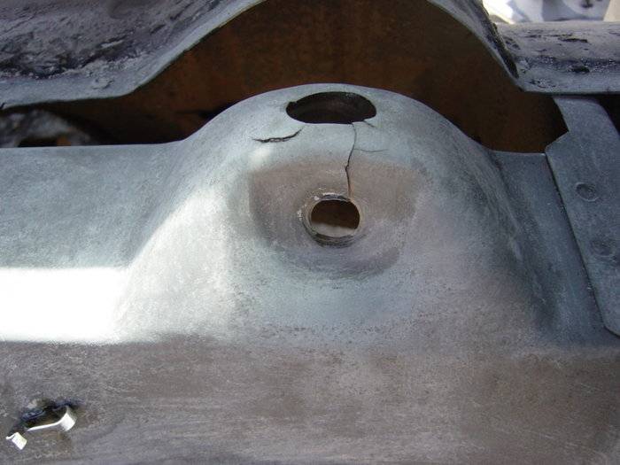

so I have owned a 72 challenger for 20 years the car came with air shocks in the back this winter I’m changing out springs and shocks pulled the shocks and found the upper mount hole facing the rear is seriously oversized,mushroomed,cracked.
My question is there any fix short of pulling crossmember and repairing/replacing and if so is it spot welded to the floor, I can see where it’s welded to the frame but not anywhere else due to undercoat.

The cross member is surprisingly thin. I don’t think it was ever intended to support the weight of the car.
It is not spot welded to the trunk floor. You may be able to weld it up through the shock hole, but I bet if you get underneath and feel the top and rear you will find more damage.

Yes, it is only welded to the frame rails. If it is really bad you could probably cut it flush with the frame rails and butt weld a new one into place, without hurting the trunk floor. Might even be able to drill out the spot welds from underneath and remove the whole thing... AMD makes a replacement for only $239; I would probably weld some reinforcements on the new piece before installing it, but I like a bit of overkill.

Adam, thanks for sharing those great pics.
Very helpful for many members!
Your advice on the cross member is right-on.
Back in the day, I bought a 71 Challenger vert 383 car for $500. Car look good.
Guy had put air shocks in and ripped the shock cross member up badly.
I took it my Dodge dealer and for $175, they welded a new one right in. It was 1975, hence the low price. Car rocked like a roller coaster all the way to the dealer. The good old days.
