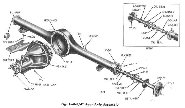

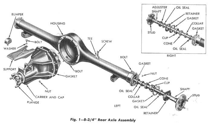

Looking at the diagram below, I see nothing stopping the rear end oil from getting to the axle bearings.
Perhaps so. It's been about 25 years since I've been into a rear axle. Regardless, the tapered bearings don't wear out too often. And if they do, not to hard to replace if you have a press available.
The tapered bearings do not get lubed by the differential lube. That seal closest to the axle housing in the diagram is inside of the bearing and seals the diff lube from the bearings outward. The bearings are hand packed with grease before installing on the axles and after that, you just get grease into them the best you can when the axle is out. Needle tip on a grease gun is probably the best way.
