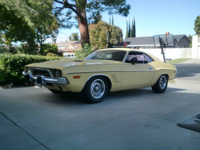

I am running stock suspension w/ 15x7 Rallyes. I have 275 60 in the rear and 225 up front. cudangle.jpgcudarearwheel.jpg
