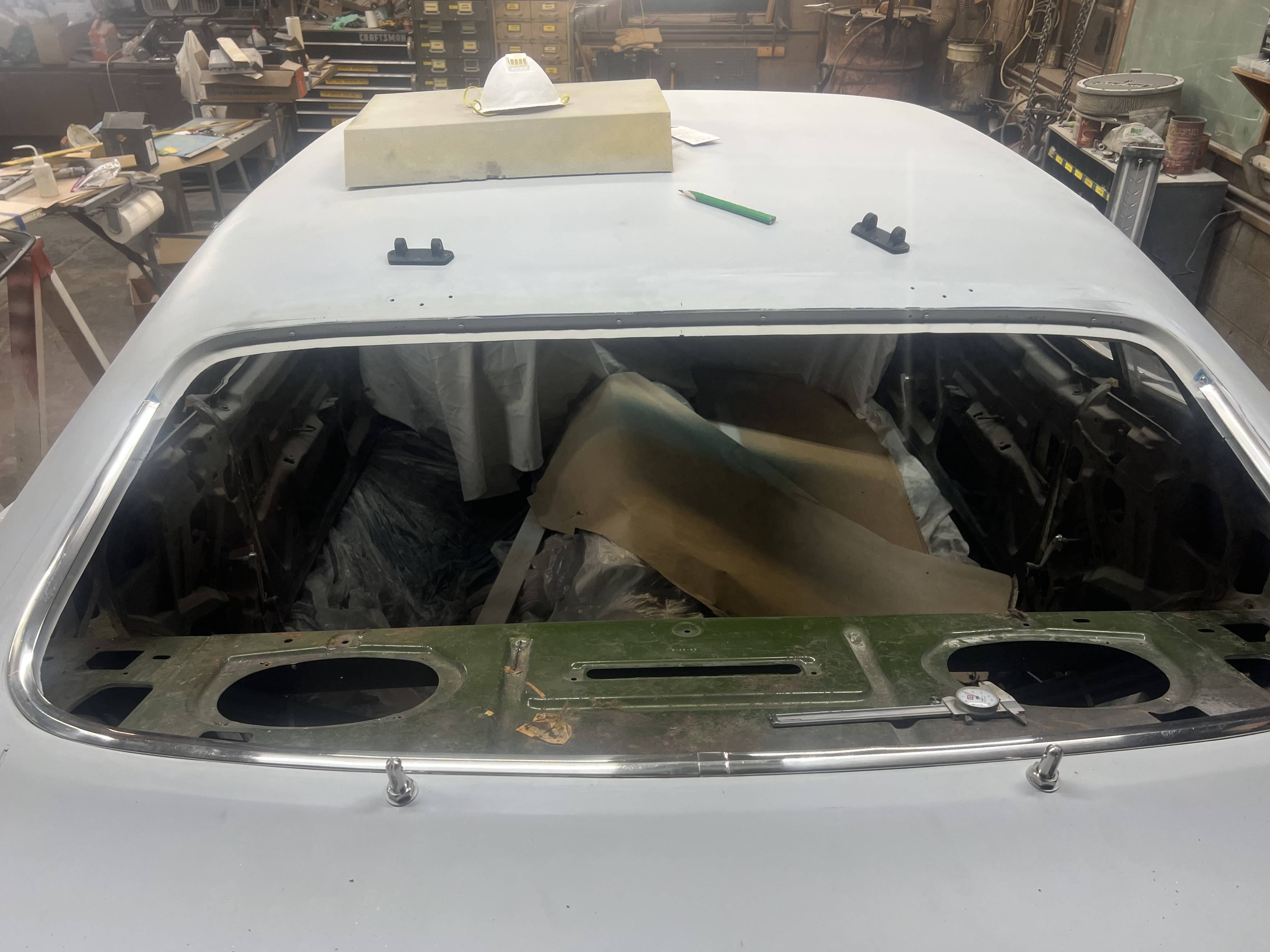

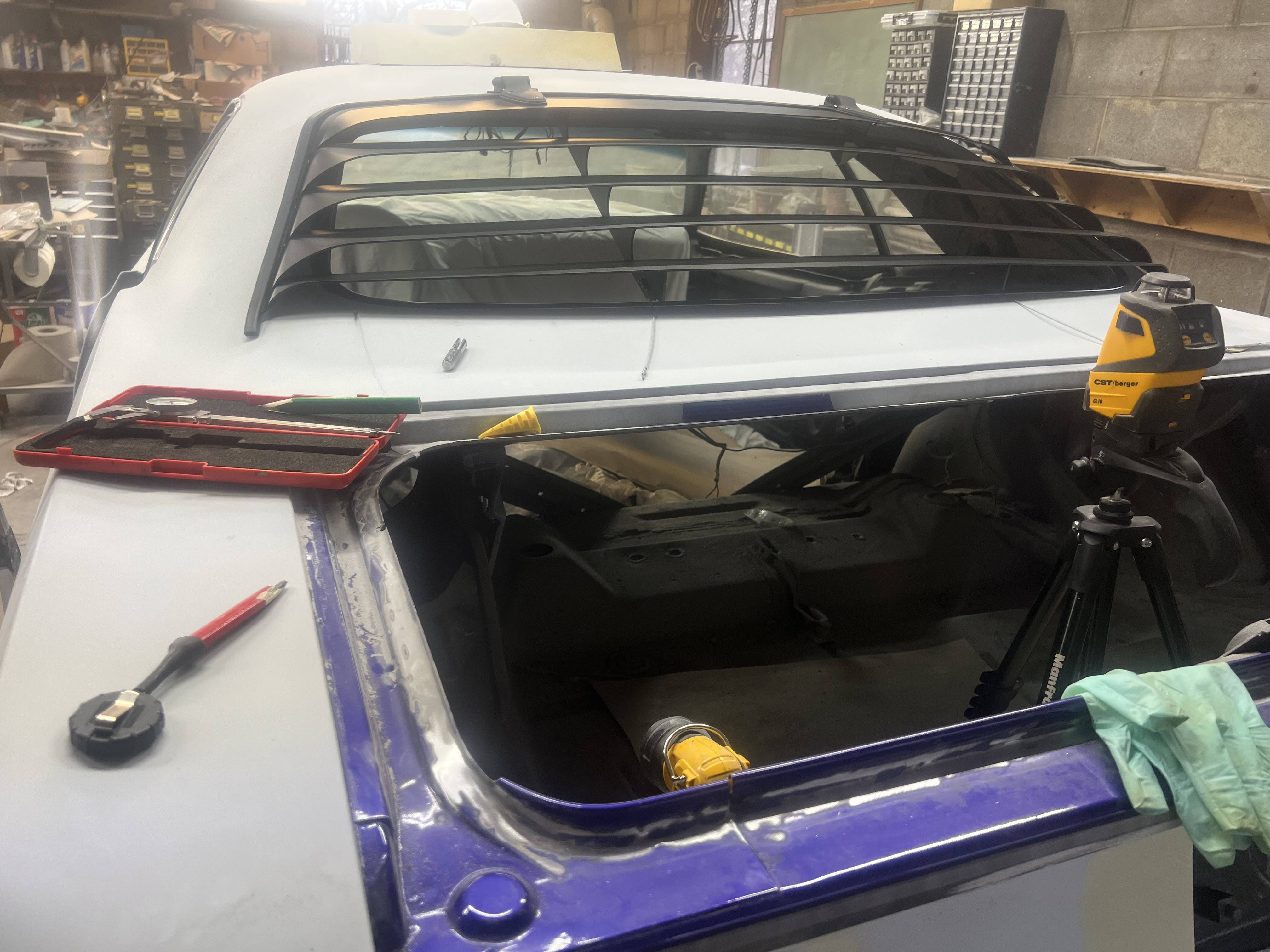

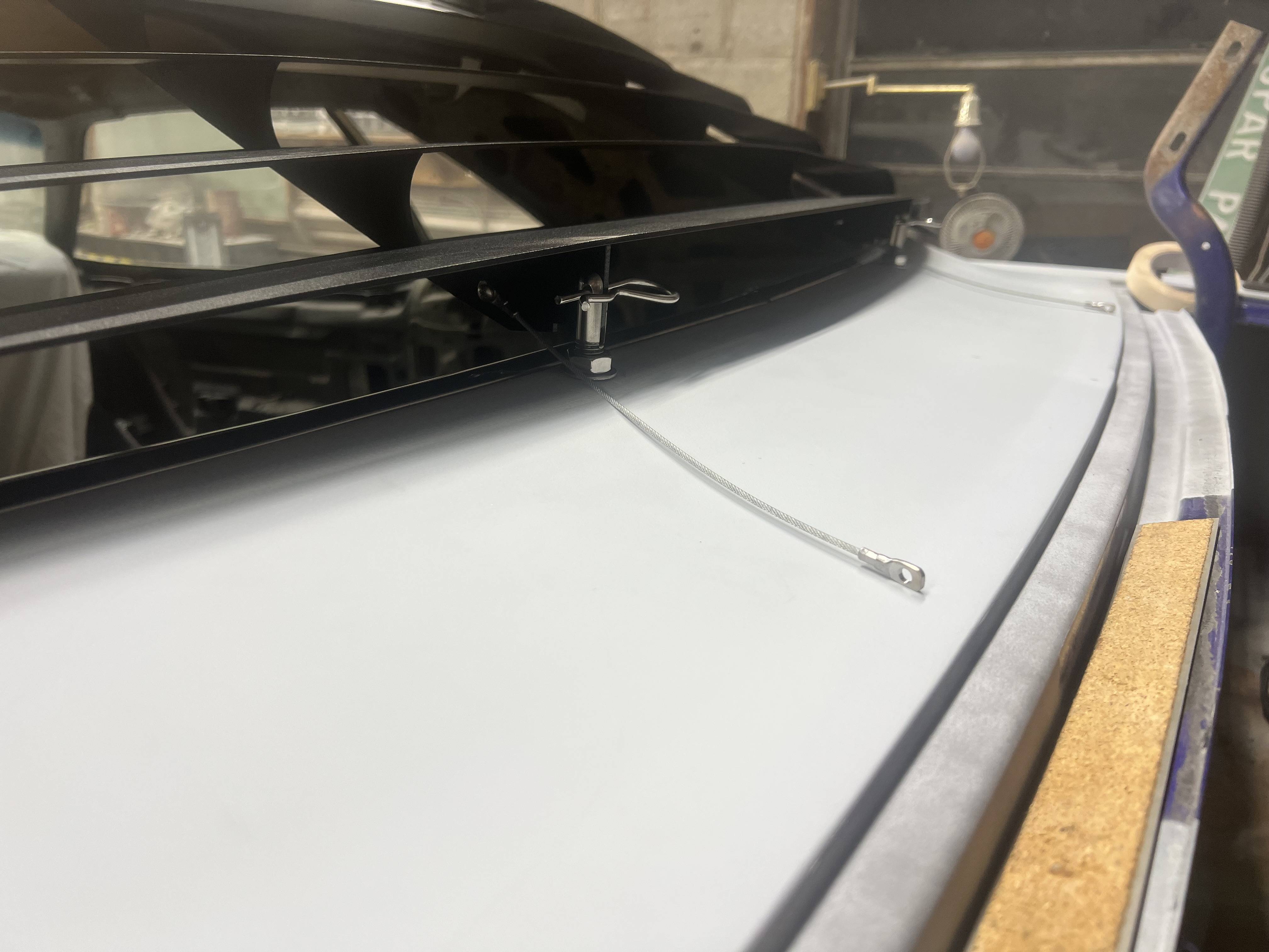

Installed the Dales Cuda Shop rear window Louver. Although it fits like garbage install wasn't too bad. helps if you have rear window out.
Advise for anybody who is doing it.

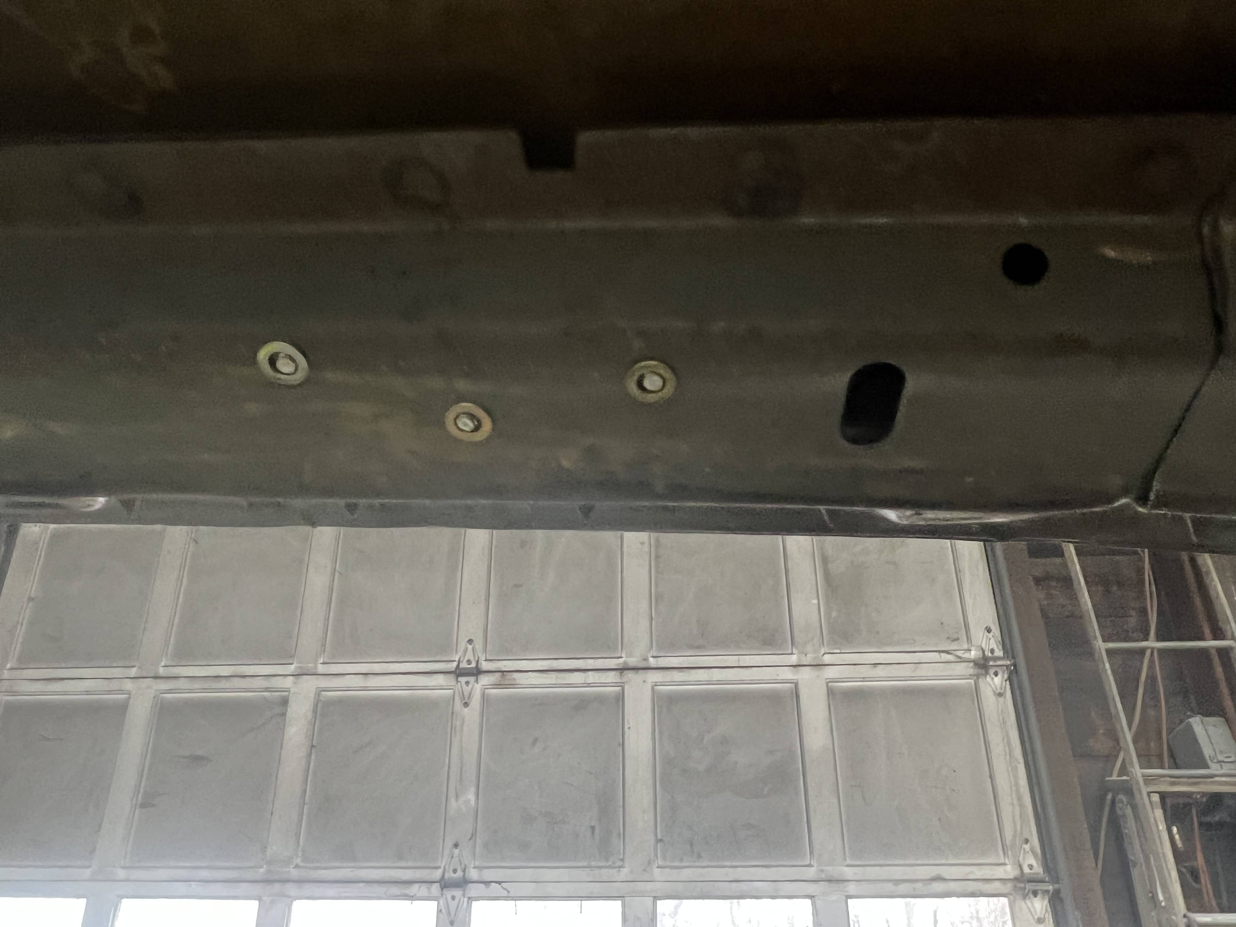

1) cheap amazon NutZerts work really good in that header panel for securing the hinge screws. The guy on youtube cut a big hole in it for some reason, but these cheap nutzerts worked really slick

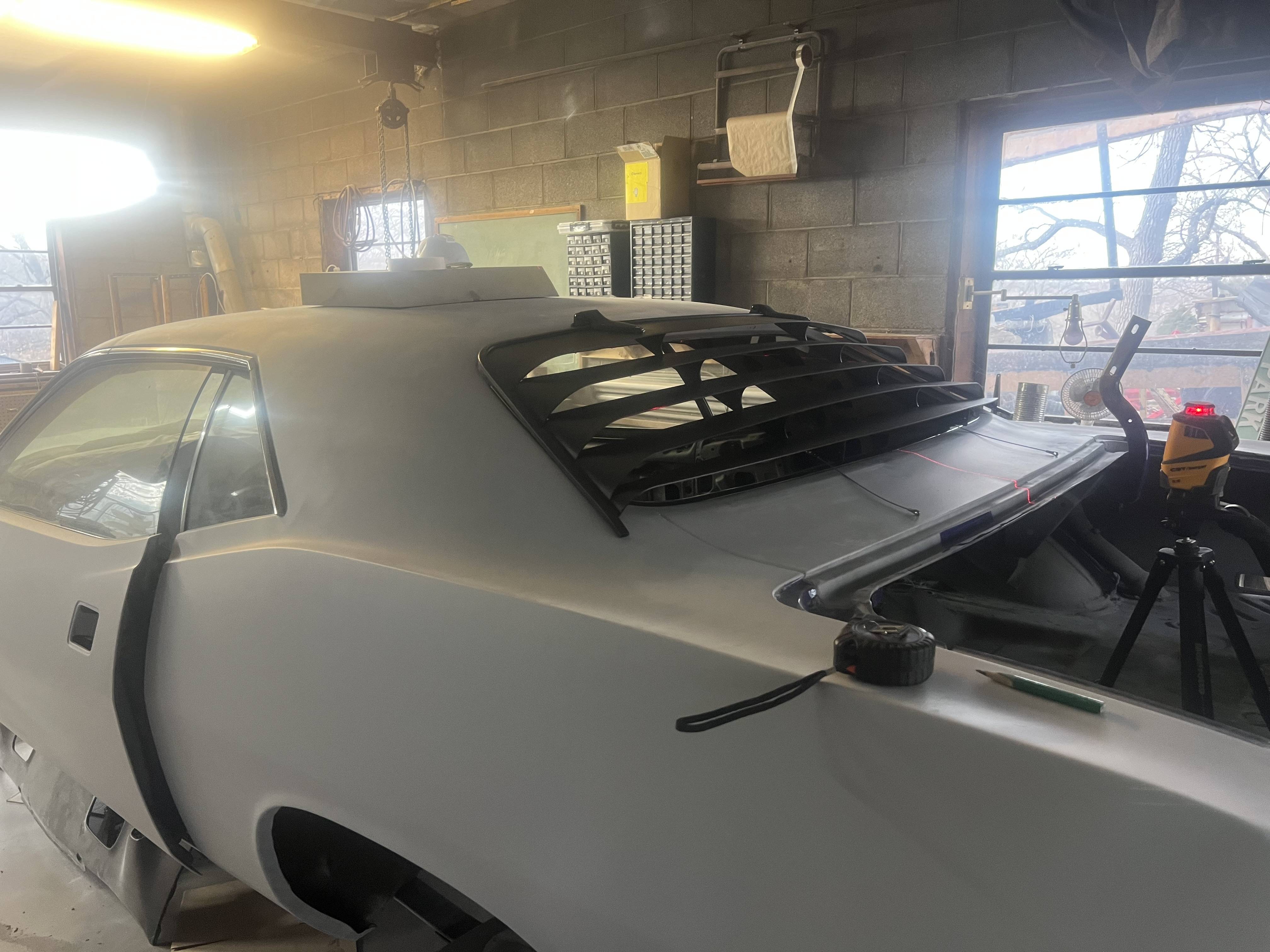

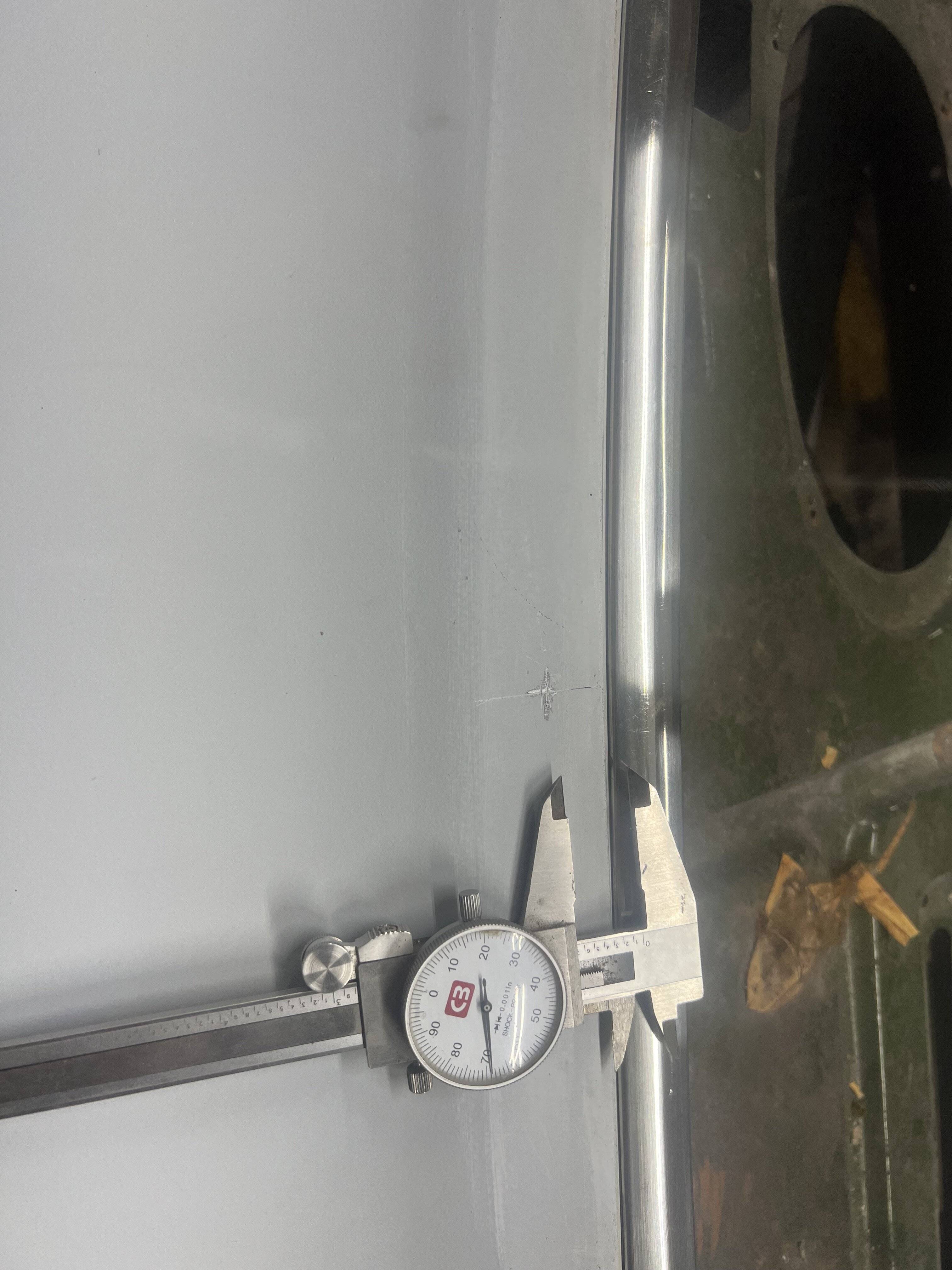

2) also the guy on youtube did this find center and then measure out 10" stuff. i tried that, but saw too much opportunity for error stack. So i just centered it on the car. i measured from quater panel top edge and from quarter to Dutchman panel seam they both agreed where center was.
if anybody is doing it feel free to reach out to me i would be glad to share more.
