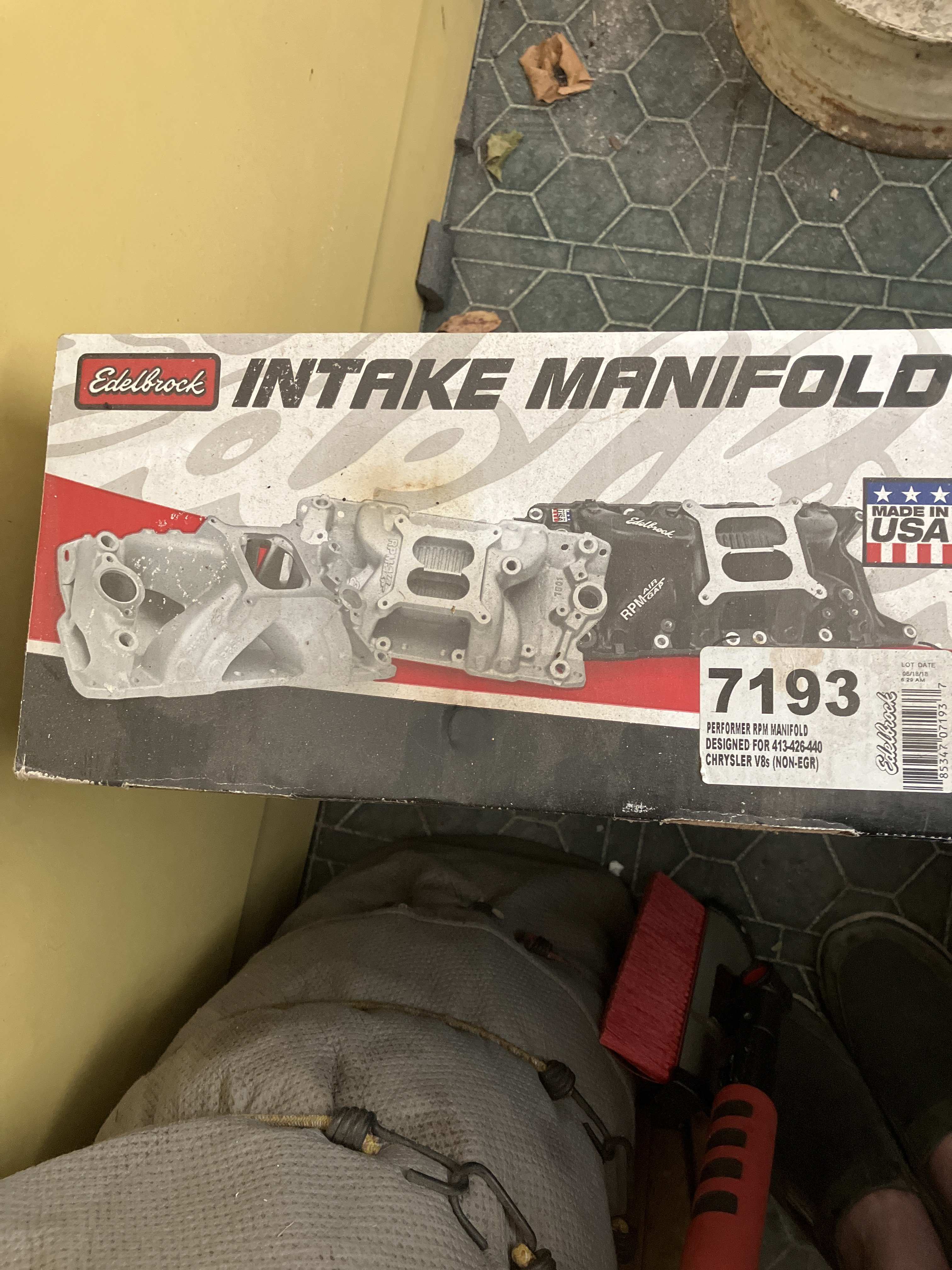

If you change your mind, I’ve got a brand new Edelbrock intake manifold I’ll turn loose $400, plus shipping.
