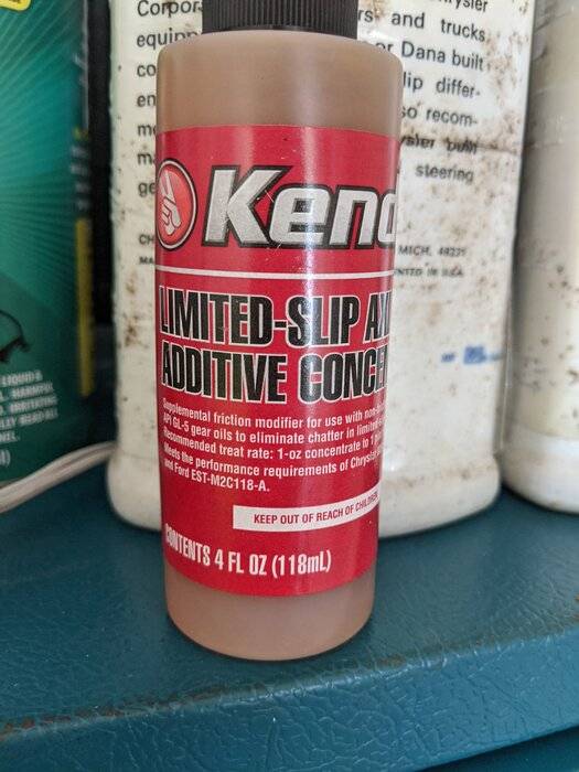

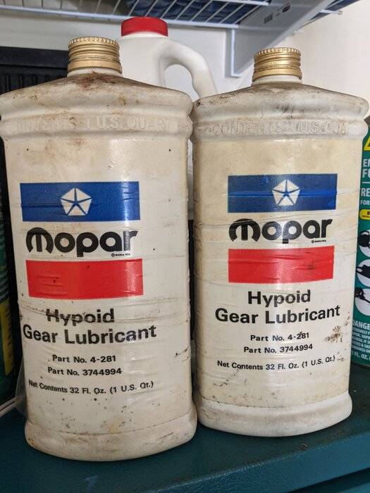

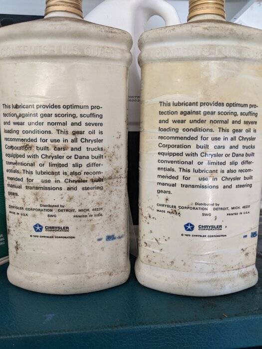

i was skeptical from the start about using the synthetic. the old man had some original mopar brand oil in the garage (pictures attached) so he handed me over 2 quarts to try. the label reads as if it already is pre-mixed for limited slip although it doesn't designate a specific oil weight/viscosity. regardless, i pumped all the gear oil i could out (~2 quarts) and then poured in this original mopar oil. i also poured in a single 4oz bottle of Kendall Limited Slip Additive. took her out for a test drive and put about 15-20 miles on it. was silent and normal even after driving up in the 55-60mph range periodically. eventually though, after cruising @ 60mph for 2+ miles, the first several turns the noise returned. but then it oddly seemed to go away after driving through the neighborhood with sharp turns (it had never gone away before unless cooling down). i took another spin around and repeated the same path only for it to behave the same (first several turns she was noisy but seemed to go away after a couple minutes of sharp neighborhood turns).
so in summary... it seems, better? but not perfect. i let her cool down (still breaking in the rebuilt diff) so i plan to take her back out and repeat again with hopes of an improved result.
a few of the other options i'm thinking...
1 --- since she seems to be getting better, could any of it be related to the simple fact that the diff is still being broke-in since the rebuild? she's only got 140ish miles on it since re-installing
2 --- this mopar oil seems to be pre-mixed with limited slip additive. i put in a 4oz bottle of additional additive regardless. should i put in a 2nd 4oz bottle of additional additive? will it hurt? how many bottles (or ounces) of limited slip additive do y'all typically put in?
