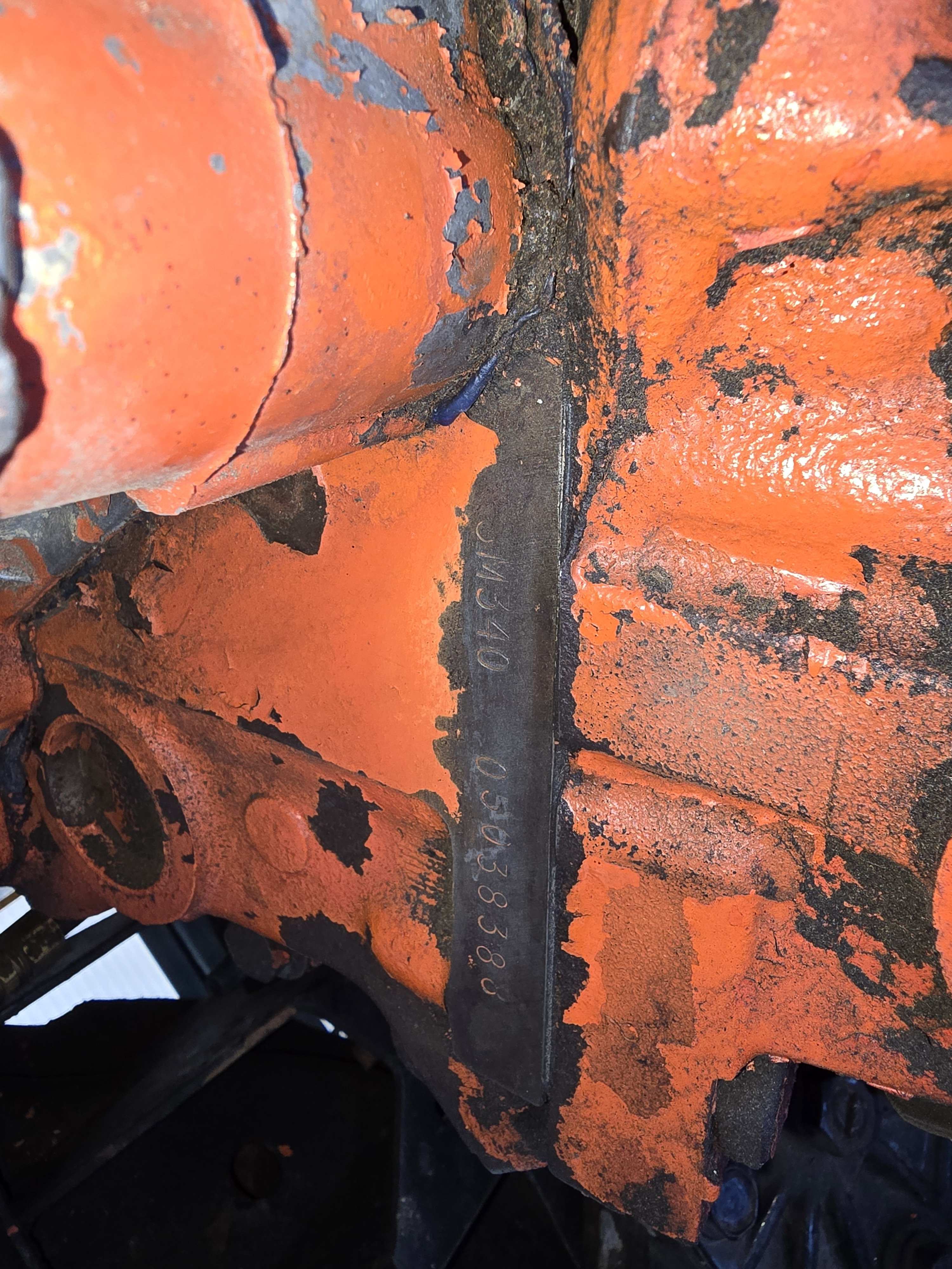

Non T/A block 68-73,2780930-340.
The casting date is above or below the casting number on the side of the block, which is at the back side of the block. Secondary codes are also on the block at the front drivers side below the head. You will find a number like this:
F340P0018 10 16.
