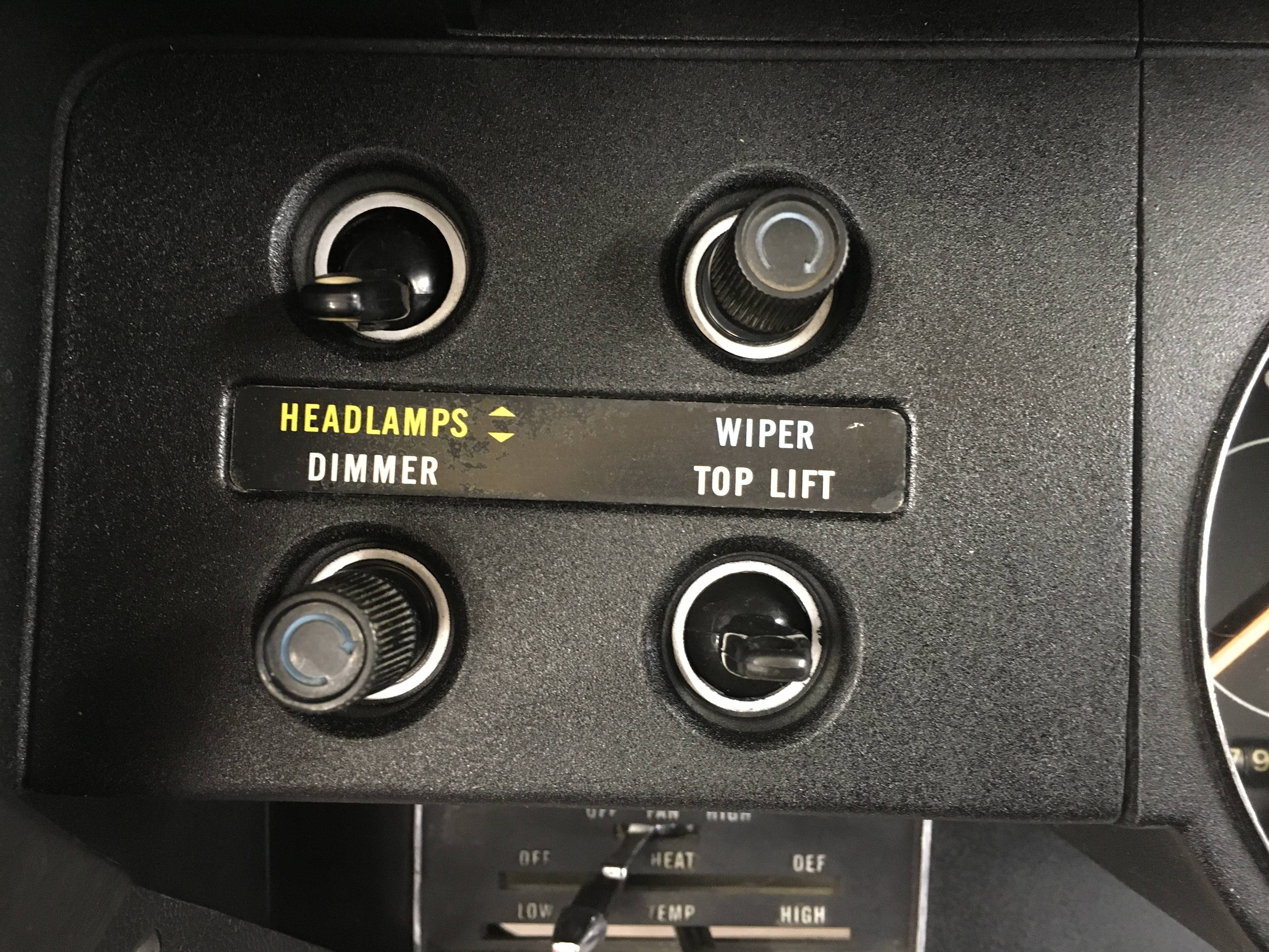

Finoke....Your panel looks good! Looks like proper texture and color. How has it held up over time?

I just restored this one but I’ve used the product before and it holds up well. Just remember as with any spray paint it will show any imperfection under it. So either totally remove the old coating or sand and feather well. No primer is needed.

Thanks @heminut , I liked the wrinkle part of the finish, but I did not like its sheen, its slight reflectivity, and or it's semi-gloss-ness. I'm not sure how to describe it.
Even @Finoke picture in post #8, the texture looks great, but the paint is slightly more reflective than the more matte-looking finish I see on NOS original parts. But the reflectivity I see in his photo may be a flash or lighting artifact.
