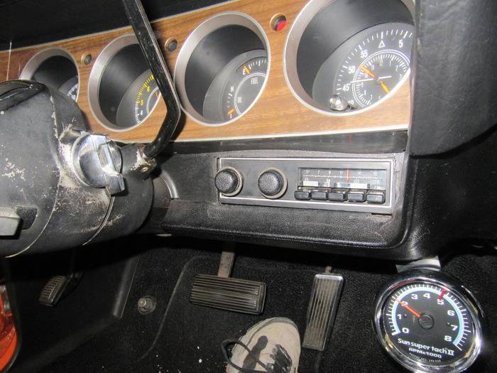

When I bought my '73 Challenger, it came with a butt-ugly aftermarket stereo. The guy had even cut holes in the rear interior panels for speakers! First thing I did was rip those panels out and replace. Finally, after much searching, I found an e-body AM/FM radio on E-bay. My question is, what is supposed to support the radio under the dash? There's a bracket hanging down, not sure if it was bent out of the way when they put the aftermarket unit in, and it sort of lines up with the nut on the right upper side of the OEM unit. Still, after attaching the existing bracket, there's way to much play in the radio with it in the dash. Is there something else that should be there? Also, I found the old power connector up in the dash and connected that up to the "new" radio. What serves as a ground? The aforementioned bracket? The antenna? I assume the display should be backlit when power is supplied to the unit? Thanks for your help!

Figured it out! Two additional screws in the bottom of the radio, toward the front, and going up through the steel bar which supports the front of the unit. The old power connector was still getting power, and all the speakers work! And looks SOOOOO much better!
