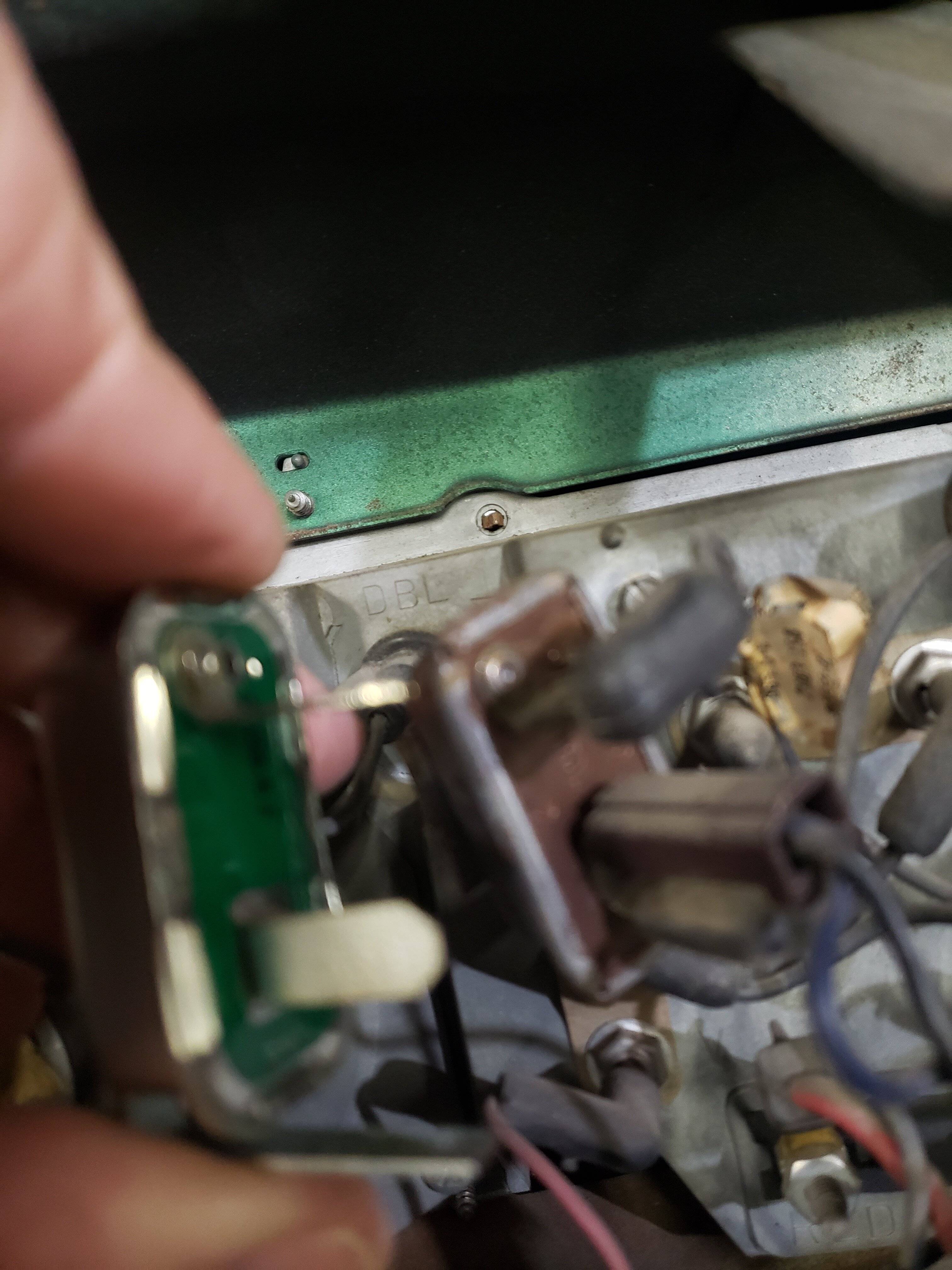

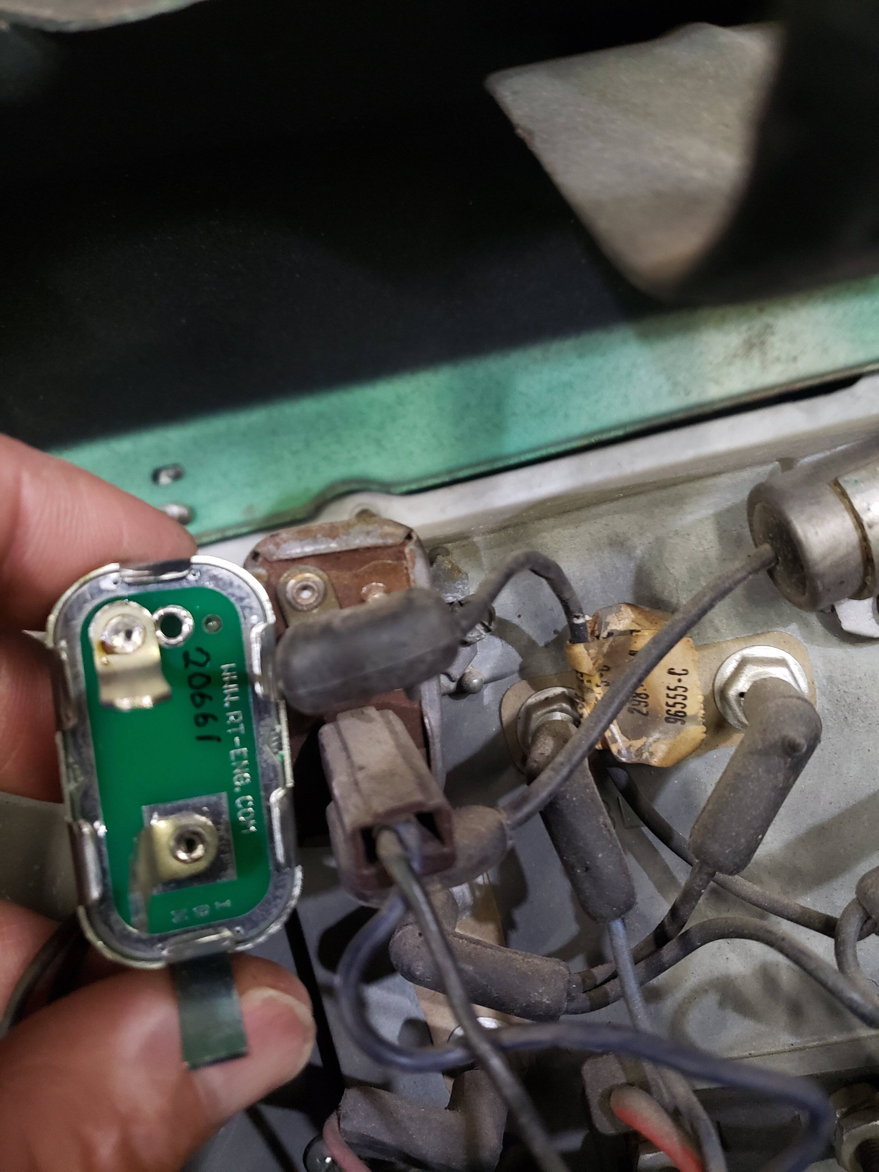

Has anyone replaced there voltage limiter with a upgraded rt one,which plug in goes where,the original has 3 plugs the new has 2

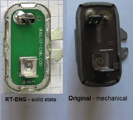

It looks RT-Eng changed their design from when I put mine in, or you have the wrong one. The top post should be female, you need IVR3, yours looks the B body IVR4 one. If you insist on using it I'd guess the top is 5v output and the bottom is the 12v and leaving the condenser disconnected. I think B bodies have their condenser located somewhere different.
Thanks,we wondered why it didn't have the back mounting bracket,and the double plug,makes sense now
