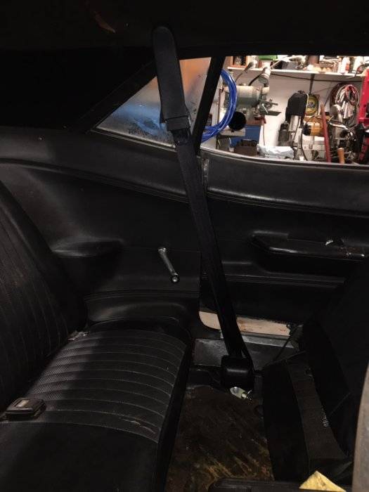

Favor gzig5? Photo?
gzig5
May 10, 2018
408
135
Mequon, WI
Here you go. Lighting not that good, interior is a mess. You want the dropped upper mount so the belt doesn't come across your neck and the long buckle part to reach around the seat, as well as the mounting HW kits for each. I used the factory mounted holes and re-tapped them to clean the rust but the HW kit has enough parts to do it from scratch. Note that my buckles are mounted backwards for now. The plastic is preformed in a flat S shape and I didn't think it worked right around the console so I did it backwards. Others got it to work with the console, I just haven't revisited it.

Thanks for the photos and again for the link gzig5. Precisely what I am looking for.

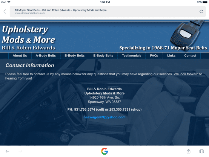

Wedg2go........not all gear heads want to remain with the factory, even the 3-point ‘74 integrated ones. I’m happy with them myself. When I was using the car as a daily, and in the LA grind, they secured me well. However I heard from others that either use this type or own ‘74 E-bodies, they don’t like how the shoulder strap comes down across the body. Maybe that has to do with body mass. They are not easy these days to find a decent set $$, but I like that they’re factory and we’re made for the car and they are a 3-point restraint. Maybe Bill Edwards can help you out, give him a call he’s knowledgeable and a heck of a nice guy. Here’s his website.

The dropped support on the upper belt mount of the Wesco belt takes care of the issue with the strap coming across the body incorrectly compared to the old OEM ones. I doubt you are going to find any viable E-body cars in a junk yard these days. The OEM belts come up on sale sites, but you better be ready to open your wallet. Depends on where your priorities are. I'm happy with an affordable solution that isn't dry rotted, looks nice, and performs.
