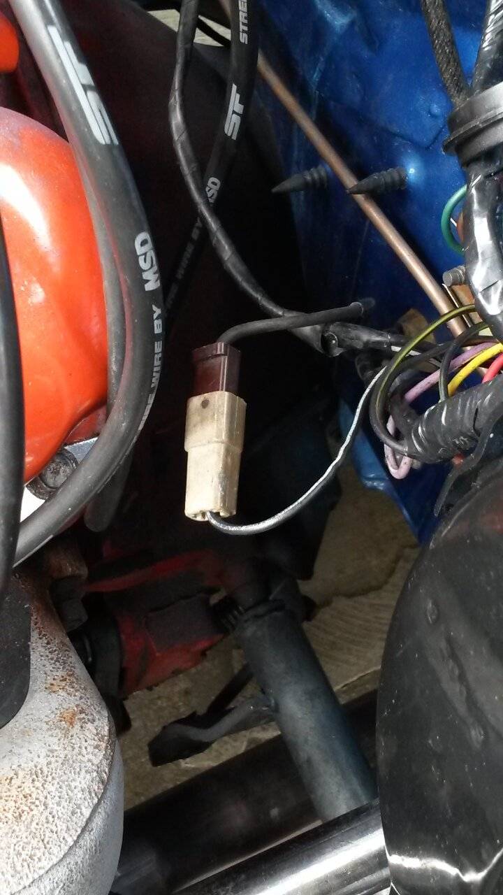

Unplug single connection that comes out of firewall .see if it goes out. As
70chall440 said I think it's a bum switch.​
Thanks I disconnected the wire and it went out. Then I pulled the switch and the detent ball was stuck all the way in so much for new and simple. Thanks for the thread return
