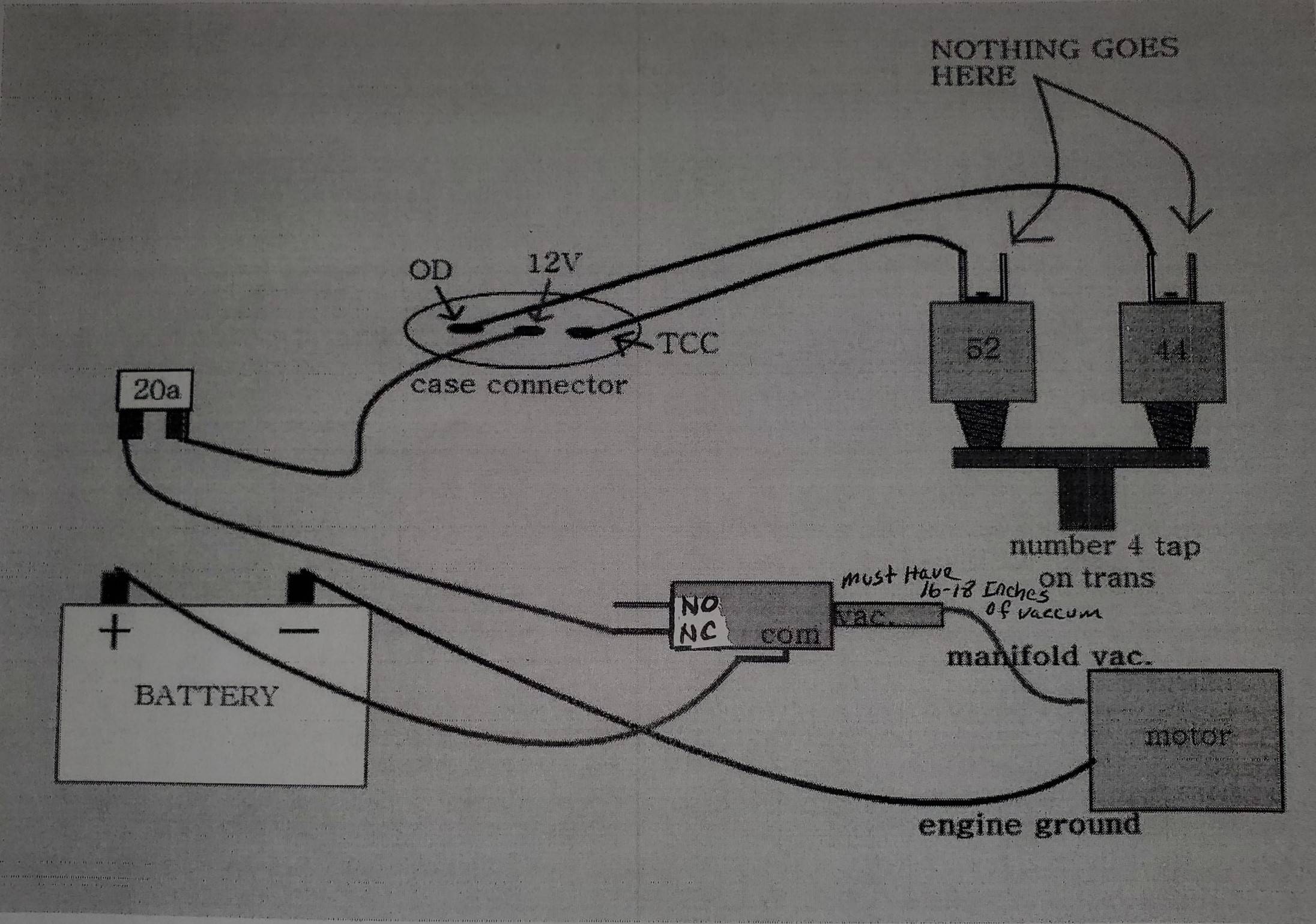

Well, I took the plunge and went with a 518. Went with Monster transmissions. I get a fresh trans and an included fresh converter. There’s a modification sold through PACT that makes the converter lockup as well as OD automatic. It’s a preset system for either 48mph or 52mph. Since the surface streets are 45mph I decided to go with 52mph.
